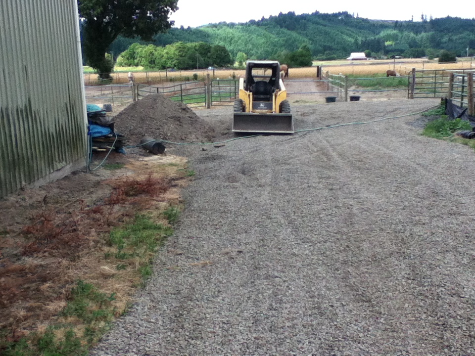

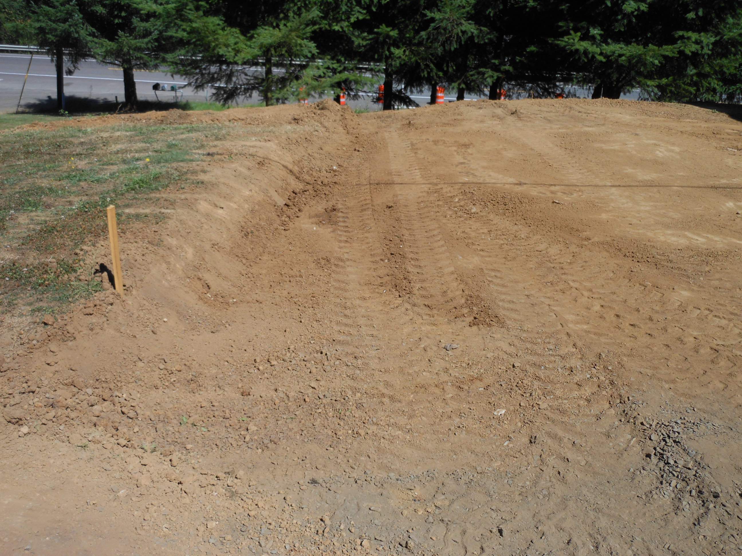

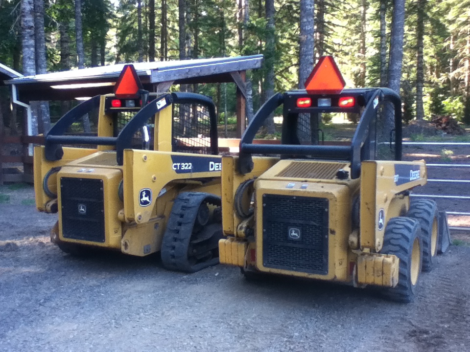

I also vote for a skid steer. I have a Deere 317 skid steer and it weighs over 6500 lbs. I have done a lot of both heavy dirt work, stump removal, moving logs, precision grading, and numerous other things with my skid steer. All of that weight on 10" wide tires really compact the ground when you want it too. Also, a tracked machine of the same size also will do an excellent job in precision grading and compacting, plus if you tread across a lawn it wont be as aggressive as a tire machine unless you make sharp turns. Skid steers are extremely versatile, they have excellent lift capacity for their size and the forward use of almost every attachment makes the experience that much more comfortable. Deere's 300 series machines have great visibility, the only time I have had troubles was when loading a pallet of materials into a pickup truck which is where you cannot see the bottom of your load without leaning forward a ways. Visibility all around is great, being able to see the edge of your bucket flat on the ground is very helpful when operating in tight quarters. Plus if you get in a bind you can always spin your machine around, try doing that on a compact tractor. On top of it, you get a commercial machine designed for use and abuse that can take many more rental implements than a compact tractor usually. Just a few things to think about, my 317 has 61 hp and was actually less expensive than buying a newer 20 hp compact tractor with a hydrostatic tranny here.
View attachment 289995 View attachment 289996 View attachment 289997
I can't argue with much of what you say, except that the tracked machine will provide much compaction. Also, a lot of tractors come with SSQA, so a lot of those attachments you can rent fit as well. I'd be shy renting attachments that require hydraulic power because you never know who used it last and what's in the residual oil.

The whole purpose of a tracked machine is to spread out the weight over a larger area. Don't think it will provide enough compaction for a concrete slab.
