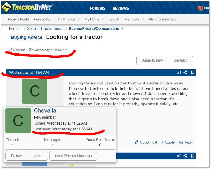

Looking for a good used tractor to mow 40 acres once a week. I'm new to tractors so help help help. I hear I need a diesel, four wheel drive front end loader and mower. I don't need something that is going to break down and I also need a tractor 101 education so I can care for it properly, operate it safely, etc.

I do not see a single post since the first from the OP. Until he clarifies his circumstance all 34 posts above are wasted and mostly irrelevant. Mine included.
He just started the thread day before yesterday... do we all have so little to do that we jump in with over 30 posts before the OP ever clarifies?
