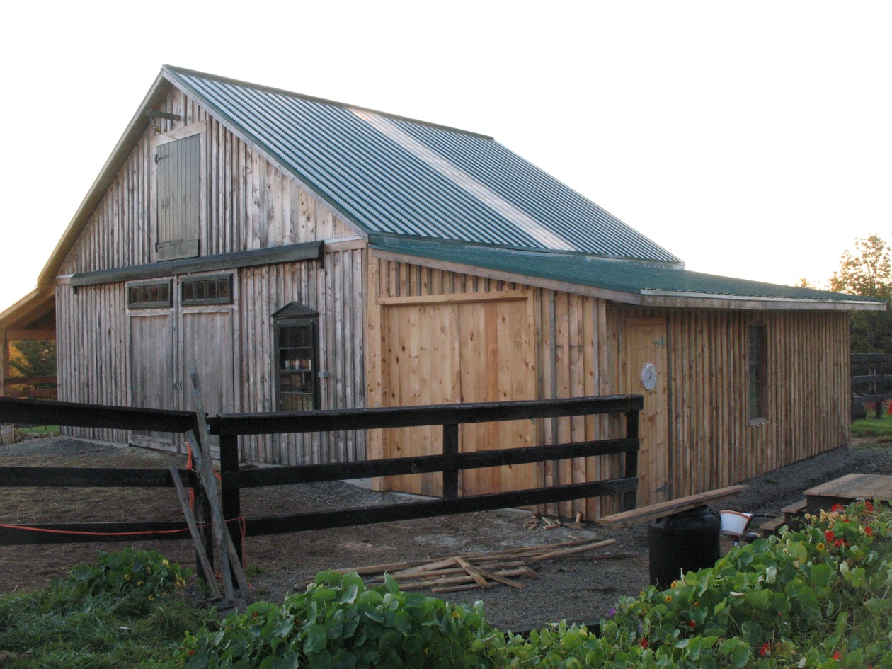

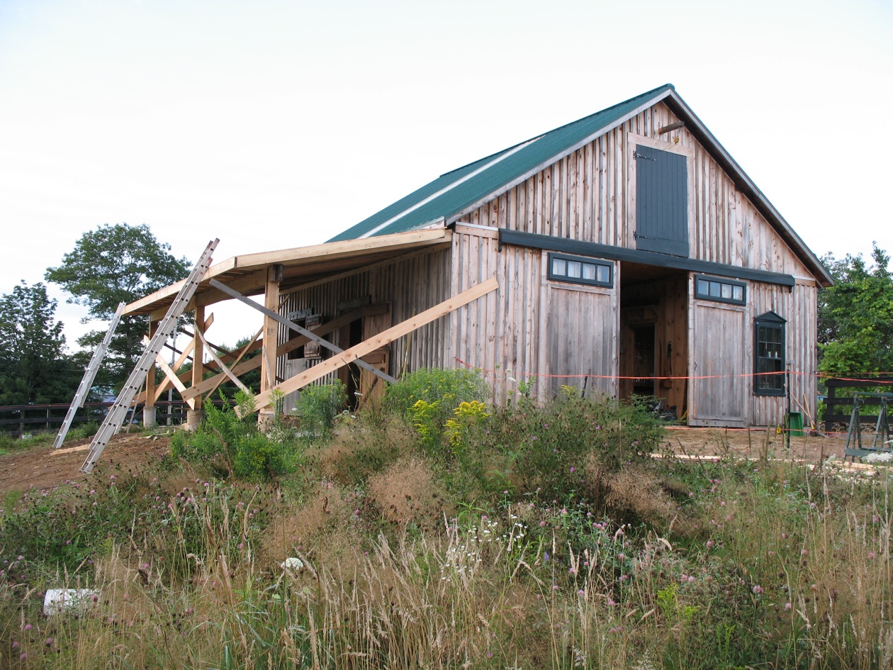

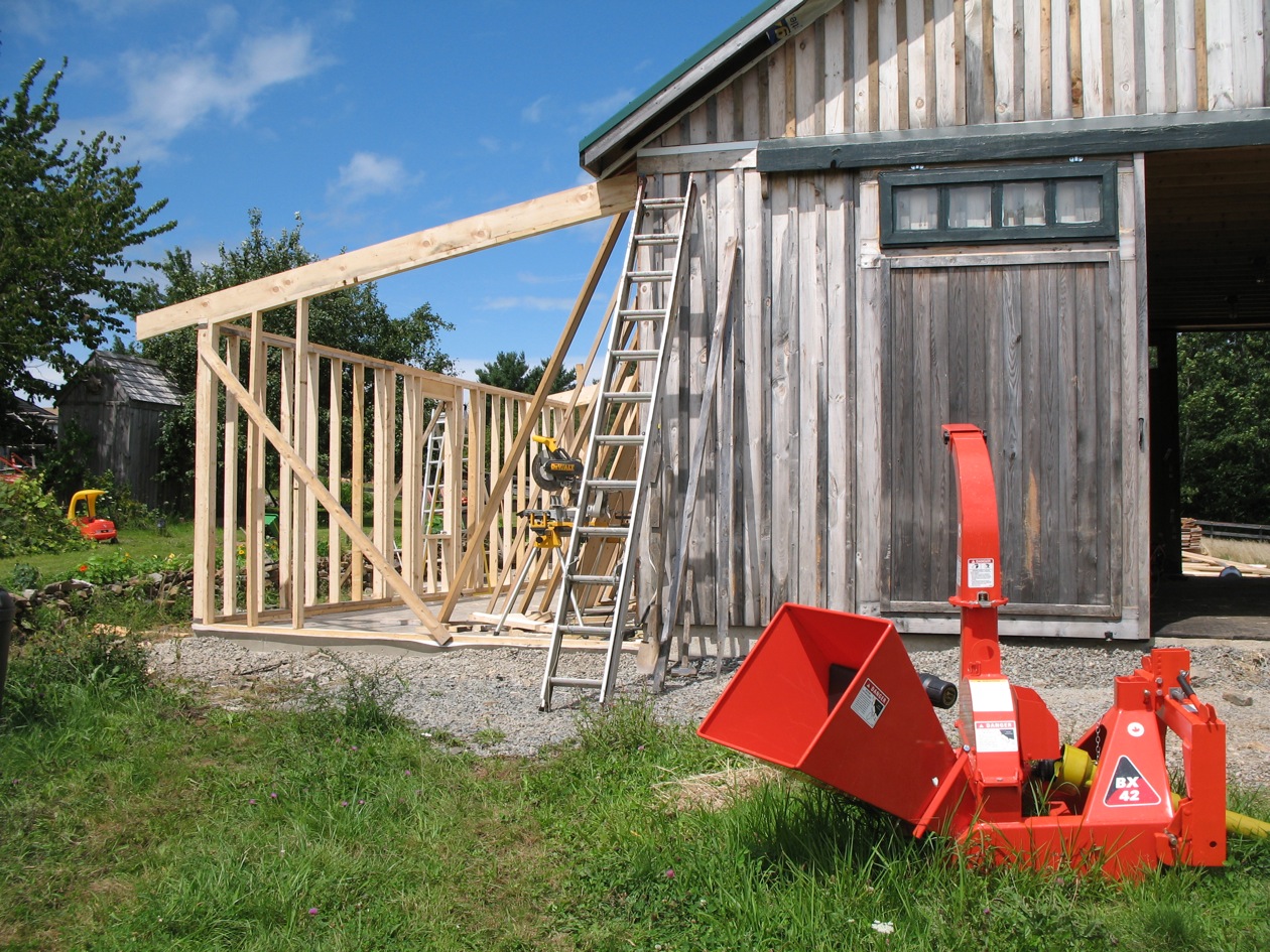

When I built my sliding doors for my barn I used 2x6. The doors(2) cover a 10'x10' opening with an overlap at the edge (barn) of about three inches. I bought a 36" wide by 12' roll of rubber floor runner and cut into 4" strips. I nailed the strips in place with roofing nails - every 4" - around the door (sides and top) openings. When the doors are closed the strips act as a seal. I also built a channel of wood on one door. When the doors are closed the edge of the 2x6(door) slides into the channel.
I also built the windows for the doors as well. The panel in the door is T&G. There is a frame on both sides of the door holding the panel in place.
Hopes this helps.
Lloyd

   / Looking for advice on building barn doors #24
The windows on the doors make them look really sharp. Not just a plain door. Good example of another option.
   / Looking for advice on building barn doors #25
The windows actually let in a lot of light.
Here is a shot with the doors closed and a later addition for the tractor. There are a few more battens to go on the barn.
Lloyd

   / Looking for advice on building barn doors #30
jcaron2,
See my photos. You can built a reflector over the track.
This will divert rain, keep the track clean and free and prevent rust.
I usually oil/grease my track once a year.
Under the green wood reflector I flashed with aluminum. I ran a bead of good quality caulking on the wood flashing before attaching.
Once the wood reflector was in place I also ran a bead where it joined the building and painted it. We get a lot of rain and it does not leak at all.
lloyd
