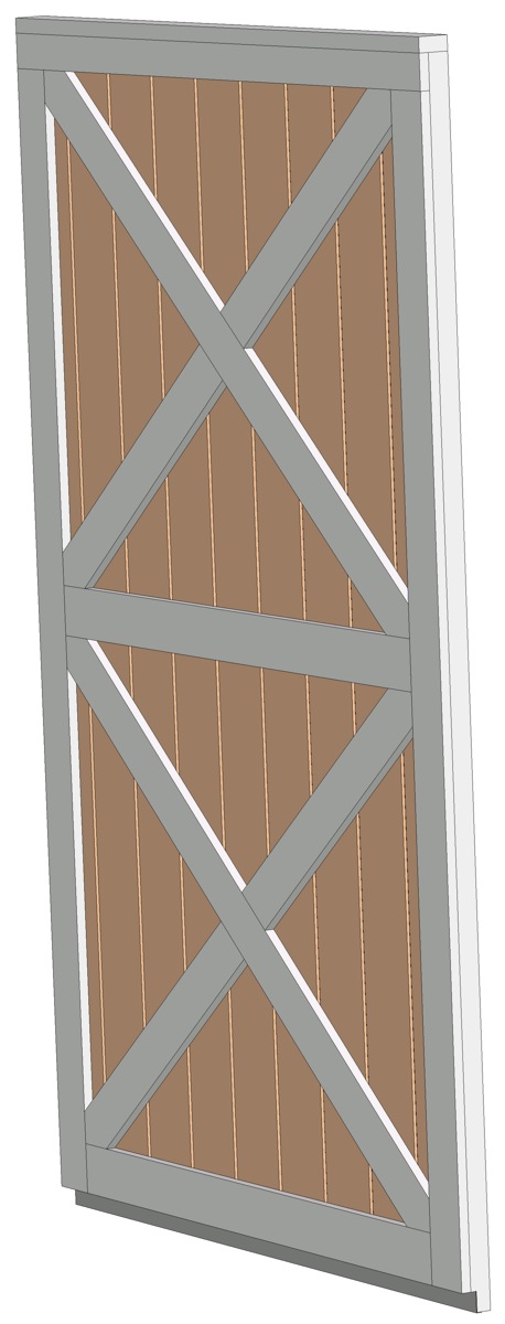

I would guess that it is a priority to get your barn doors up, and you may not have the time to shop for a welder and all that to build metal frames.
These shed doors have a 1/2 sheet of plywood back over which T1-11 siding was glued and screwed, and then they have a face frame of 1x4x1 rough sawn oak that was glued and then well caulked. The face frame is not just decorative. It adds strength to the door frames.
In your application, you would typically paint the T1-11 to match the rest of the buildling, and then paint the face trim to match your roof. Typically, you'd only do one X per door instead of top and bottom x's.
It is important to have a good drip edge protecting the top of the doors.

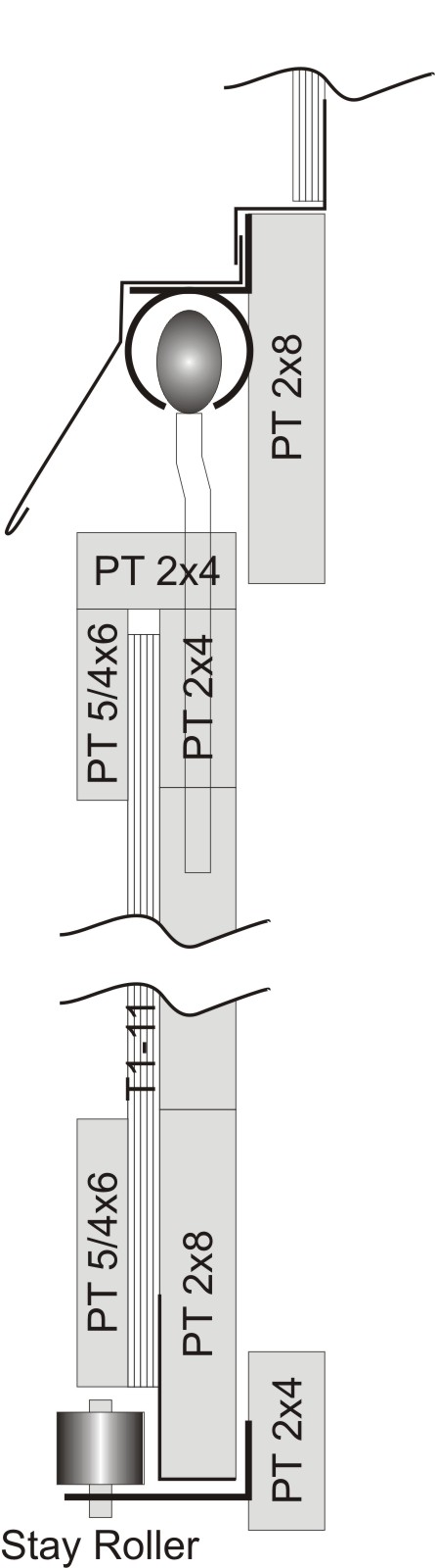

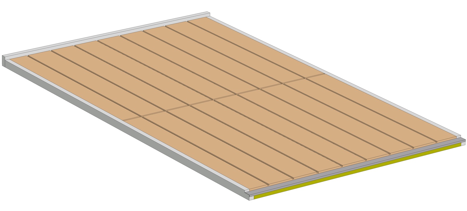

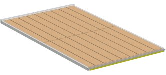

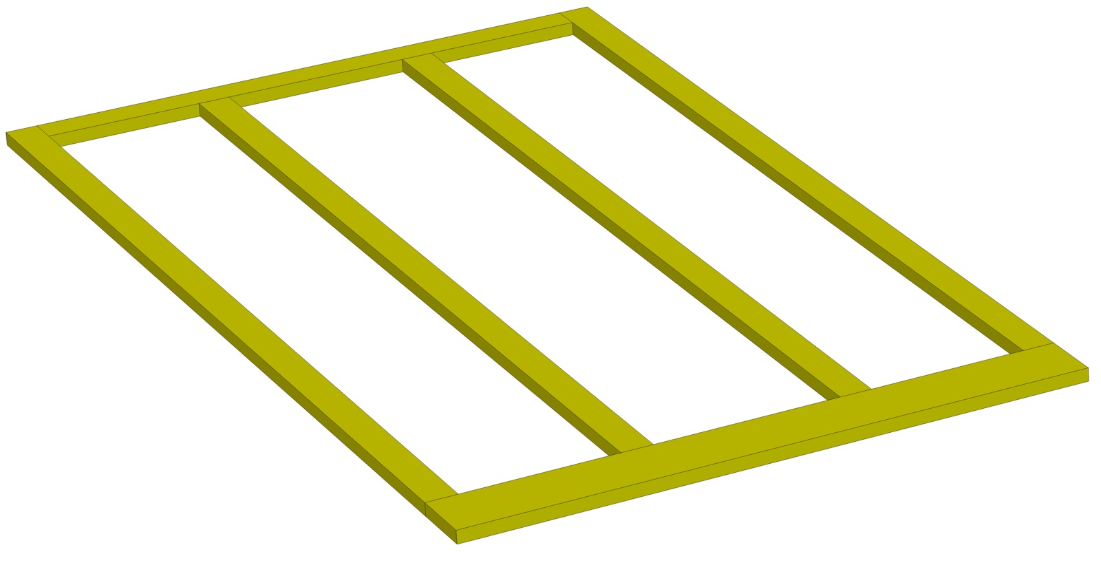

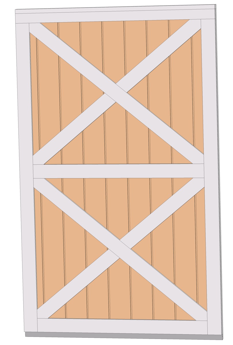

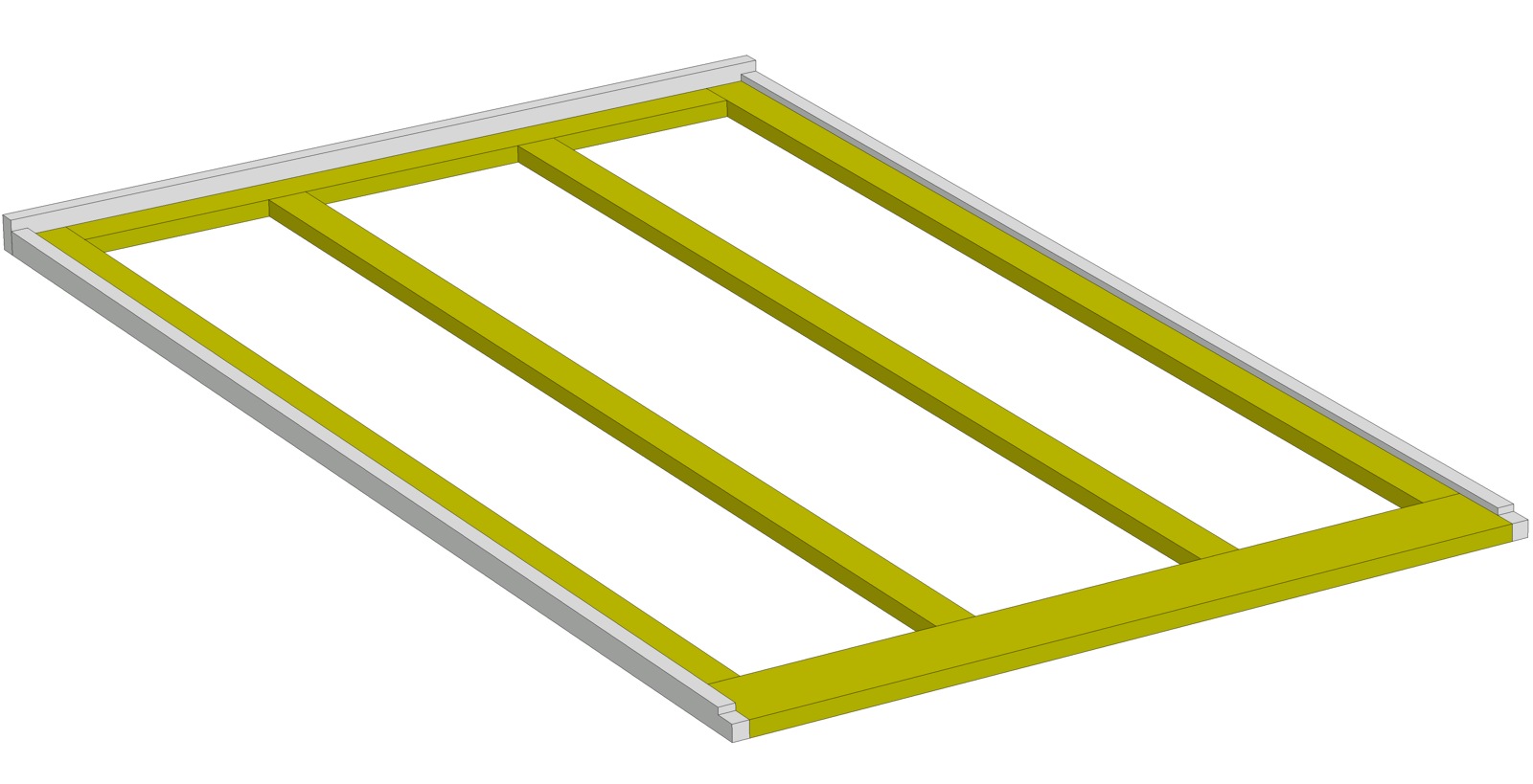

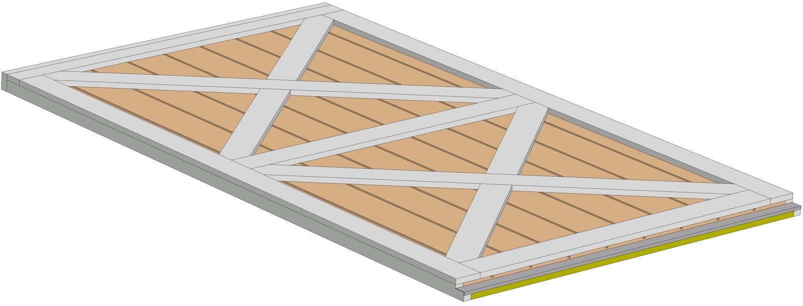

After carefully considering all the info I've received here, along with other stuff I've read elsewhere, I think I have a design in mind. If anybody sees any major issues, please let me know. See the drawings below.
I'll start with a basic frame consisting of PT 2x4's on the flat (shown in green in the drawings below), with a 2x8 at the bottom (for the catch roller - see the side view drawing). Around the top and sides I'll put PT 2x4's on edge (shown in white), but they'll be ripped down somewhat narrower than the nominal 3.5". The one across the top will be 3.125"; the ones on the side will be 2.125". In the "cavity" formed by the thicker frame, I'll put 5/8" T1-11 (shown in beige). Together with the 1.5" frame upon which it sits, that will make the thickness 2.125", thus matching the rails on the sides. Finally, on top of the T1-11, I'll make my crossbucks out of PT 5/4x6 (nominally 1" thick) planks (probably ripped and jointed down to 5" wide to remove the standard radiused edge so I can get a tight fit between them). The crossbuck frame will go over the side rails, but will but up to (and be even with) the top rail. I decided to do the top this way so it would be one continuous piece to discourage water from seeping down into it.
I haven't finallized the design for the dutch doors yet. Those will probably have T&G 2x6's on the inside to match the interiors of the stalls and to provide a solid backstop for the T1-11 (in case of an errant kick by a horse).

That looks like a good, solid design. Use construction adhesive to hold everything together, along with conventional fastenings.

Rabbet = lap joint. Ply, whether on one side (slider), or both (Dutch) is simply screwed to face(s) of frame. Has lasted 20+ years, but when I re-do, I will modify top Dutch doors to accept a cap. They are on gable end and are weathering.
No PT anywhere horses can acess. Poisonous if they crib.
