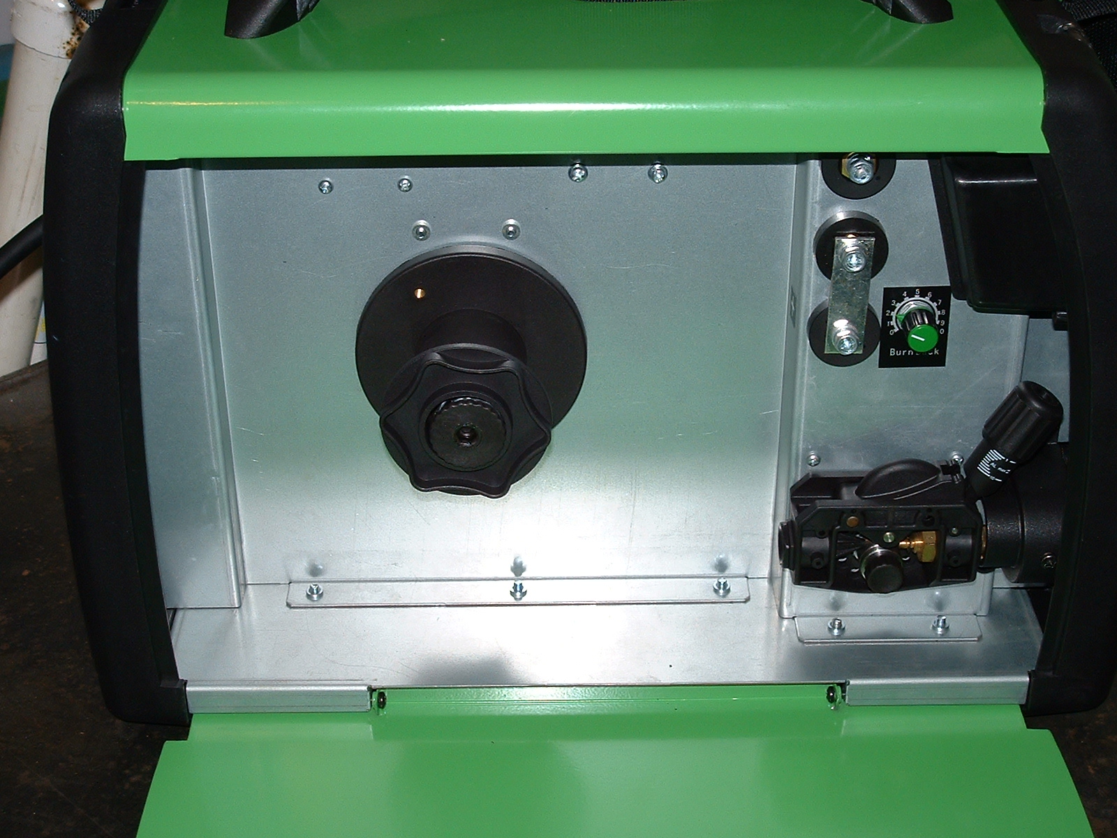

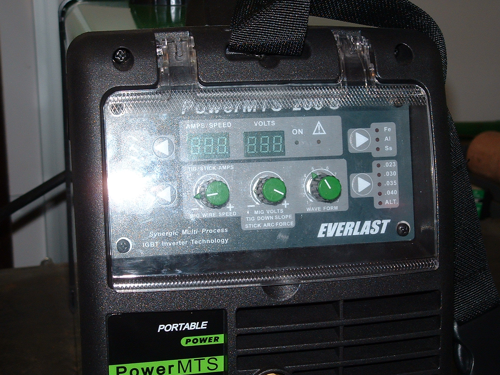

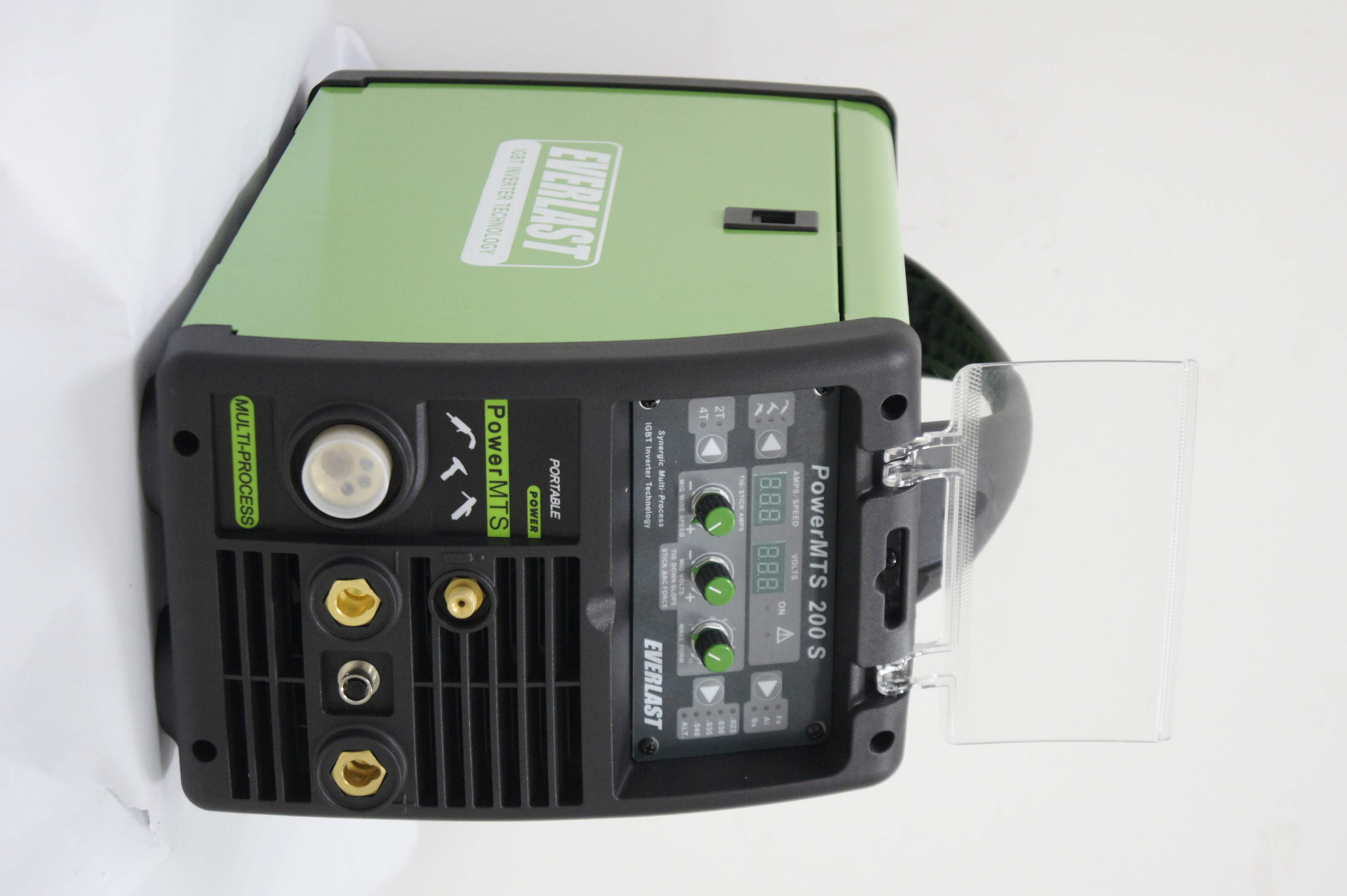

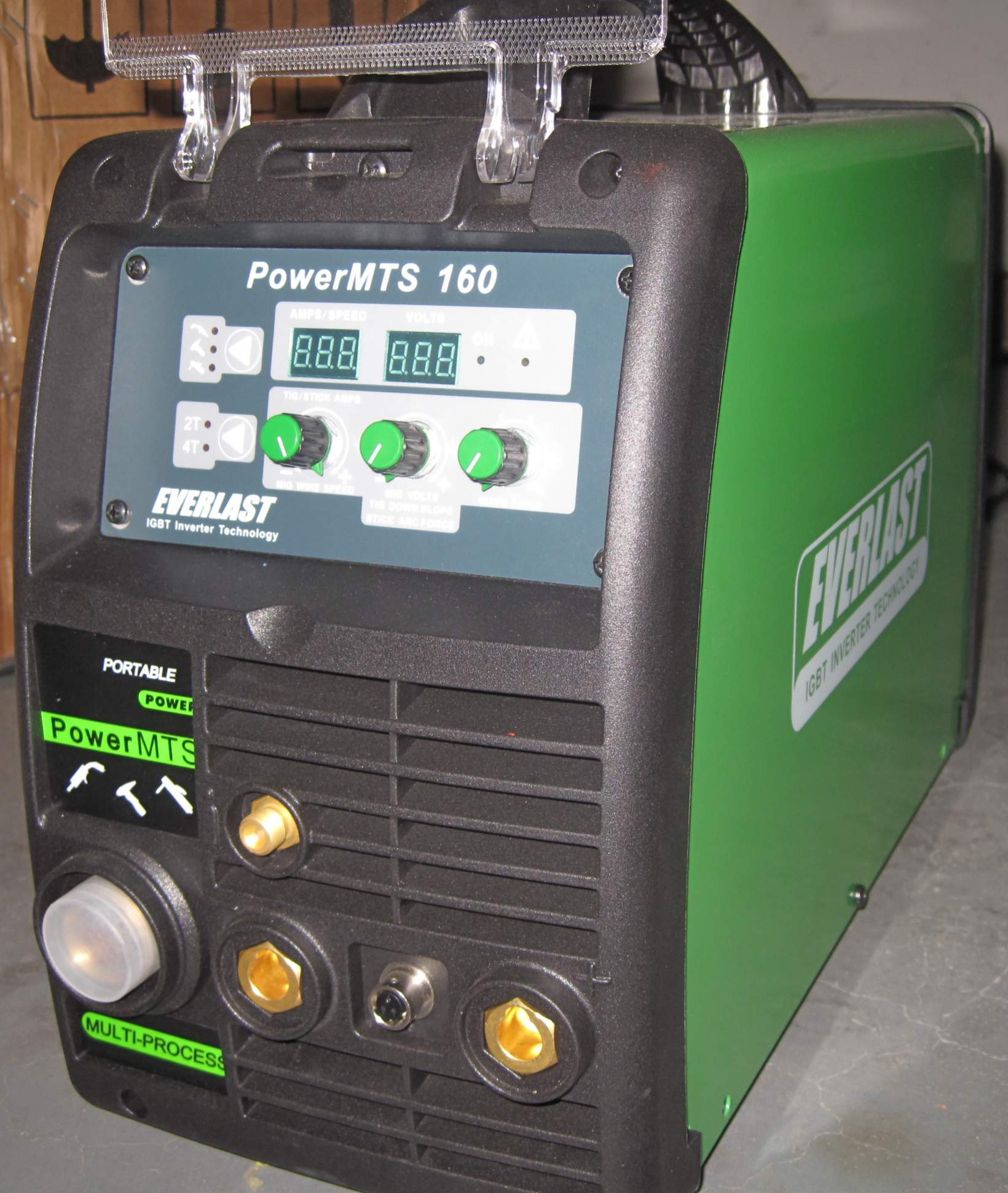

Umm,
Yomax,
Our MTS 160 and 200S is a good competitor to your 3n1, and we had it in the US a year before yours.lol...
Look familiar? Not so unique as TA makes out!
