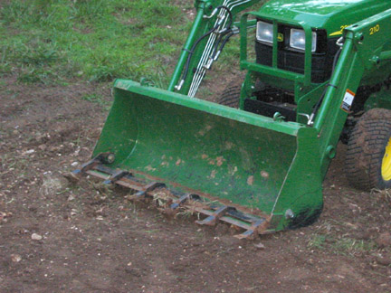

I'm thinking I'd like to ad some bolt-on bucket teeth to the Bush Hog FEL on my Kubota B8200. Bolt-on since I want to remove them for scraping, snow removal, etc., and since I want to minimize weight, this being a small set-up to begin with (48" bucket, rated at 670 lbs lift capacity). I haven't been able to find any teeth other than larger ones which would be more appropriate for a bigger FEL than mine. Anybody know where to look?? /forums/images/graemlins/confused.gif
   / looking for bucket teeth #2
I just bought a set of woods teeth for the 2210 with a 49" bucket. They work great. Sadly, the only place I could find to get them was through the dealer. A call to your dealer should set you up. I paid $256.

Varmint,
Do a search for "Toothbar" here and you'll find more than you ever wanted to know about availability of something like this for your loader bucket. /forums/images/graemlins/smile.gif
   / looking for bucket teeth #4
You'd be farther ahead to make/buy a toothbar. Teeth are good for some operations and get in the way for others. I made a bar that attaches with two bolts, and it's simple to get on and off with a couple wrenches I keep in the mini-toolbox under the seat. Do the search Gary recommended. There is a ton of info out there.........................chim
   / looking for bucket teeth #5
I made my own toothbar for my Kubota B6100 for pretty much the same reason - commercial toothbars have teeth that are just too big in proportion to my bucket.
The story of my toothbar is in This Thread (includes pictures)
The toothbar has worked well for me for going on 2 years now.
