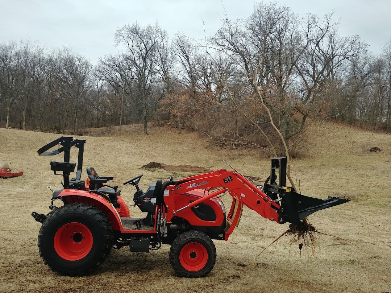

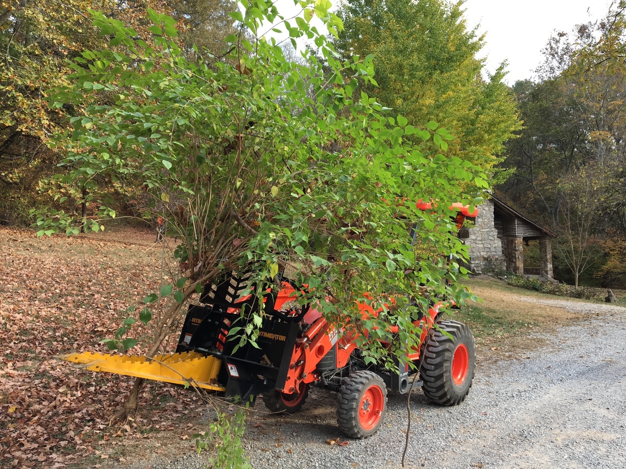

I had thought about suggesting using a chain to pull some trees just to assess how stubborn they will be to remove, but the OP bought a nice cab tractor. My experience using a chain is that the tree invariably seems to hit the back of the tractor and me in the back. I have an open station, but would imagine that the back window on a cab would get broken using a chain pretty quickly.
One good thing about your danuser is that guard that helps to protect your tractor hood, and having it on the FEL also puts more distance from the operator's station. Not all of the tree pullers have quards on them.
   / Combo stump bucket and tree puller? #14
The guard does keep trees from tipping back onto the hood. One of the neighbors doesn't have that, and one of his complaints was that the branches could tip back into the cab of his skid steer. The grill guard on the front is just treated deck boards. I later added something similar for underneath to protect the wiring and hoses.

I ended up getting a stinger stp-34 tree puller for clearing prickly ash, buckthorn, honeysuckle, mulberry - invasive brush that had taken over the woodlots and fencerows. It does a real good job at that, and I was able to clear large swaths of 2-3" or less. I would pull an area, then come back with the grapple and gather into piles to burn later. The neighbors of course noticed what was going on, and by the next year I see at least two acquired their own and started clearing their places. The one I got supposedly has blades and barbs on the front for digging, as in digging roots and stumps, but I wouldn't recommend using it for that with a FEL. You could, but it's not the right combination, not very effective, leaves a mess of tangled broken roots sticking up, too easy to screw up doing it wrong. If it's that hard to remove, just cut it off at the ground and leave it. Even if you put it on a skid steer, which could handle that type of work better, I'm not sure I would because of the mess it leaves behind. Better to cut it off flush, and let the stump rot away until a nudge with a bucket or pinch with the grapple can push it up and out.
Looks like a good device, but not crazy about the exposed cylinder.
Saw this one by Notch -> Notch Manufacturing Inc. that I like the looks of.
The Danuser device just seems rather difficult to buy. Their dealer network leaves a lot to be desired, IMHO. Probably just as well, as the price is a bit steep anyway.
