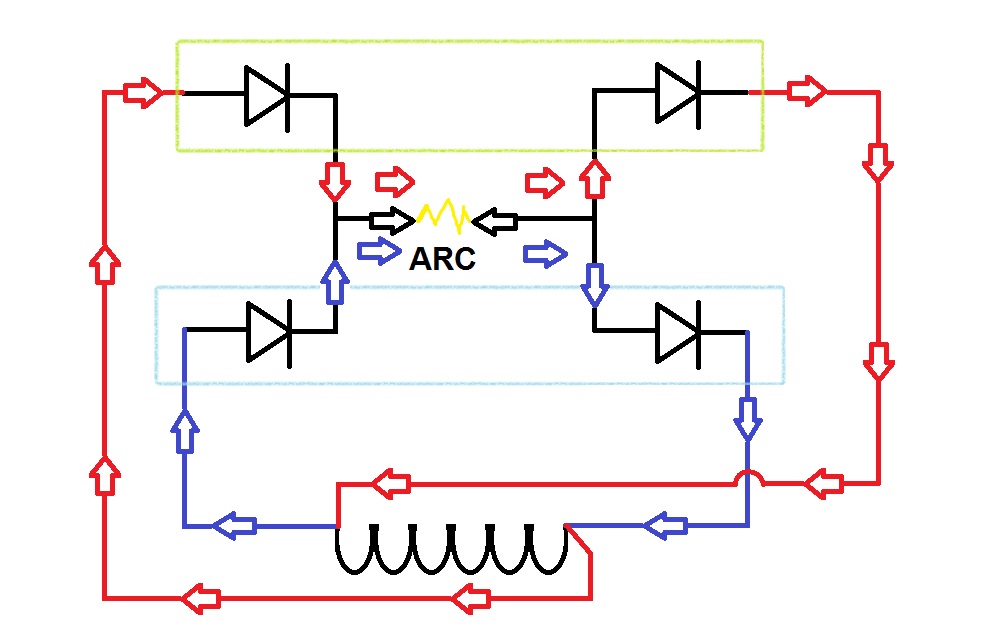

Will someone please tell me if this diodle will work in my welder if if buy four of them? I keep calling century but, they keep trying to sell me something else besides a diode, or keeps telling to call back tomorrow.
Thanks samshine

Thanks everyone for helping me. After reading everyones post. I know i should change every diode so there want be a weak link. But before i buy all four. I wanted to buy one the same size, to make sure nothing else was wrong.
If anybody got a manual of this welder, Montgomery Ward powr kraft 250 amp. ac/dc welder? I need to find the voltage of these diodes. I want to thank all that helped me. Thanks samshine

If the original diodes are 250 amp 300V diodes, then ANY 250+A diode with a PIV rating of 300V or greater will work.
This diode on Ebay would be a perfect replacement. Now, what we are trying to determine by asking you about schematics is whether you need 4 identical diodes or 2 diodes with anode to case and 2 with cathode to case.
My guess is that if the rep only gave you one part number, then all 4 are probably the same, but if you can help Transit complete the schematic, we can be sure.

Youve just made a case for the forward biased diodes being in series. We agree... It is the reverse biased diodes that are at issue. If their PIV is exceeded they break over and become a brief load on the transformer until they are toast. Since they are in parallel the PIVs do not add.
larry
Ah, but you have to remember that we are dealing with 2 parallel strings each with 2 diodes that are in series with the arc between them. (The two parallel strings just happen to be connected to separate transformer legs.)
If the forward diodes are in series then the reverse-biased diodes are also in series. Take a look at the attached schematic for a better view.
Colored lines and arrows indicate current flow during each transformer phase. (I.e. Blue lines, left side of transformer is - right is +. Red line, Left is + Right is -.)
You can see that at any point in time the diodes in the green box will always be in series and the diodes in the turquoise box will also always be in series.
