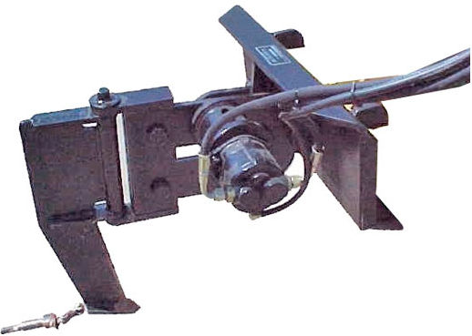

I would think one could run a few dry passes until one obtained the depth one needed and then pull in or feed in the wire at that time,
I have a lot larger tractor and with out hydrostatic and vibration I do not think I could go down 24" in one pass,
even the large cable plows usually have vibration on them, or Vibratory Plow.
I made one once for a lawn tractor and use a little gas engine that operated a short PTO shaft and spun two weight (opposes direcitons and timed so the vibration would be up and down) so there would be vibration on the plow shank so I could pull in lawn pipe, worked fairly well but could not cut 3 and 4 inch roots,
I just found a design that uses an eccentric to vibrate the plow insted of weights like many of the commercial units do, Vibratory Plow For Ramrod, Vibratory Plow, Hydraulic Plow, Ditch Witch
pictures below
and I am going to suggest conduit as well,

Seems like the key may be to have a knife edge on the shaft. Subsoilers don't have a knife edge as far as I know and therefore the need for more hp, in my opinion.

on a project like this you do not pull the wires in, you, feed the wires in, the difference is the machine is similar but one pull an done has a tube that guides the wire or what ever in the bottom of the cut trench,
Astec RT1160 Cable Plow Demo - YouTube
   / Looking for DIY Subsoiler to install direct burial 4/0,4/0,2/0,4 URD #14
Kenny d's also was designed to feed the cable rather than pull it.
