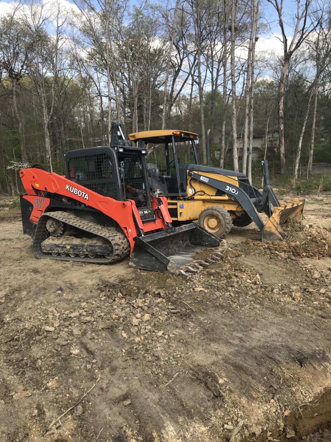

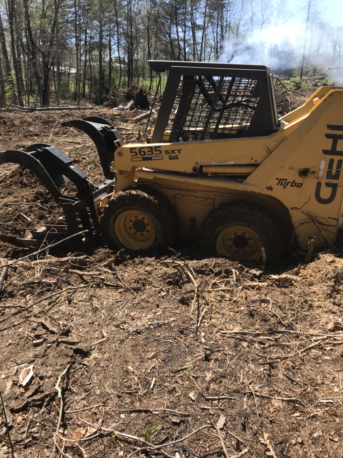

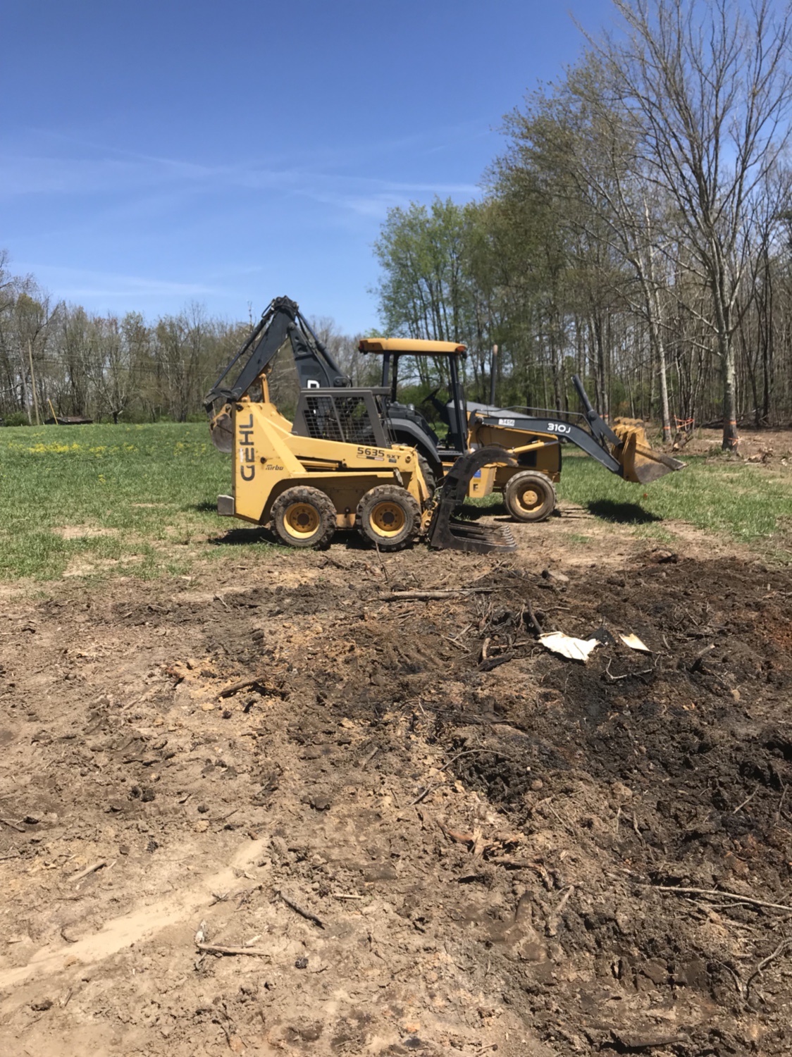

Running a 95 Kubota is a real joy. And it’s definitely a capable machine. Running a wheeled Gehl was a completely different experience. And it’s probably nicer than the bobcat in question. I decided right then after an hours use I’d never own a wheeled skid steer. I’ll never own a foot pedal machine either. I’ll take a wheeled loader any time over that. The wheeled skid beats you to death, tears up everything, is vastly inferior to the tracks for grading work, and gets stuck everywhere. IMG_1999.JPGIMG_1991.JPGIMG_1988.JPG

The bobcat 743 is an old machine my guess from the early 1980's and no comparison to a tracked 95 kubota but also no comparison price wise My place is pretty wet over eight feet of rain per year on clay / mud and yes my machine would get stuck but by using bucket tilt ie tilt bucket forward lower it down until the tooth bar engages then tilt the bucket back I always got out without needing a tow bottom line the 743 would not cut as a commercial working machine and is nowhere as good as a modern tracked machine it is however a useful tool around a hobby farm or building site I loved it

I agree that wheeled skid steers suck. I can drive the 95 Kubota in across turf without hurting it too bad but doing any actual work is out of the question. Even the track impressions are pretty bad. Like as much of a track that my 8 ton TLB leaves. CTL doesn’t mean what you think it does. I’m pretty sure you meant CUT. Even then the 775 is a pretty small machine. It would easily be out worked by a large frame CUT. Skid steers are pretty much only for construction. They’re far to destructive for property maintenance. Not to mention tractors and TLBs move faster, quieter, cheaper, smoother, and kick up less dust.
