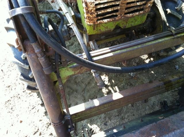

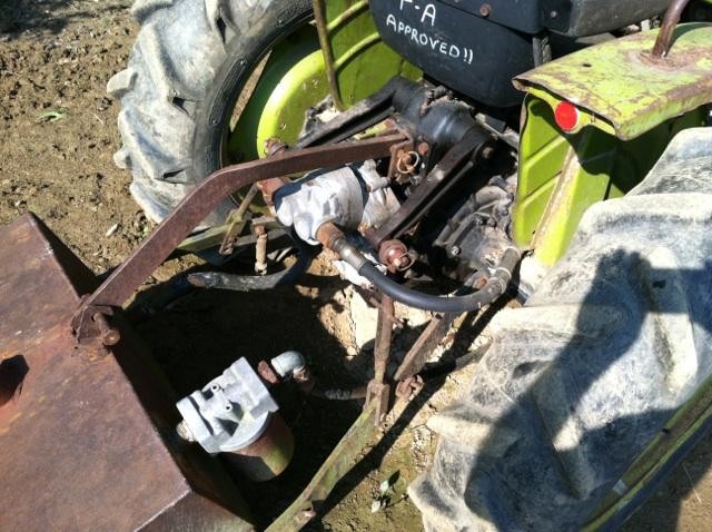

Thanks for pointing that out. This is about 3 hours away and I'm trying to decide if I should go see it. Asking price is $2500. He sent a few more photos. Comments welcome. I'm not sure what to make of this. Thanks.
It looks like this loader runs off the rear PTO. How difficult/expensive would it be to plumb that into the tractor hydraulics? This arrangement has the rear end occupied for loader use. I'd like to put a box blade on the rear and still be able to use the FEL.
Correction- The loader does run off the tractor hydraulics. That contraption on the rear is for an added remote, at least that's what the seller says.
Am I reaching on this one?

I can't give good advice here. The price is cheap for a tractor with loader but no doubt this tractor has been around the block. Just the way I am I would go take a look believing I can fix anything. However, when I got there I might make a u turn and go home.
I notice an unattached quick disconnect up toward the loader in one picture. Wondering if he had a grapple on there at one time.
One thing for sure, the seller is not polishing it up, could be something said for that.

I talked to the seller. Turns out he bought this from a guy who used it for fencing. Said it had a post pounder on the front and that's what the apparatus on the rear pro is for- running the front aux hydraulics. He doesn't use that but left it on the rear for weight. Post-pounding with the front sounds like it could be hard on a tractor- at least where I am- stones everywhere.

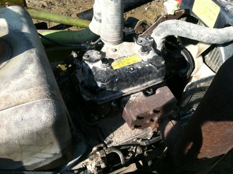

That thing looks slightly rougher than my similar YM240 was when I bought it. A couple hundred $ brought it up to good working condition, replacing fluids, battery, bashed headlight, etc. This model is pretty much unbreakable, if you verify that everything seems to work as intended. And idiot-simple to work on if it does need something. (No comments from the peanut gallery please. :D)
That's a factory original loader except the bucket. He must have had a business selling mulch or sawdust or something. My nearly identical loader - a Great Bend third-party loader likely installed by the dealer - runs from the tractor hydraulics like that one, and is slower than you would want if you are buying the tractor to use specifically as as a loader. Also the non-syncro transmission is a nuisance if you want to go backward and forward all day. For farm or hobby-farm work where the loader is important but not used all day, this model is fine and has lots of lift power.

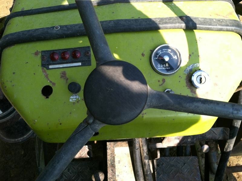

That's a final-year YM240D indicated by the external air cleaner. (So 1981).

Tell Dad the horrible racket likely isn't a rod knock, they just sound that way. CLANK CLANK CLANK.

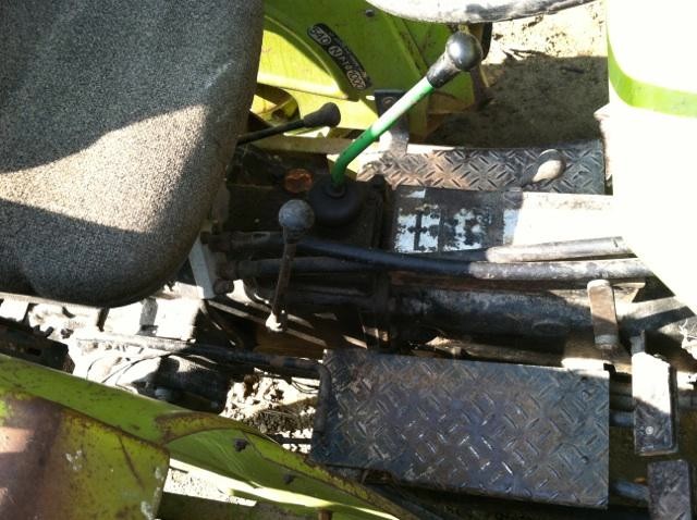

Look for jumping out of gear, a slow starter motor (only $100), and the obvious diesel stuff - severe smoke at idle, etc. You mentioned Dad has experience with diesels so a general look-over should spot anything. Tell him to be sure to run through all the gears including FWD, check that the tractor's hydraulics lift the loader and 3-point, etc. That additional hydraulic system might be worth some money to somebody for a log splitter especially if can mount on any 3-point.
