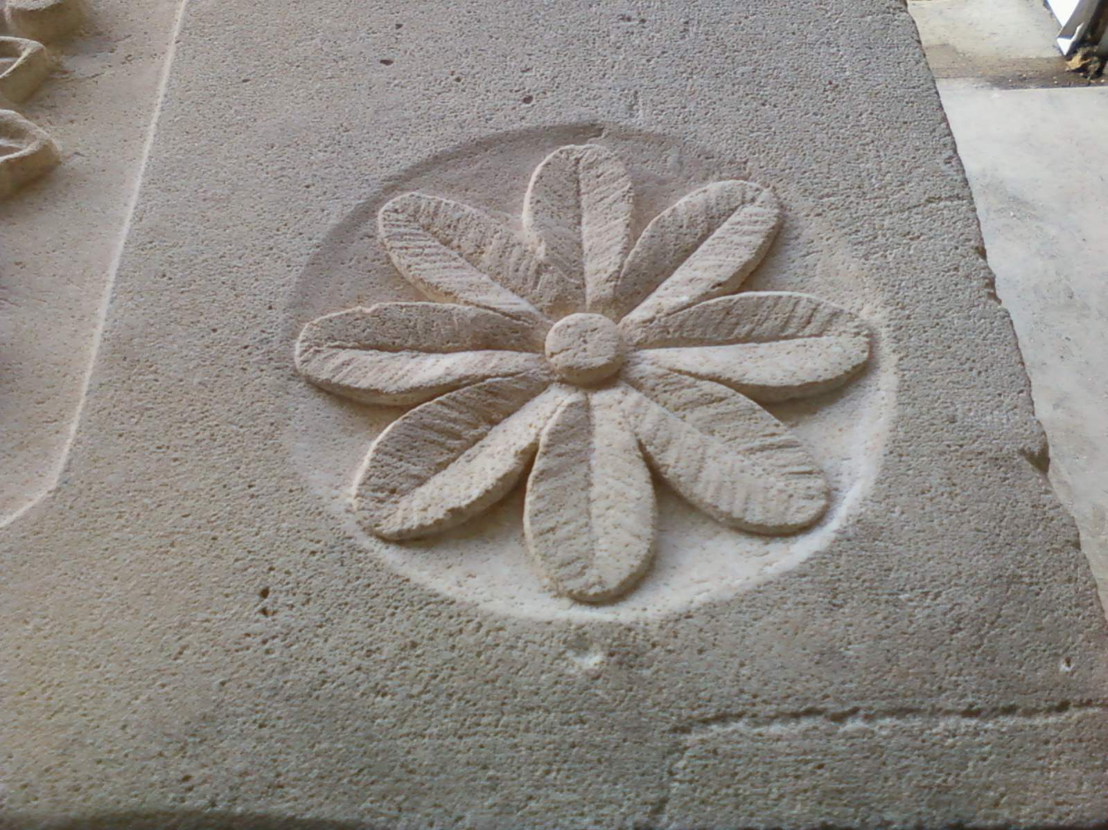

I carve stone relief panels and they are fragile because they can be as thin as 1/2" thick, 16 " by 16". I work with as thick as 2" slabs as well, but in any case I must be very careful not to crack the stone.
Texas Cream?

Indiana Limestone. We have quarries and mills all around. Mill cut Odds and ends can be bought for $20/ton. Just a hobby, making dust. Good time take ones thoughts away from work...

No wonder you are using power tools. Nice job.
I can't seem to find a way to keep my back, and neck from becoming a knot when I carve. So, for now, I have given it up.

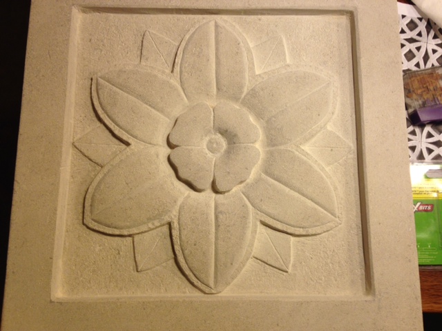

Nice work, looks close to a pc I did a while back. If you are in Ohio, Limestone? Do you use air tools? Ever type the Trow and Holden "Bamtan". I'd like to add that to my X-mass list, bit pricey at $250. But it has a 3 cfm, low for air tools
It can be a pain to hunch over your work pc. I made a "lazy Susan" table so I can just spin the pc. Soon I want to build a heavy duty easel so the pc is vertical in front of me while standing. If I can incorporate the lazy Susan and an easel, cats meow!
