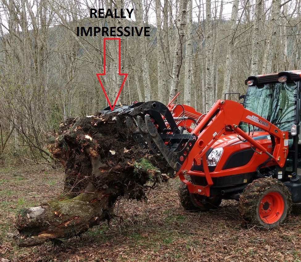

Keep in mind that there's the fulcrum effect to consider. You won't be able to lift the difference between spec numbers and the grapple weight as your load will always be out farther than the distances that lift capacity specs go by. It may be obvious, but I felt it needed to be pointed out.
Hey Travis, care to dig out my stump picture? Yeah, I'm a single lid, but the point would be that there's no way I'd have picked up; that stump like that with an 1,000 lb grapple!

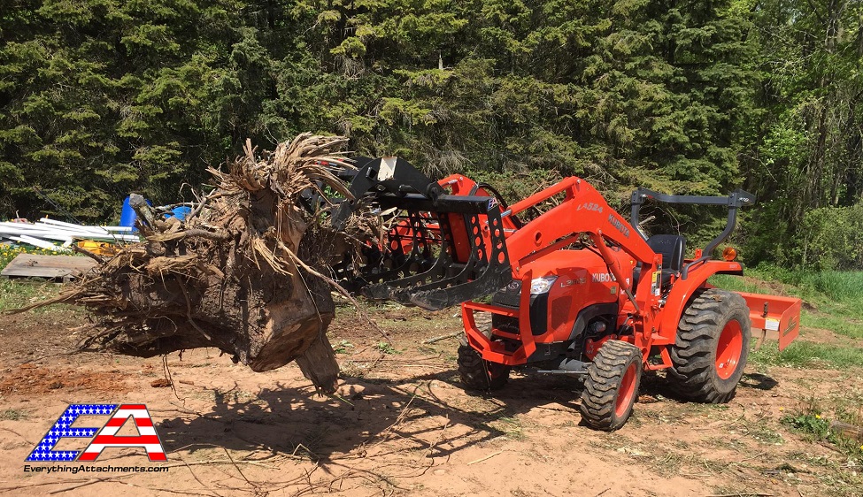

You know I'd love to! :thumbsup:
Here's an L3800 with the same grapple doing something similar.
And... the type of material matters as much/more so than weight. If strength were based solely on weight then a lead grapple would excel!
:thumbsup: :thumbsup:

But, BUT... that Kubota has extra ballast in the rear (box blade)! :laughing:
   / Looking for Help Grapple Shopping #16
:laughing: :laughing: And...and....your unballasted Kioti outweighs it by about 2,000 pounds! :laughing:

And I'm stringing up a very HEAVY, WET maple stump (with a bunch of wet dirt still stuck to it)! Trust me, I really could have used some added ballast!:thumbsup:
Good point. I can see all the sticky dirt still hangin on vs. the Kubota with a dry stump!!

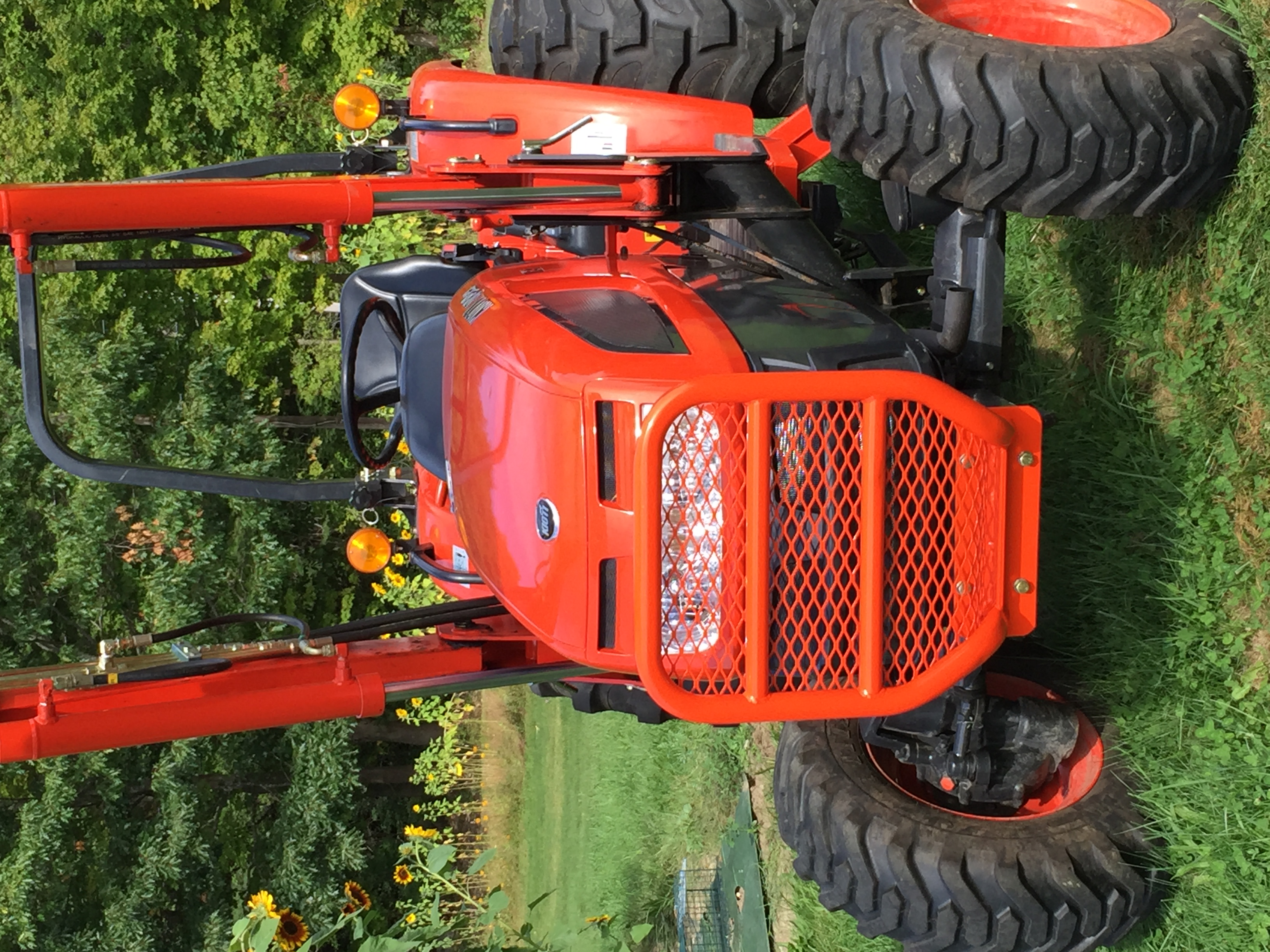

For the grill protection (how I never put anything through my radiator without protection is a mystery) I tacked in some expanded metal to the grill guard, I'm a crappy welder so it's already come loose, that fix is next with some angle iron and better welds.
