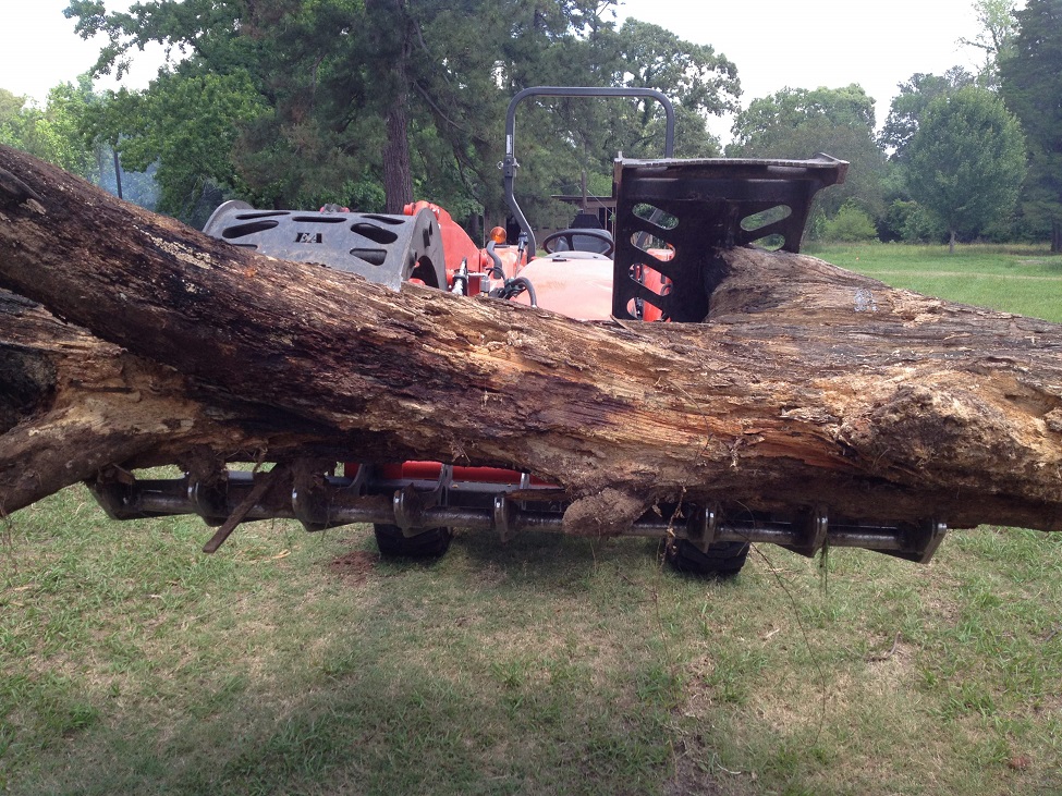

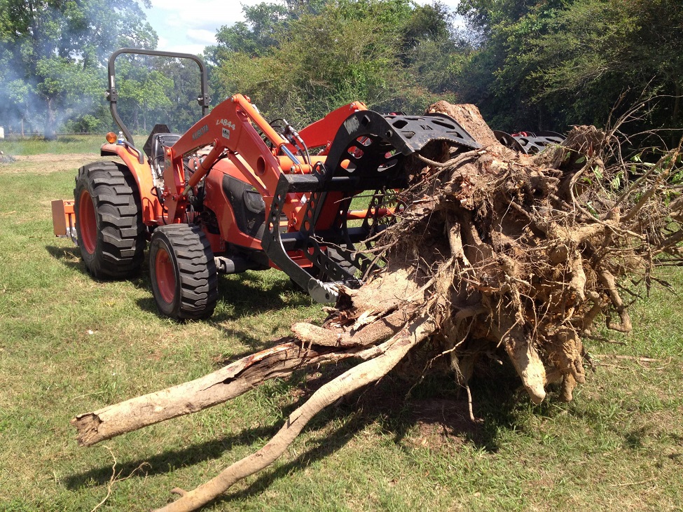

1) Has anyone bent or severely twisted their grapple, or perhaps caused damage to it that owns a two cylinder clam/claw grapple? By this I'm not asking about bragging by abuse, but rather unplanned & unexpected damage from normal use? In reading some posts, one concern I have that has been pointed out by IslandTractor is that this type can inherently cause damage based on cylinders compressing an uneven load.
Here's a pic of the EA 55" with a stump at one end of of the grapple. You can see the lid twisting a little bit at full hydraulic pressure but it straightens itself out after the load is released. The 55 is a light weight 209 lbs so I would think if you were to buy a heavier duty clam shell type there would probably be less flex in the lid.
I don't normally pick stuff up at one corner of the grapple but that's the nice thing about the full width lid is that you can if needed.

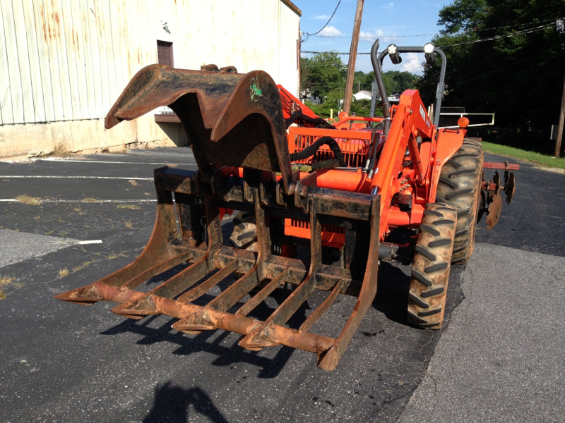

I probably do not even need to point this out, but I can't help myself on the subject...
IMO, you'll absolutely hate a 700, 800, or God forbid a 1,000+ pound grapple on the front of your COMPACT tractor!
You'll like a 600 pound grapple a lot less than a grapple in the 400 pound range.
The Wicked Grapple is proven. It has been on MX series Kubota tractors for years and people absolutely love them. Roots, rocks, stumps, logs, vines, trees...you name it.
The tine design promotes your ability to run them through the ground.

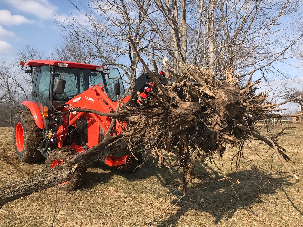

This isn't the tip of the iceberg for pics I've gathered, but I really like these!
Travis

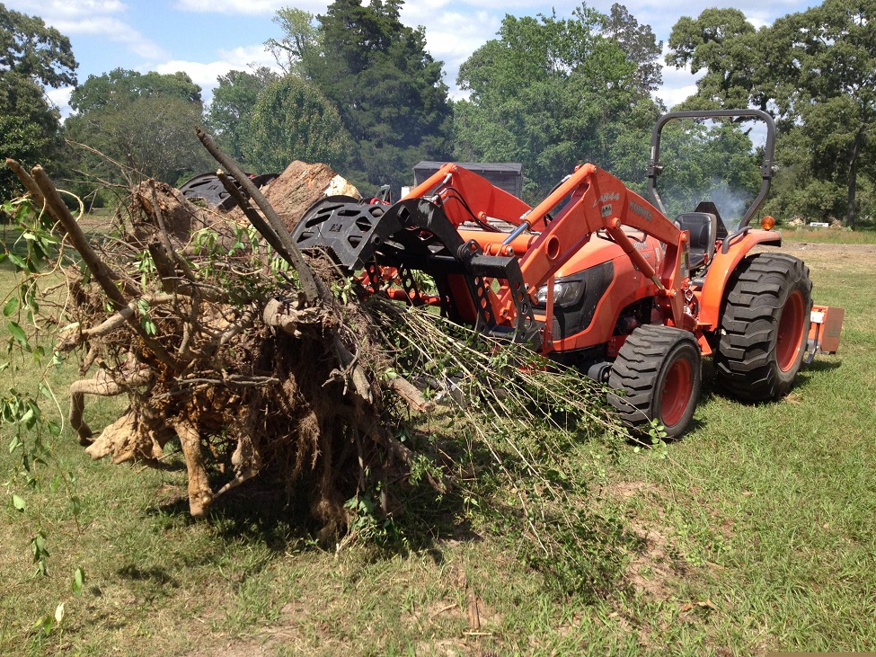

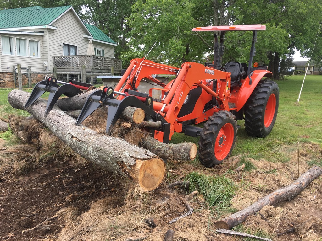

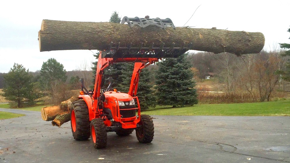

Here's a 72" dual lid hiding behind this freak of a stump cluster. The tractor is an L6060.
The cradling ability of the grapple adds to it's versatility. This is an MX5100 with a 72".
Why limit your lift capacity with a heavy grapple? This is only an L4600, but it will lift more than an MX5100 with an 800 pound grapple on it!
More crazy stumps with the MX5100
Finally, here's an unloaded Wicked Grapple on a 5100.

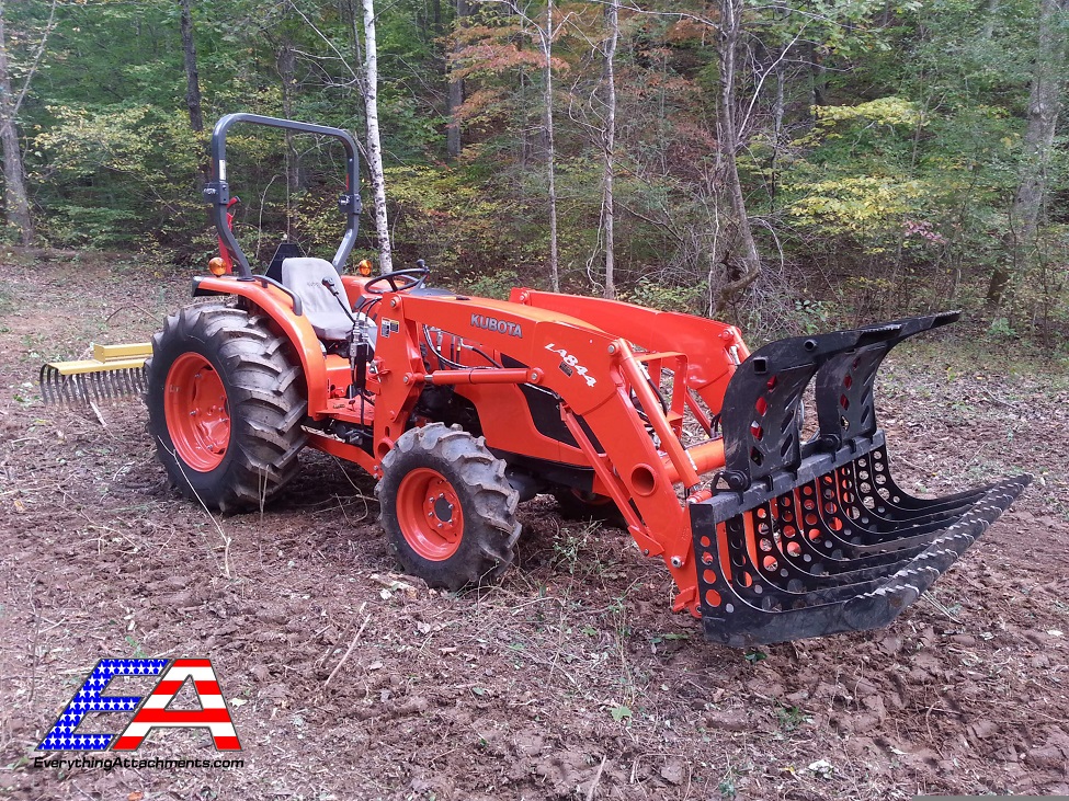

If you want to dig roots, forget a wide grapple. My 48" will do everything a wider one will do, plus dig out trees. And uprooting trees and carrying off the debris from that and chainsaw work is what I've done extensively with my 70 horse Kubota. You are not going to be effective digging with a 6'wide grapple. It would be like digging with a snow shovel.

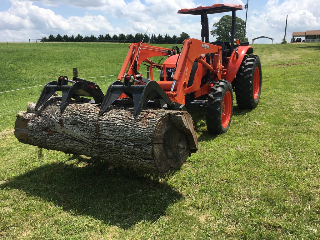

Keep in mind that there's the fulcrum effect to consider. You won't be able to lift the difference between spec numbers and the grapple weight as your load will always be out farther than the distances that lift capacity specs go by. It may be obvious, but I felt it needed to be pointed out.
Hey Travis, care to dig out my stump picture? Yeah, I'm a single lid, but the point would be that there's no way I'd have picked up; that stump like that with an 1,000 lb grapple!
And... the type of material matters as much/more so than weight. If strength were based solely on weight then a lead grapple would excel!

Here's an L3800 with the same grapple doing something similar.
:thumbsup: :thumbsup:
