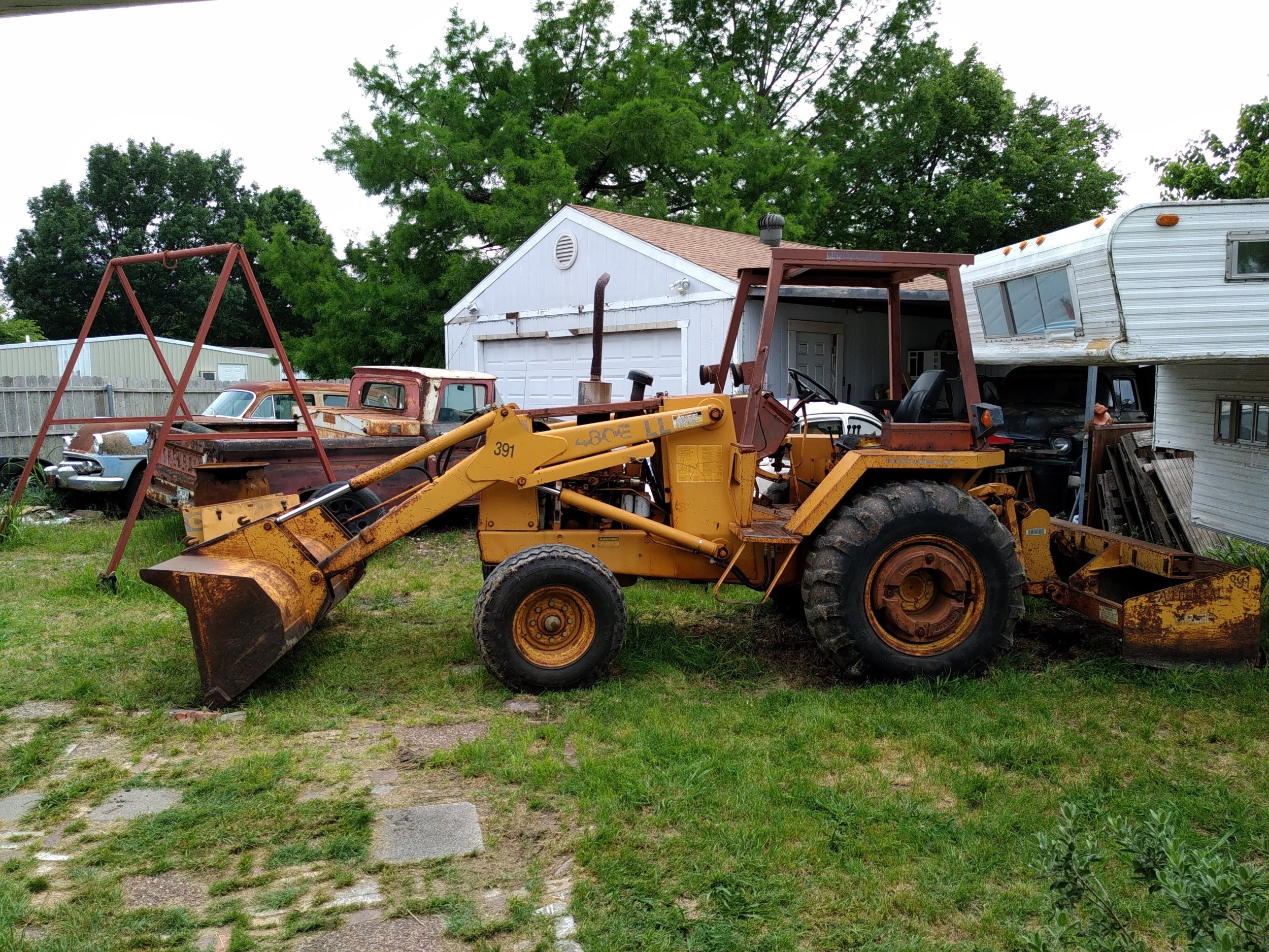

I bought a used 1989 Case 480E LL to re-gravel my own driveway and some other projects. The machine was inexpensive and seems to work well.
Got it home and parked it - reading up on it.
It has some leaks I want to fix.
I plan on washing it and will check to see exactly where it is leaking.
Also saving up for some crushed rock.

Nice tractor. The leaks our old industrial tractor had were both in the large diameter return and supply hydraulic lines to and from the sump. Neither one is a high pressure line, and both seemed OK but tightening hose clamps didn't change that the hoses were often wet on the outside of the hose.
It turns out that both hoses had small longitudinal splits in the inside diameter at the ends where the hose clamps tightened them. I now know that those splits are common in old hydraulic hoses handling hot fluid if they are hose-clamped at the ends. It was a simple matter to replace both hoses, but all the fluid was lost.
