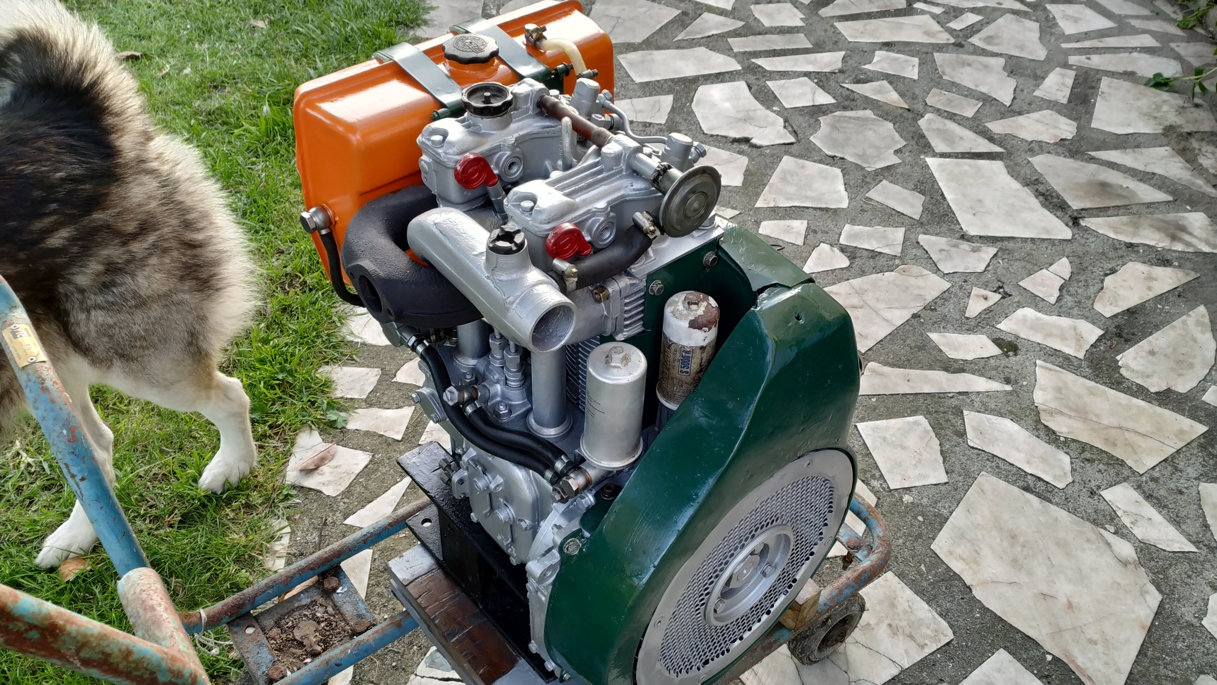

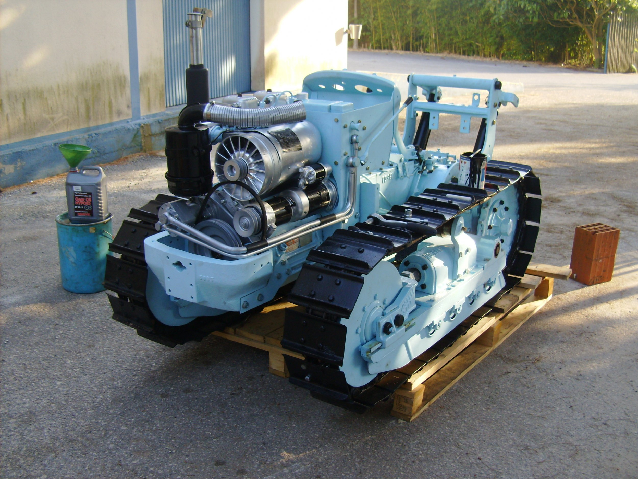

Those old school air cooled diesel engines were awesome. Just keep the oil at the right level, clean the air duct and fins every once in a while and the thing just runs forever.
I had a 2 cylinder 26HP and a 3 cylinder VM 40HP air cooled engines on my crawlers and now a 25HP 2 cylinder Slanzi engine on the generator. Great on fuel consumption. The VMs were rated at 2000 RPM and made peak torque at like 1300 RPMs or so. The 2 cylinder one would start with literally half of rotation of the crankshaft.
Sadly, another great series of engines killed by emissions. I would still like to get one for my log splitter though, to replace the screamer gas engine I have now since the tractor sits most of the time at the remote propriety.
