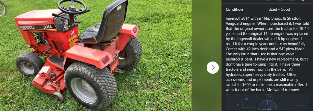

Ingersoll made a good mower that can still be found for your price point. 3014s are a goods size for your acreage.
