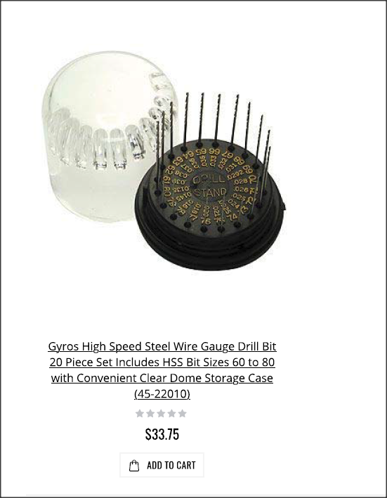

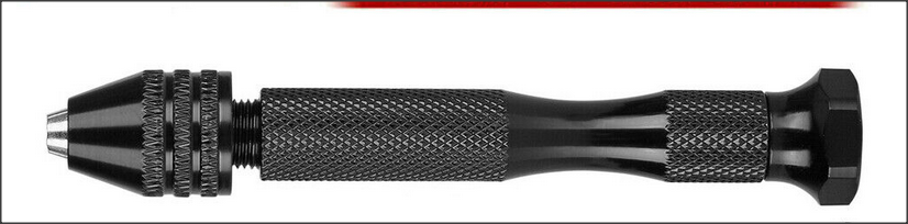

Howdy Sir! I have TWO John Deere GT-235 garden tractors that I'll keep forever! They turn ALMOST as tight as a "zero turn" mower. The one with the Briggs & Stratton engine surges at idle and needs it's EPA approved jet enlarged slightly.
............snip............
Perhaps the jet has a burr in the orifice, or other manufacturing defect ;)
Micro drill bits like these should solve that problem.
Used one of these on similar problem with a gen set that would not produce rated kW output - a tiny "wire gauge" drill bit fixed the issue in the main jet!
Handheld chuck should be sufficient since it may take only a tiny amount of cleaning.
Easy to find online, eBay etc.
