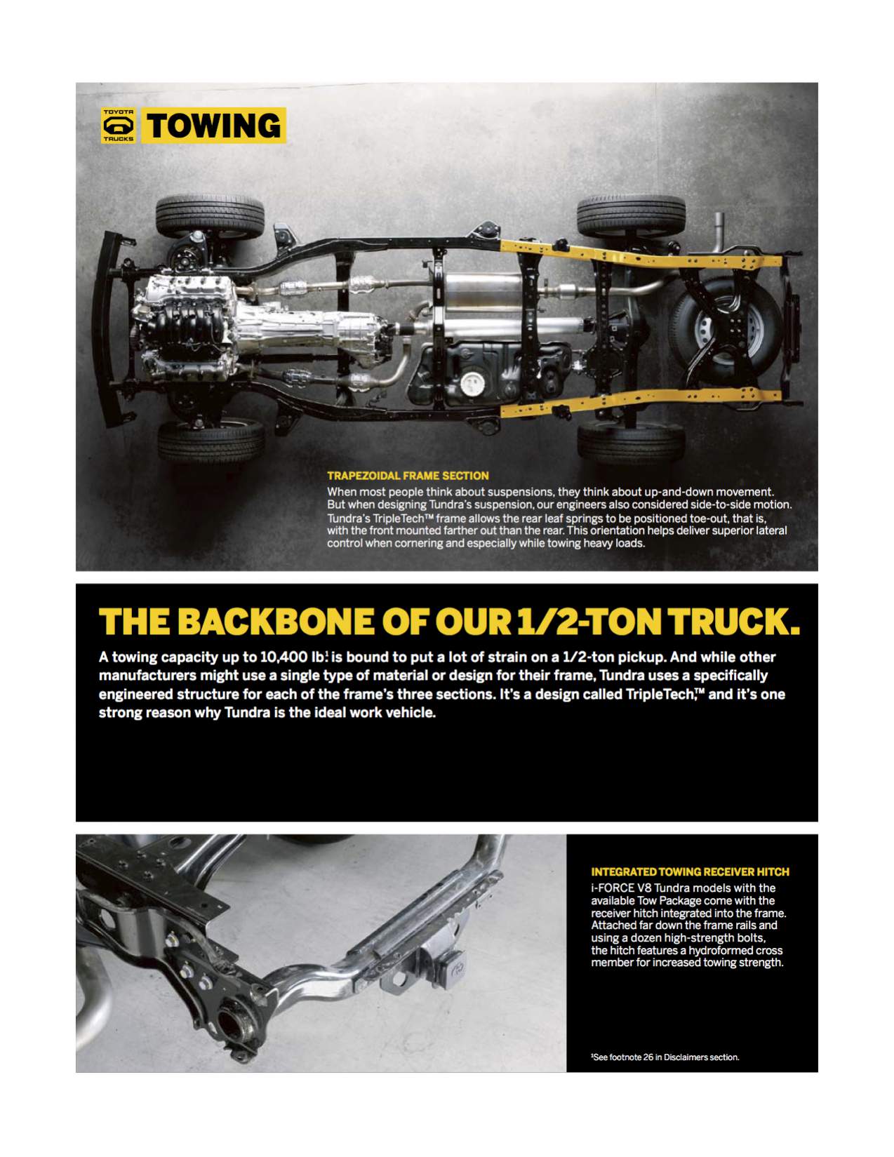

I have never seen a hitch that was not bolted on. Look again.
Chris
Looks like it's time for you to take a trip to the local Toyota dealer to see it in person, then. This is NOT a bolt-on hitch. Here's pages 7 and 8 from the Toyota eBrochure for 2012 (which is just about identical to the information published for 2011, and my truck is a 2011). This is the second generation Tundra and has been in production since 2007, so the design has been around for a number of years.
   / Looking for input on trailer choices #40
View attachment 272273View attachment 272274
Looks bolted on to me.
The reason Toyota boast about the hitch being part of the frame is because it is. There is no rear cross member like other trucks. Not knocking Toyota, I drive a Nissan Titan 90% of the time and also have a F-350 Diesel. I love my Titan and feel its one of the better trucks on the road in the 1/2 ton segment. I looked hard at the Tundra back in 08 when buying but the rear frame was a concern to me since my job is towing.
Chris
