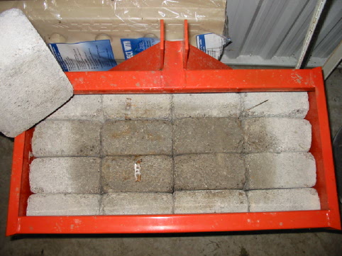

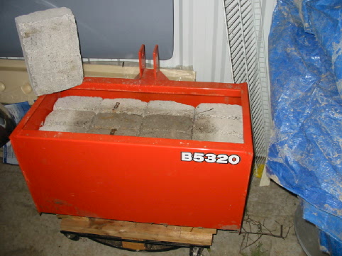

My 7800 is the same way going between ranges. Sometimes have have to jimmy it a bit. As one poster said, and the owners manual too I believe, push hard on the brake. As for ballast, that is why I purchased a box blade. At about 500 lbs, plus loaded rears, it doubles as a pretty good counterweight, and I found it to be quite useful for loosening up dirt too. If I am going to be using the FEL for heavy stuff like gravel, then I fill three 5 gallon buckets with gravel and put them on top of the box blade for a bit more weight. I think the box blade is a pretty good bang for the buck.

I couldn't agree more with the ballast. I have a little BX1500 that can only hold 400lbs in the bucket, however without ballast, the machine feels unstable. I ussually keep about 450lbs on the rear when working with the FEL on. It feels real solid then.
Ok, this has been beat around a bit already, but that never stopped me before!
The HST tractor actually has 2 completely separate transmissions. One is the HST and the other is a 3 speed conventional gear transmission. It gives underdrive, direct drive and overdrive. In "H" you are putting that transmission in overdrive. The HST is a variable pump - motor device. In simple terms when you push the peddle down, there is more hydraulic flow. More flow means more speed possible, but less fluid slip (tightly coupled). Picture your car in 5th gear, you bring up the rpms, but don't slip the clutch. The engine dies because there isn't enough torque to drive it forward. But, when you feather in the clutch (slipping it), the car will drive forward with the load gradually matching the engine torque.
On stability, if you can -- move the wheel centers and rims to make them as wide as possible. Also, fill the tires, add steel wheel weights and use a heavy 3pt attachment or weight box. It will lower the center of gravity and give you more traction. It won't ever be super stable as it is up pretty high, but those things will help.
