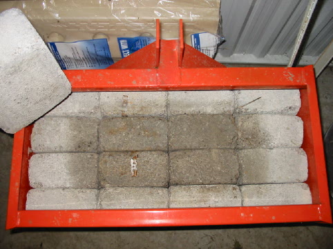

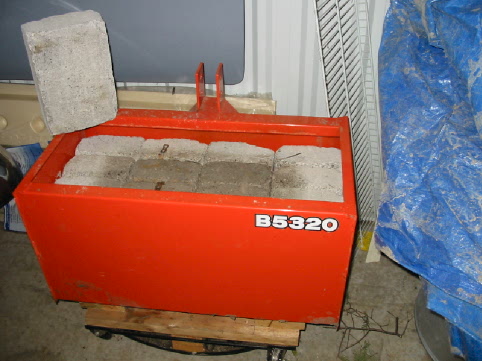

Not to keep kicking a dead horse, but I can't even find a ballast box on Kubota's website? Aside from that I was thinking of taking a 30 gallon drum, putting some holes in it so I can hook it up on my 3 point for a ballast. Then fill it with sand or concrete. Does anyone know if that would work OK or not? Does anybody know how much weight I need in the ballast for a B3030HSDC w/ LA403 loader?
   / Looking for others opinions #30
The ballast box I use on my B7800 is a B5320. I found some small cement blocks that are meant for building retaining walls that seem like they were made just for this ballast box. They measure 3 3/4" x 7 1/2" x 11 1/4" and weigh 25 pounds each. As you can see from the pictures 16 of them fit in the bottom of the box and another 3 lay flat on top for 475 pounds. If you wanted to stand the top row on their edges you could fit on another 100 pounds. I can pick up a full bucket of gravel and move around on level but rough ground with 475# in the ballast box with no problem, but then I do everything pretty slow. My tires are not loaded but I think I'm going to get them loaded because some of my work is in tight quarters and I don't always want the ballast box hanging out the back. I my limited experience it seems like the ballast box makes the front end a little lighter which is good for steering but not so good for digging with the FEL. If you get those little blocks to put in don't forget to put a piece of strapping under the last one so you have something to lift it out by if you ever want to take them out.(can't fit fingers in)
