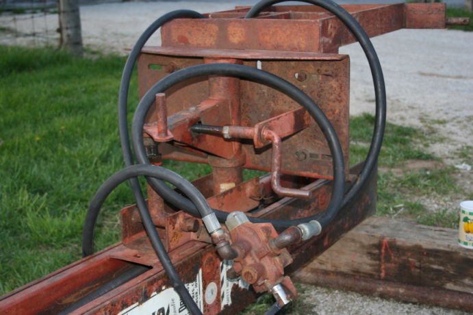

Does anyone have pictures of their hydraulic post driver they can post? I am trying to determine what is going to be needed to convert a Shaver HD-8 from a bucket mount to a 3PH mount before this weekend. If anyone has pictures of the mounting points it would be much appreciated. thanks.
/ Looking for post driver pictures #2
Here's a picture of mine.
/ Looking for post driver pictures #3

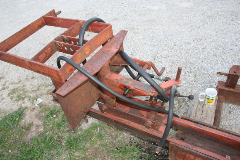

Thanks for the pictures. Any of you know what the bucket attachment would look like? In your pictures it looks like the 3PH attachment assembly bolts onto the adjustment plate. I am wondering if the bucket attachment is something totally different and that I would need to buy the 3PH assembly to convert it over. I am hoping this guy will send me more pictures of his driver. What he told me in an email is that I would just need to buy some pins for the lower links and weld something on for the top link.
/ Looking for post driver pictures #5
I have never seen the bucket attachment. You are right about the 3ph assembly attaches to adjustment plate. Here are two more pictures which may be of some help.
You can always buy the 3ph mounting bracket separately. It's around $380.
