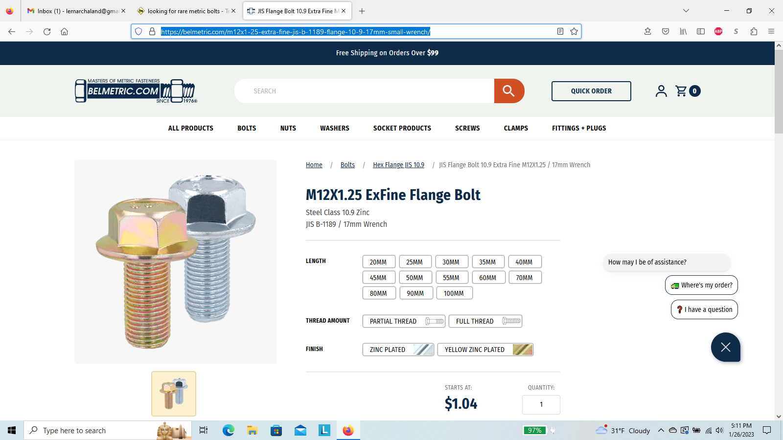

belmetric may work! For some reason they did not come up in my search.

Isn't Belmetric the $45/bolt place?
