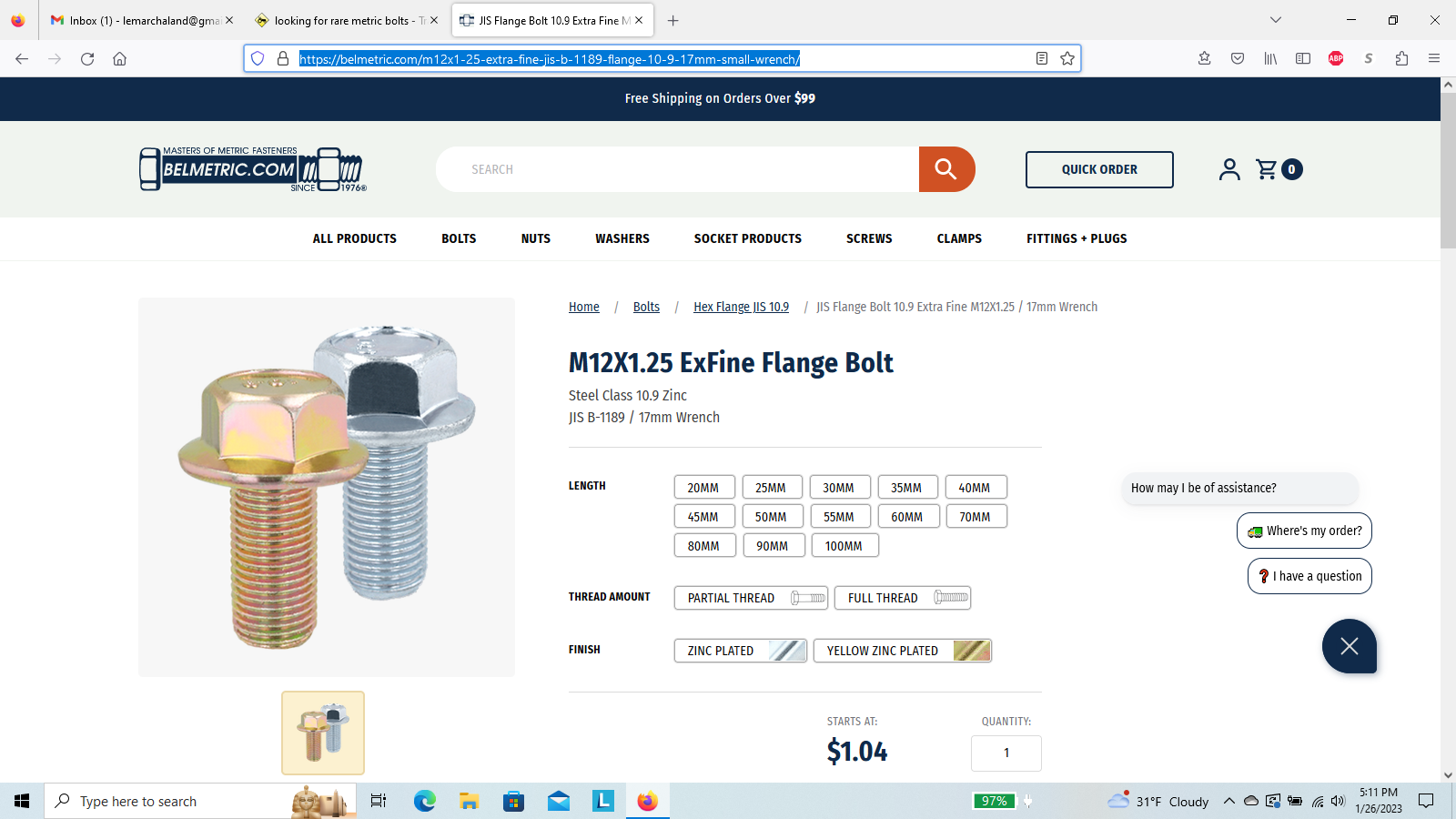

belmetric may work! For some reason they did not come up in my search.
LS parts may work, half of the factory bolts where I did not plate are longer so I may be able to order 16 of them. Thanks everyone for your input, I will give update when I know more.
Isn't Belmetric the $45/bolt place?

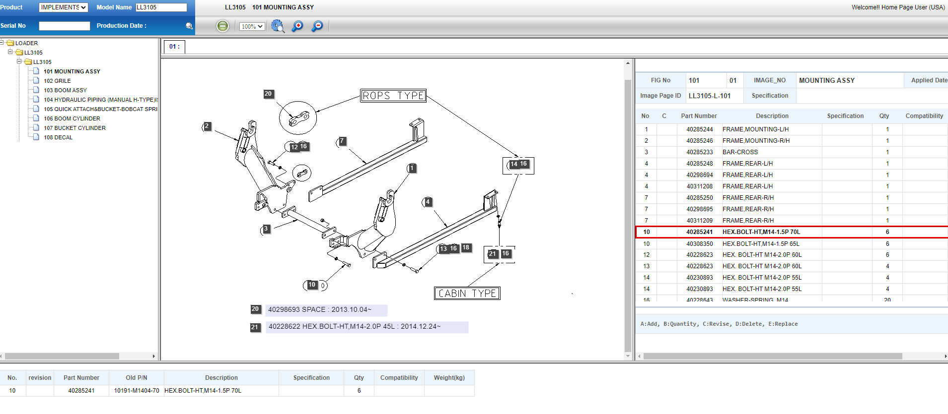

Web Parts Catalog.
See where the factory frame goes from double to single - that is where it cracked and the single plate I doubled to match the front. So I should be able to get 16 of those id #10.
Thanks everyone!
   / looking for rare metric bolts #34
Web Parts Catalog.
Thanks everyone!
You may want to triple check your bolt thread pitch.
I checked the parts catalog and they list M14x1.5 which it a lot easier to find. M14x1.25 is pretty much an odd size and most likely a specialty thread of some sorts.
