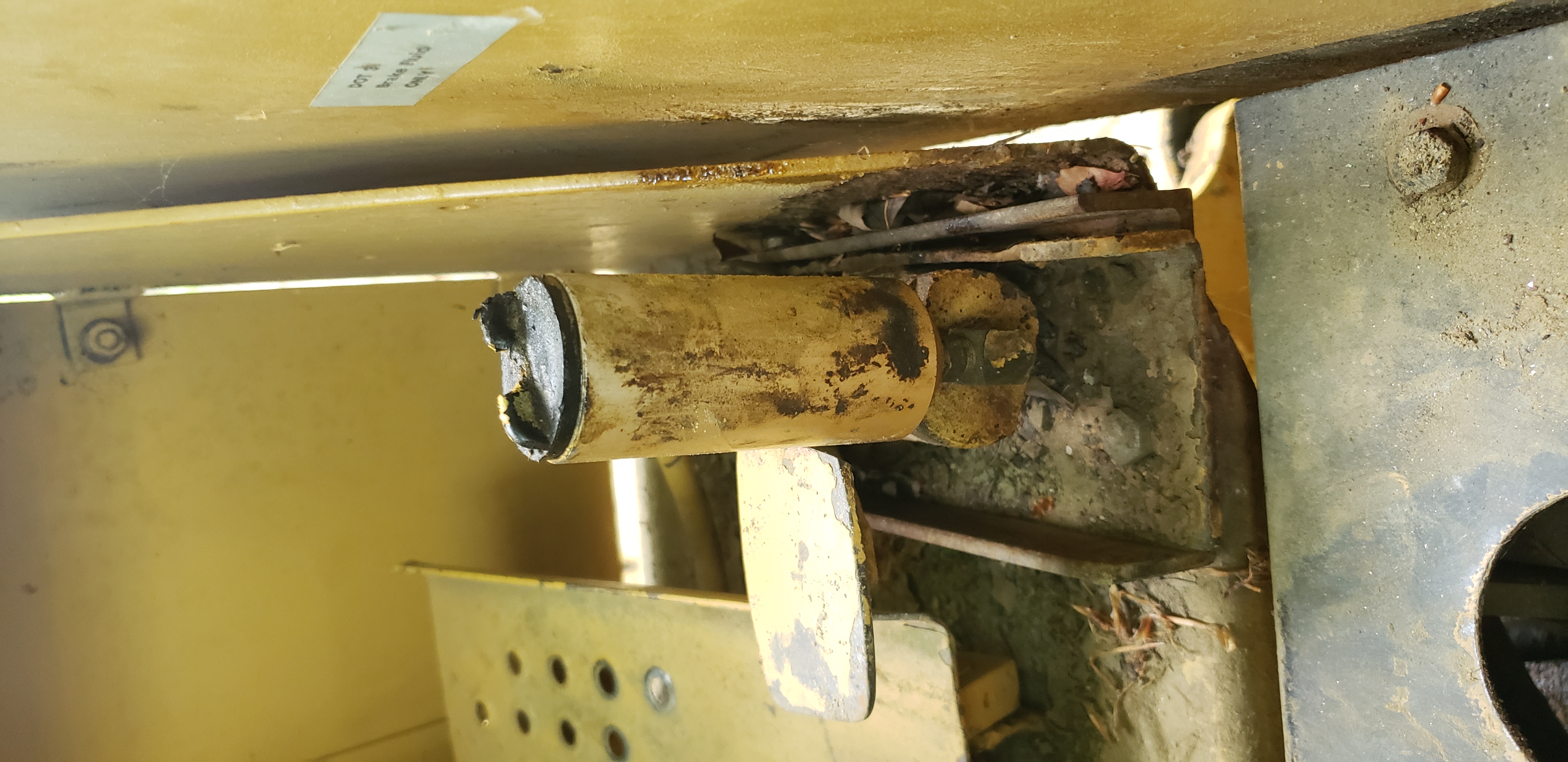

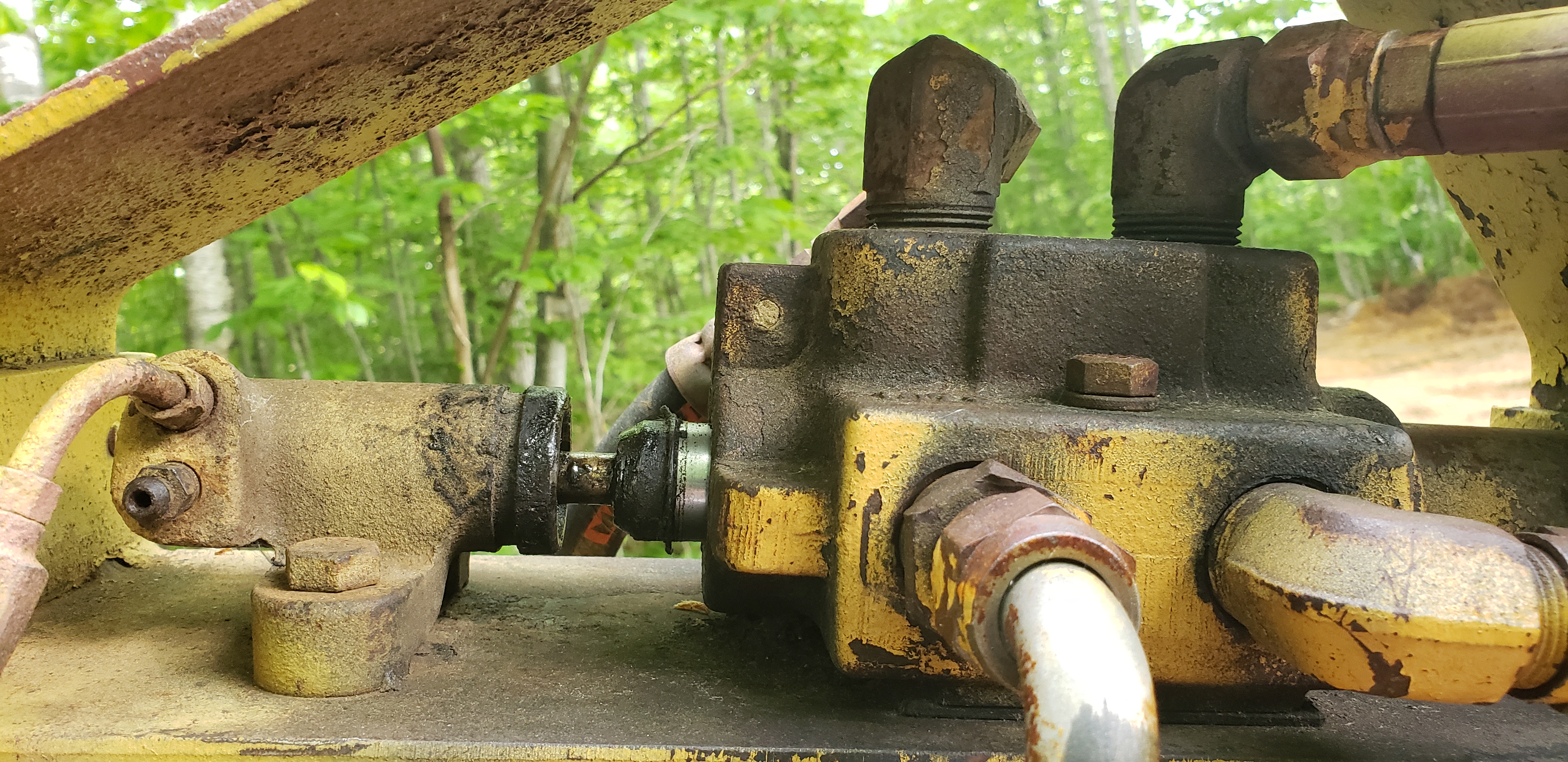

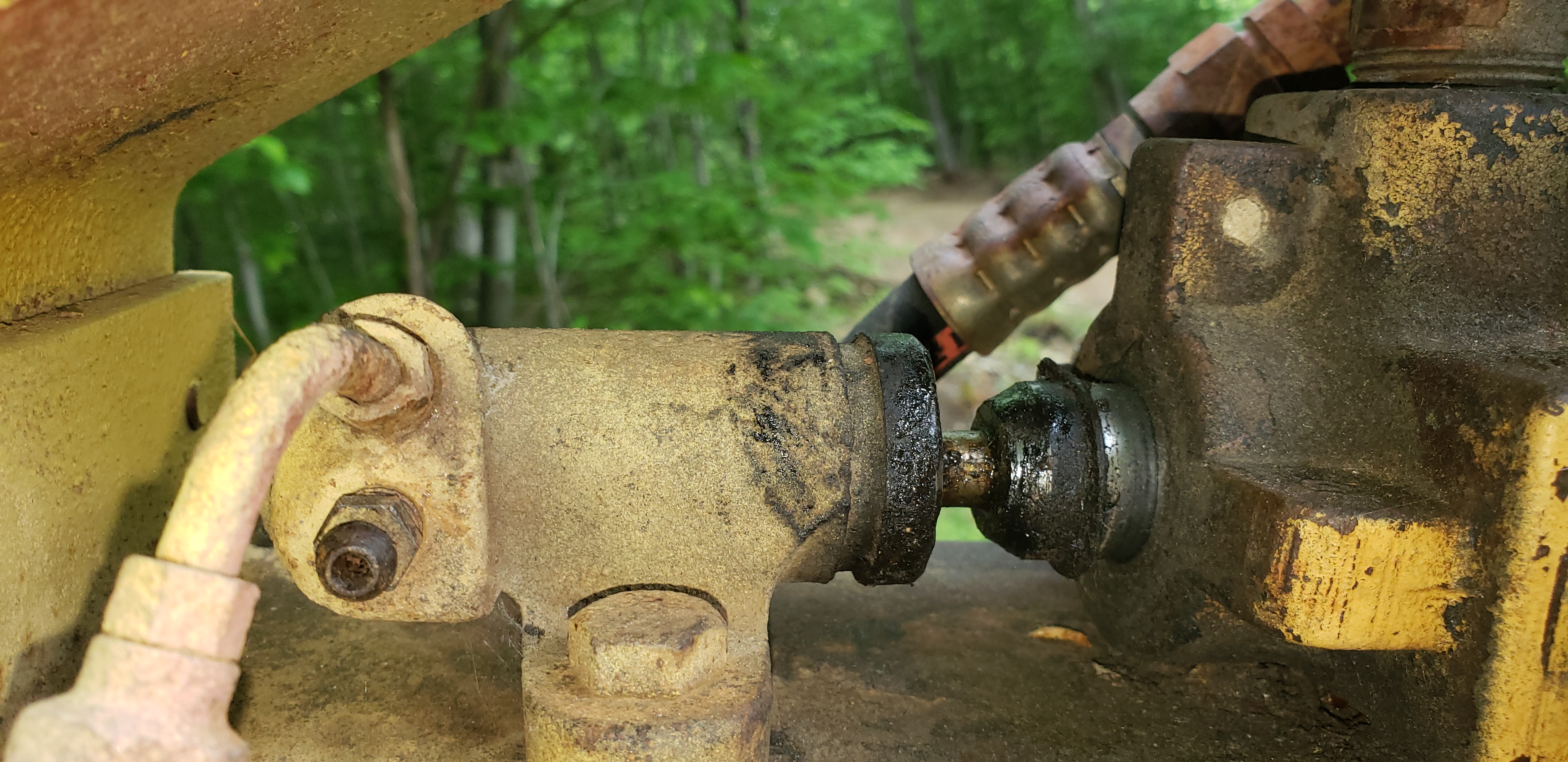

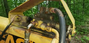

Hi guys,
Looking for some help/suggestions. Our 1978 Case 580C backhoe has a thumb that is operated by a floor mounted slave cylinder (see pics). Well its is not functioning even after flushing the system, which is pretty basic...push pedal down, slave moves valve in to divert hyrdo fluid to move thumb into position, remove foot and rod is pushed back into cylinder. We believe it is an aftermarket thumb and there is no marking on it.
My question to you all is, Can I change out the hydraulic actuator one mounted at the diverter valve to an electric solenoid? and if so, any recommendations or links to what I could use. I can weld/retrofit a new mounting bracket if need be.
Thanks everyone for the all help.

Thanks for the reply oldnslo.
,It is just a two position, push pedal down, slave pushes rod out which in turn push the rod into valve (I guess changing where the fluid goes) to thumb while holding pedal down, relise pedal, fluid goes back to operate bucket curl. When I need o retrack thumb push pedal, use curl control to bring it back to home postion.
As far as force required, i can push the rod into valve by hand while my wife deploys or retracks the thumb for me.
As for linear actuator that is my thinking, was just looking for links to something someone might have used....guess I'll surf some more this weekend and try getting ahold of a real person to talk to.
