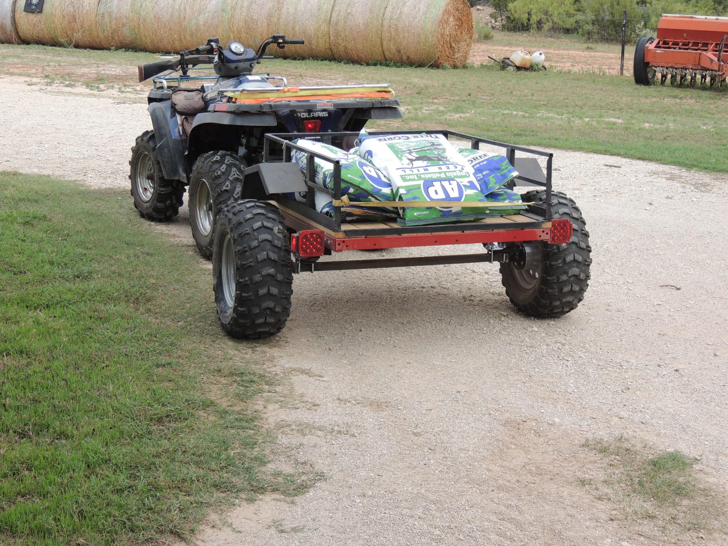

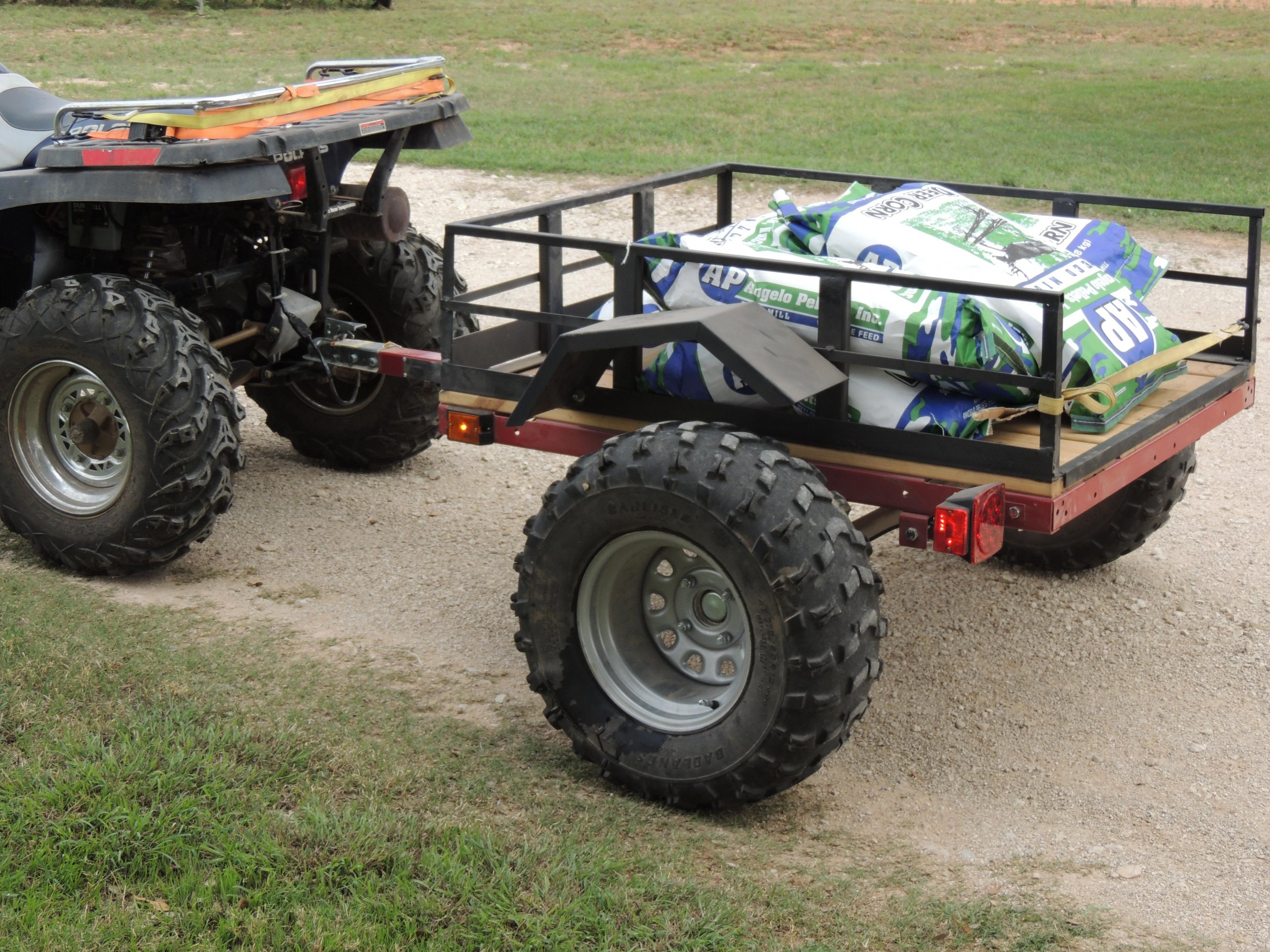

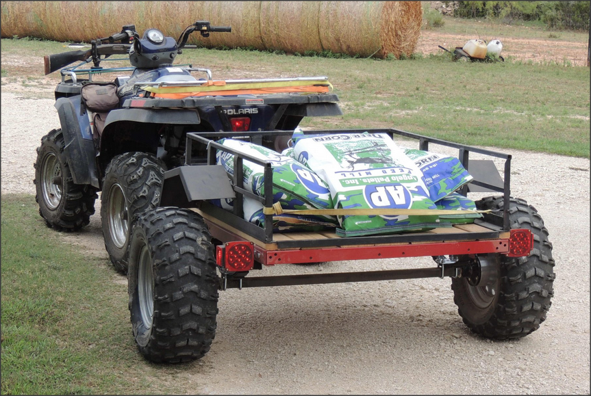

I built one and had fun doing it. I started with the smallest Harbor Freight trailer in a box. In order to use wheels with the offset and width for real off road tires I ended up using 2" wheel spacers. I miscalculated as 1" would have worked fine. The side rails were some scrap that I had laying around. This trailer has been pulled in excess of thirty mph offroad. It has real wheel bearings vs the tiny little wheelbarrow bearings used in many of the commercial produced trailers. I have around $600 invested in it.

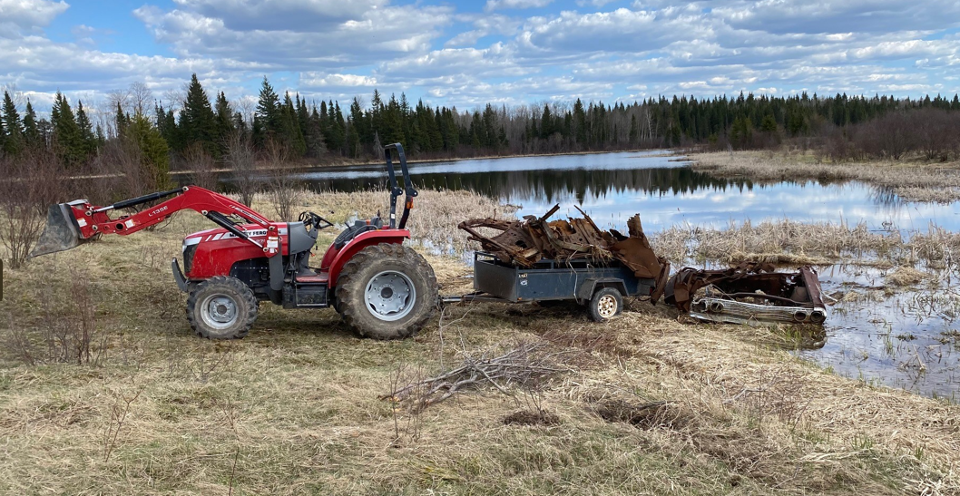

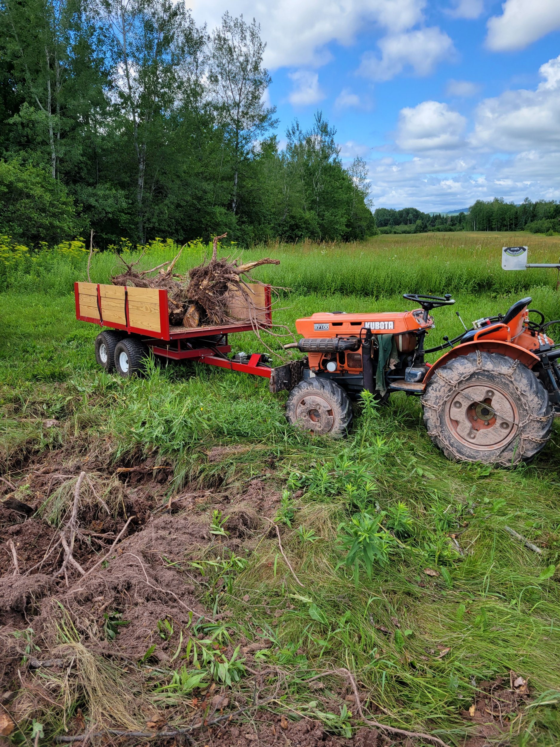

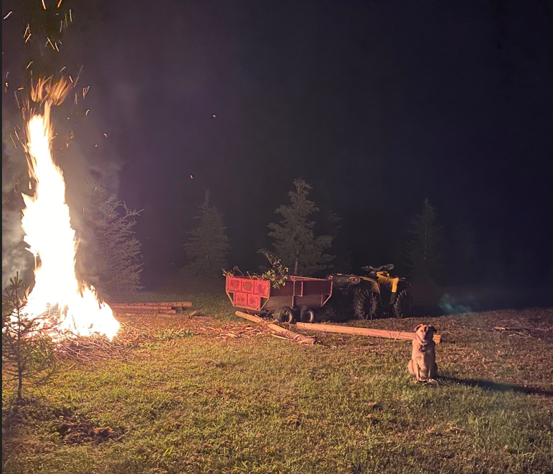

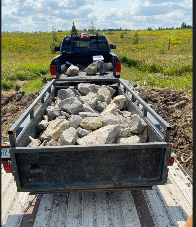

These are two of the three trailer I use on my property... I would need to change the tires on the double axel quad trailer they don't have enough flotation in the mud but the tandem oscillating axel dose wonder, you can go across a ditch and the trailer bed pretty much stay level. (see video below for demonstration)
The second one is a very solid trailer but too heavy for off roading behind my quad but I use it a lot in the field and on solid ground... a very good trailer to pull behind the tractor tho...

that tandem video is worth watching if anyone is on the fence! Wow.

It looks very good, however wheels sticking out like that would be a big problem in my case due to many trees on the property.
I needed trailer not any wider than ATV or whatever is pulling it behind.
Your mileage may differ - perhaps your property is more open or trees further apart and it's not a big deal?

It really isn't a big deal. Plenty of two tracks and open fields on my place. About the only time that this rig has to get out into the brush is when I retrieve a downed deer. I can pick my way through most of it or just drag the deer out to an access point if needed. That wide stance makes a super stable trailer.

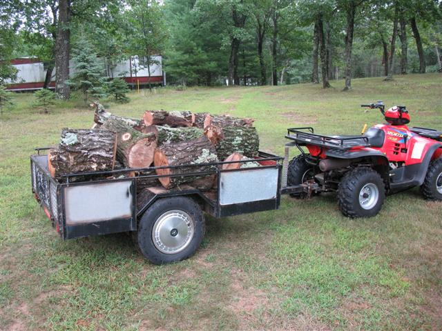

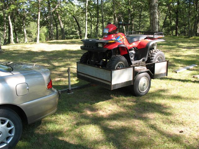

I needed a trailer that could transport my ATV an also go anywhere thru the woods that the ATV could go.
