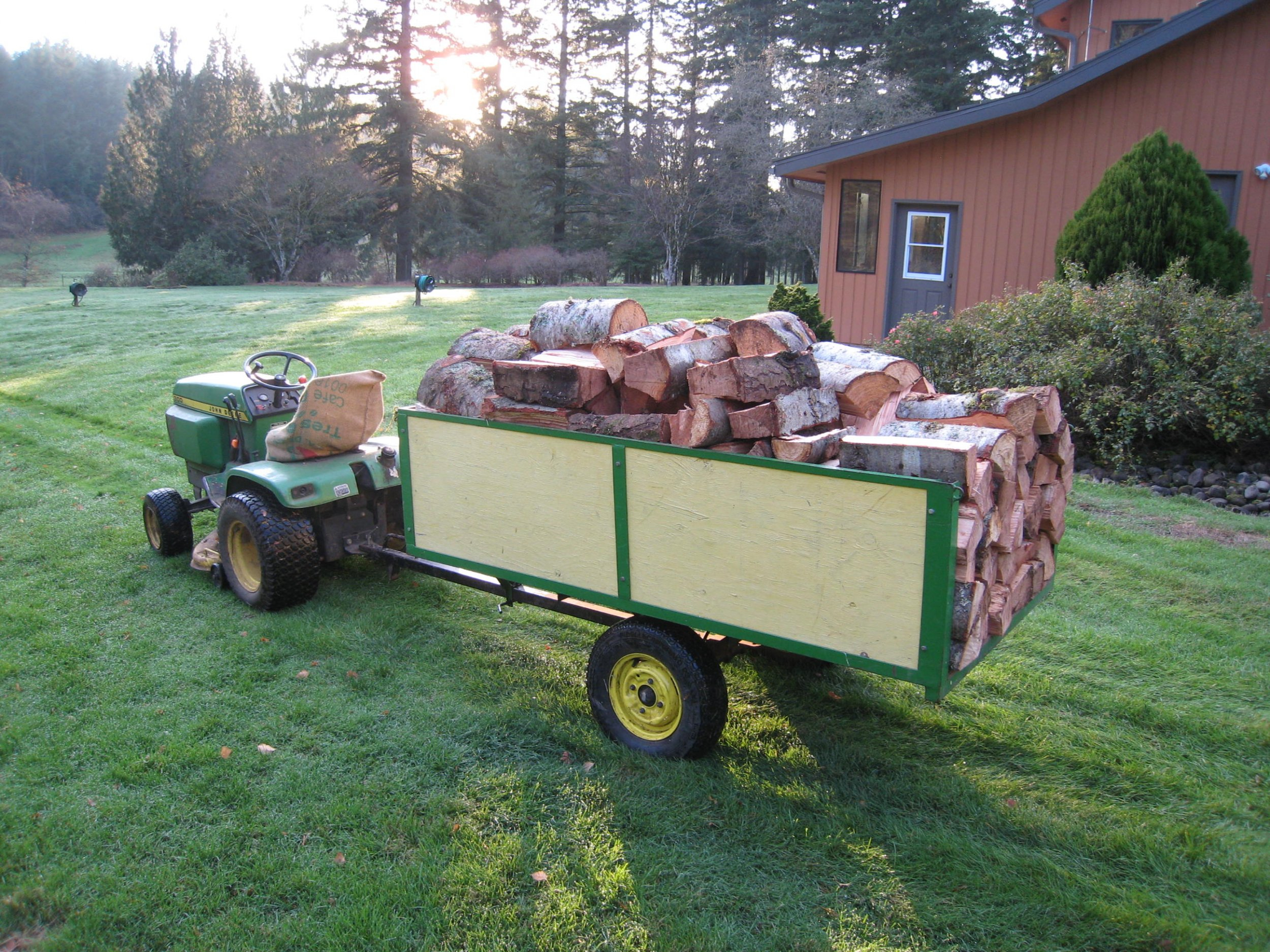

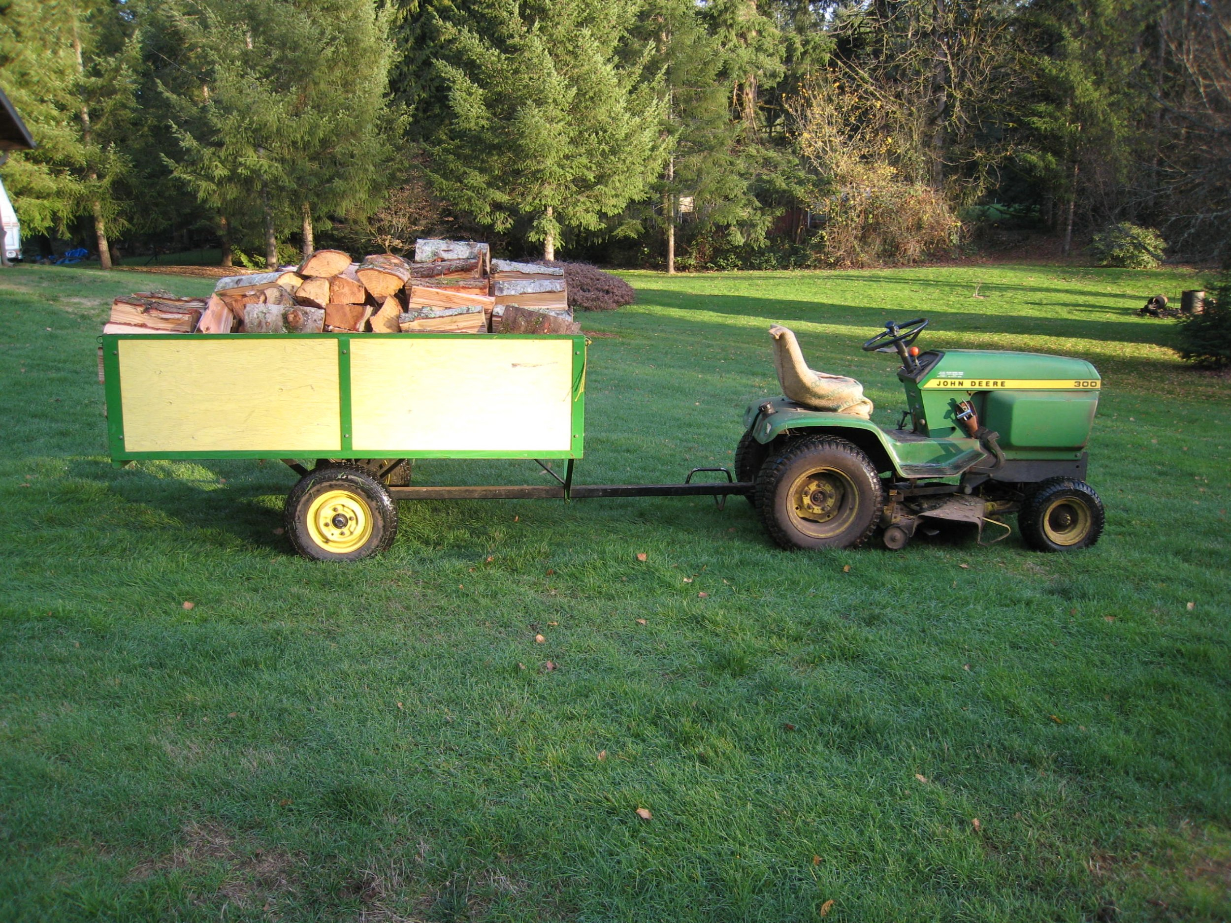

Made my own all-around the yard dump trailer in the early 90's and used a salvage yard rear axle from a tiny Honda car.

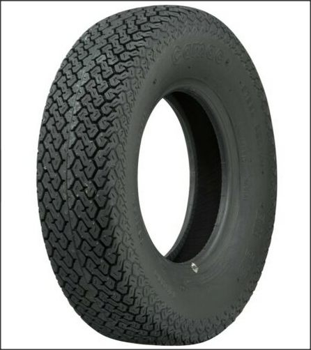

145R-10 Tires

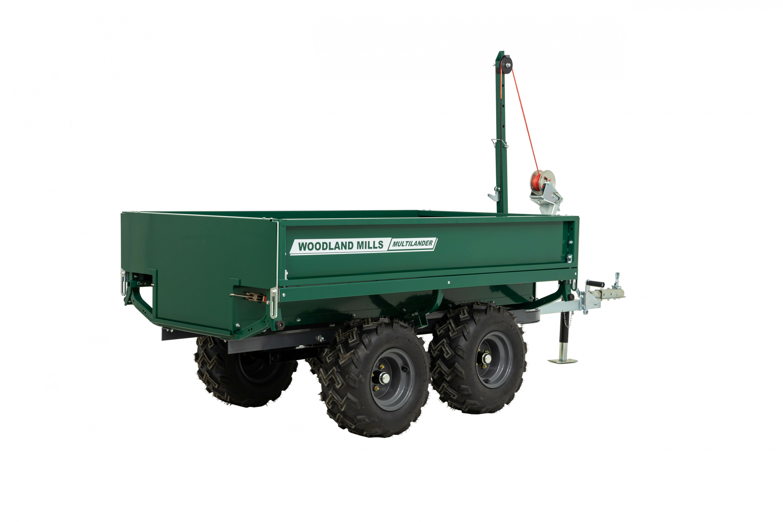

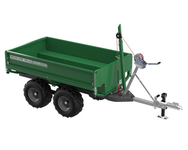

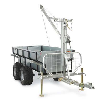

comparing these two, apparently the WM unit has heavier metal (16ga vs the DR's 20ga), and the WM has a 50° dump angle vs the DR 35°, so stuff should actually fall out of it better.
I'm intrigued, particularly if one could reasonably attach height extenders to fit a bit more chips.
Wouldn't want to go too high though, may roll the whole unit...

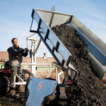

A major shortcoming of the DR VersaTrailer (in addition to the limited 35˚ dump angle) is that while it can carry up to 2000#, it can only dump 600#. I considered getting one years ago, but that dump limitation was something I just could not live with.
I checked with Woodland Mills. Their Multilander trailer can dump its full 2000# cargo rating.
Not to defend the DR but I wonder if the dump limitation is a weakness of the winch or can the frame not take the changed geometry's stresses? If the latter, that's definitely a bad thing and says a lot about the rest of the trailer!
   / Looking for small off-road trailer #27
It's a design limitation (probably of the boom). One of their options is a 1500# rated hoist to replace the hand crank winch. Even with that electric hoist, the 600# dump limitation remains.
