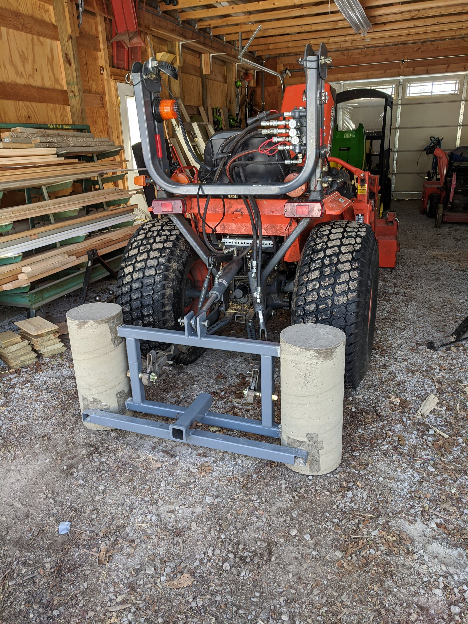

I made this, I like it because I can tow trailers without taking it off and it doesn't block my view in back.
I think something like this is the best way to go.
If you don't already have a quick hitch, you should probably get one, as it makes life so much easier.
If you're going to get a quick hitch then recognise that its location makes it act like a counterweight anyway, so why not kill two birds with one stone? Build a very heavy quick hitch yourself, or modify an existing one to make it very heavy. That gives you additional functionality as well as more counterweight.
Perhaps a third benefit is that a quick hitch has depth. Because of this depth, anything hooked up to it is a little bit further back from the rear axle. The further back the mass, the more effective it is as a counterweight. Thus a quick hitch acts as a force multiplier and makes whatever actual counterweight you use more effective — for free.
As long as you don't make it so deep that your 3PH implement's PTO shafts end up too short, a very heavy quick hitch seems to be a win on all fronts.
