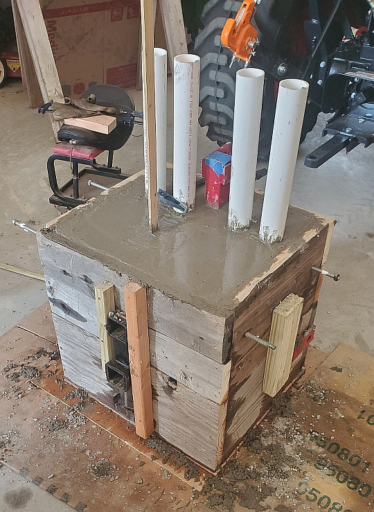

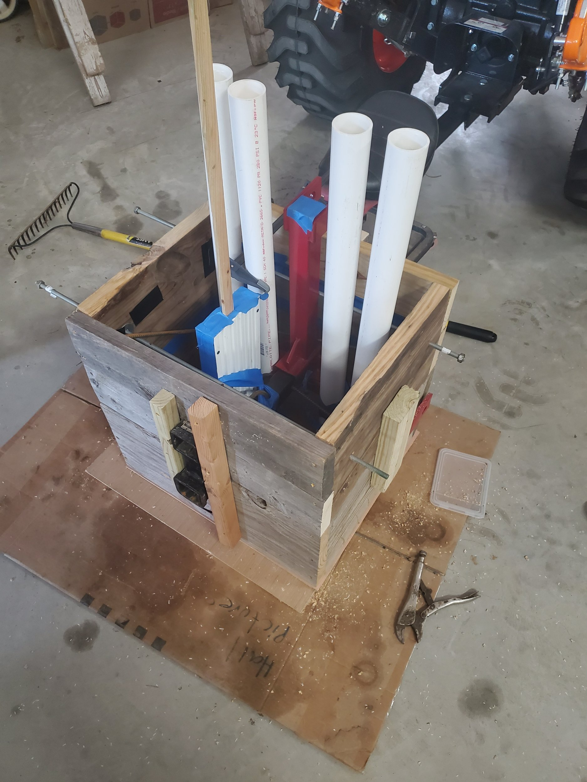

My take on a homemade ballast box. Just poured it yesterday. Somewhere around 650 lbs. I use Pat's so I didn't have to worry with quick hitch fitment issues. Now the hard part. Waiting for it to cure.

I guess if I had tight quarters - I might consider a ballast box. But I don't - so I don't.
