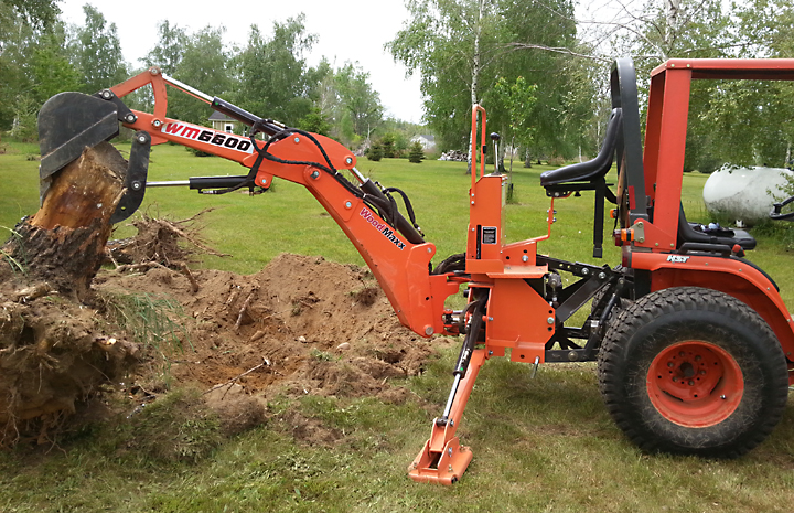

Most good sized stumps require you to dig out where the root size is small enough to tear thru them. Easier on your hoe and quicker in the long run not to try to dig too close. Some stumps require you to dig deep down next to them to allow the dirt to fall away from the finer roots below the stump to help unglue it to the earth pillar underneath it. Once you get the ability to nudge the stump by yanking on one of the sides and get some movement, the dirt will slowly fall away from these finer roots and the wiggling will get easier. Then, magically, the stump will just start allowing you to move it at will. You can grab it and rotate it out of the hole. Jump off the tractor.. lift your head to the sky... beat your chest... and do your loudest ' Tarzan ' yell.... :) [ whilst the neighbors stare out the window.. shaking their heads.. in awe/disbelief .. ]
Too funny! You almost described my reactions after removing this beast. You just forgot the part about cracking open a cold one as a reward for a job well done.
Not having a backhoe and not willing to admit defeat and go rent a stump grinder as the wife suggested, I used my post hole digger to loosen the soil around the stump, a pick axe to chop the roots and the bucket to rock the stump untill the roots underneath gave way. Straps on the bucket to drag it out and then the victory dance! :cool2:
   / Looking for stump digging advice #10
Stumps are hard on equipment. If you can get to them with a stump grinder I would seriously think about renting one and not putting that kind of wear and tear on your tractor/ backhoe. If they are all very small stumps then I would try a few but time yourself so you can get an idea just how much time it'll take you. Don't get me wrong, I'm a fan of doing it yourself with equipment you own but sometimes it's better to accept that just because you can doesn't always make it the best choice.
   / Looking for stump digging advice #11
Stumps can be hard on the equipment. I did shear a couple of pins on the post hole digger when I snagged a root. That is when I stopped and took another approach using a pick axe to dig close to the tree.
Once the main roots were severed, rocking the stump back and forth using the bucket, loosened the hold of the root pillar and from there it was easy.
Best advice is take it slow, keep the wheels on the ground and if it's not going your way, stop and rethink your plan of attack.
This stump took me 4 1/2 hours spread over two days, to remove.
BTW this stump had previously been ground with a stump grinder but only down to ground level. 10yrs later as I wanted to level the area a bit for a small pool it resurfaced and became a thorn in my side again. :mad:

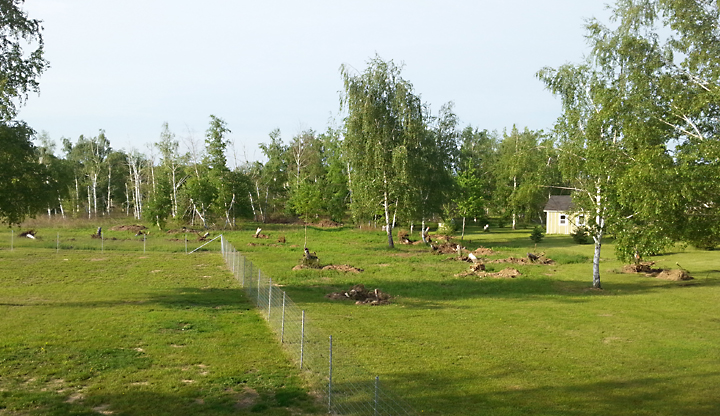

Thanks for all the advice guys. I did dig out a couple of stumps last fall with the original 12 inch bucket. Even though the 9 inch bucket doesn't sound much smaller I think it did make a difference in being able to curl under roots and break them easier. My goal was to try and keep the dig circle as small as possible to minimize damage to the "lawn". Most stumps were in the 8 to 12 inch range and I was able to dig them out without going out more than about 2 feet in any direction. These are all birch stumps and they took anywhere from 20 minutes to an hour. The second picture shows my first 2 days carnage (about 7 hours total). My worst stump was an 18 inch one that took 2 hours and forced me to dig out a bit further. I started "cheating" on that one by using a battery operated sawsall with a carbide tipped blade to cut through the large roots. That stump is shown in the first picture. I'm sure glad I bought the $300 optional hydraulic thumb. It's great for grabbing and lifting the stumps out of the hole for easy pickup and moving with my fork attachment.
