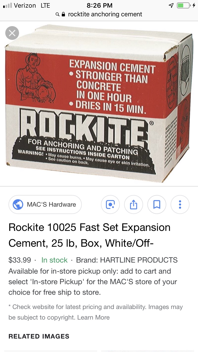

I don't know manufacturer. Manufacture of rails/sliding mechanism could be different manufacturer from actual shelves. It's an aluminum frame with slots. The shelves themselves are pretty standard steel shelves.
Bought it off CL a while back. Obviously did not re- install properly. Trying to avoid taking rails off to fill with steel (and potentially fail) and just fill the small gap with filler. Shelves do not get heavy usage.
PS
Based on quick read Rockite may not work--expands and meant to stick to cement.
JB Weld on other hand should stick to aluminum and does not look like it expand.
Did not look into other recommended product sufficiently yet.
PSS
Max GFE looks to be 5x stronger than JB Weld
