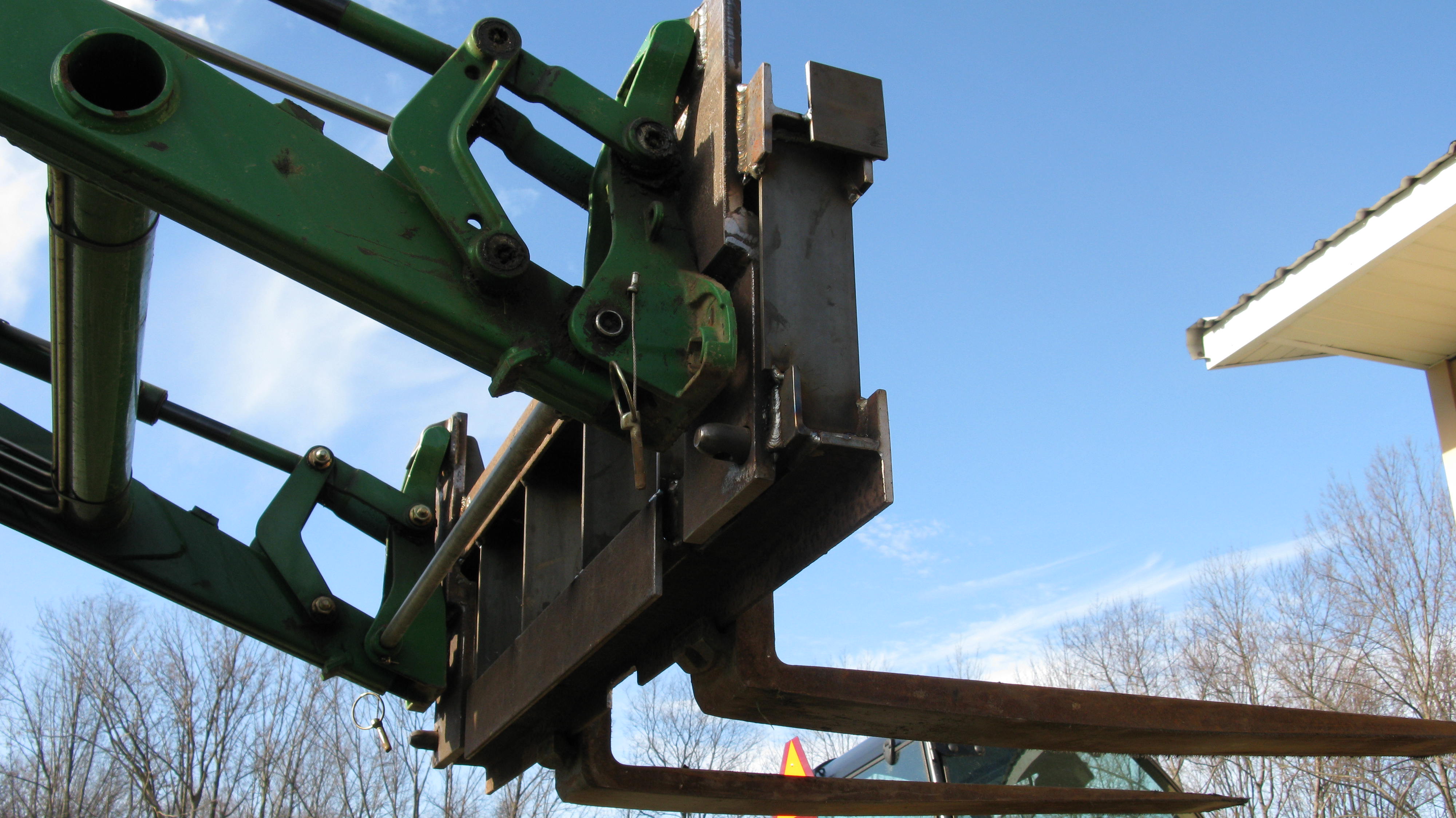

I made this for a friend several years ago. He had the forks and some old material. I just put the stuff together. I did not paint it because I was tired of working on it. The old material needed ground and rattled before I could weld it. He purchased the JD mounting hardware. Next time all new material. IMG_2529.jpgIMG_2531.JPGIMG_2534.jpgIMG_2530.jpg
   / Looking for the tbn'r who posted their custom made forks that also went on the 3pth #9
I forgot to mention this was for a 5000 series JD . That is the reason the bottom lock pin is not engaged. The adapter on the 5000 series has it's C/L at 18". My 4000 series is at I think 15"
