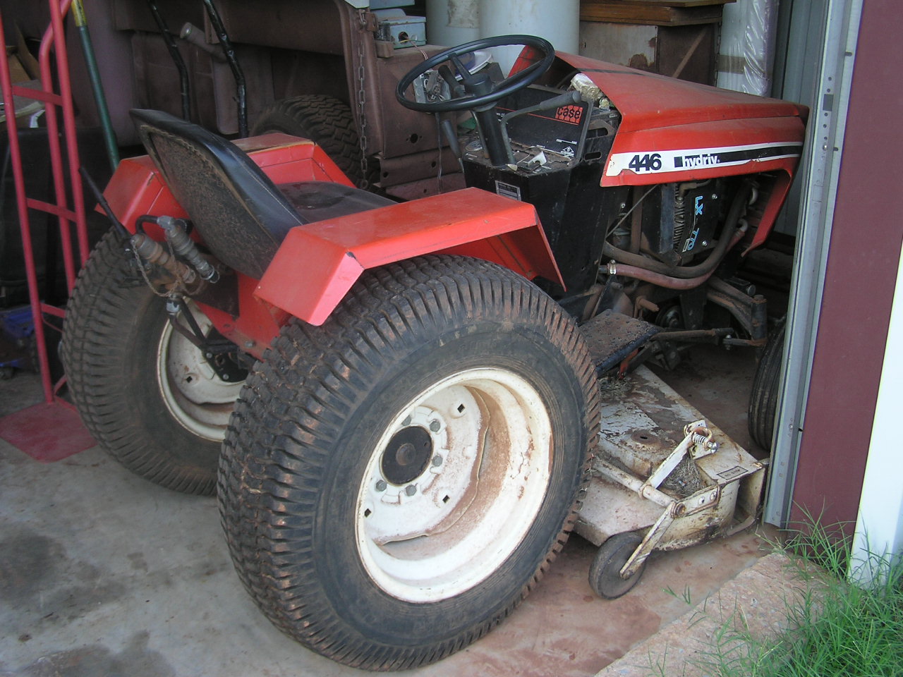

I used to have a Case 446 with a 46" deck and the hydraulic connectors on the back.

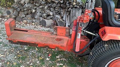

The Case Ingersoll 3 Point Hydraulic Log Splitter Model J32.

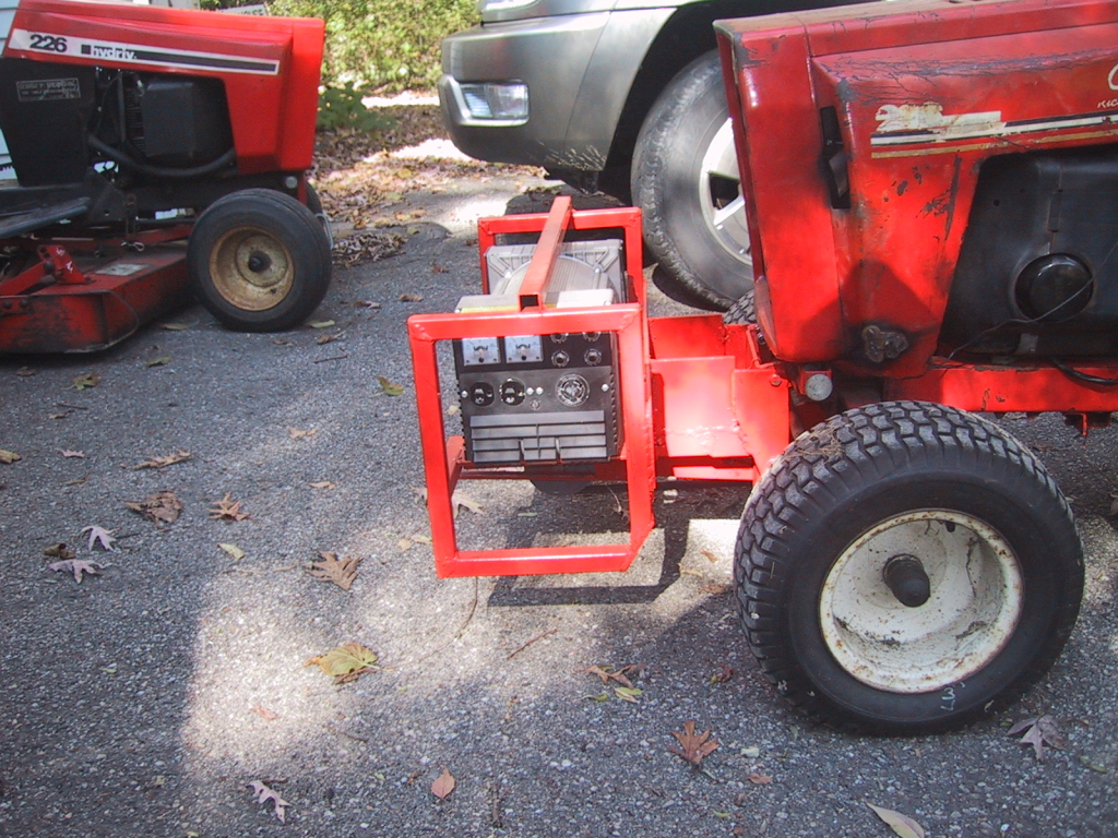

Here is a 10K generator on the front, in another forum: Case/Ingersoll 540 PTO Rear hydraulic hookup! - Page 2

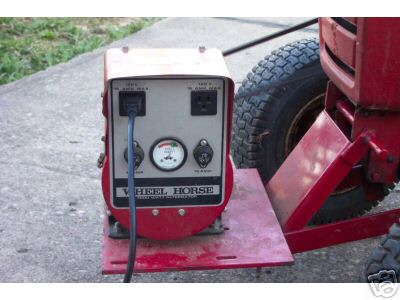

The generator could be done out front, like this Wheelhorse attachment.
