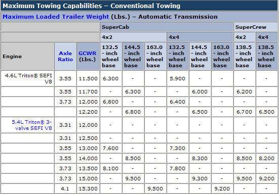

Here is the Ford chart, you listed the tow capacities without the 4.10 gears. As I said before it can tow 9,500lb trailer and has a GCWR of 15,300. If you build it to tow it comes with the class 4 hitch. Enough truck for the 4210 and trailer with a fair ammount of attachments.
I am not arguing that a1/2 ton is better than a 1 ton, just that a 1/2 ton is more than reasonable to tow that type of load.
I have a 1 ton diesel, dually but owning a 4210 and a few attachments would NOT be enough reason for a 40K expenditure to tow it a couple of times a year as I suspect will be the case with this poster.
The 1/2 tons or even properly equipped full size SUVs make more sense for most users than the suggestion that every compact tractor owner needs a 1 ton to tow it safely to the shop or to cut a buddies lawn. Many people are spending more than they want for the tracor if they need a new truck to go with it /forums/images/graemlins/shocked.gif
If you have OTHER uses as well or tow daily than go get the 3/4 or 1 ton and diesel but I don't think some guy with a 1/2 ton is under-trucked or unsafe when he pulls his little tractor. A guy once cut my pasture with a Ford 1720 and brushhog on a 18' trailer pulled by a 1500 Suburban. It looked and rode fine.
Sure bigger may be better but I think we have to take into consideration what the cost and benefit is. Is it really necessary to insist that one spend an extra 10,000 on a bigger truck when the smaller truck is all that is really needed? Heck 1/2 of these tractors don't weigh any more than 2 decent size horses. /forums/images/graemlins/grin.gif One of 5030's horses must weigh near as much or more than many tractors.
