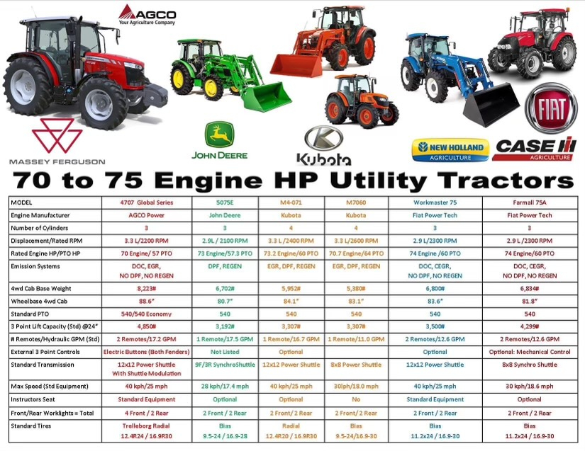

Kubota doesn't use DEF on either the M7060 or M4 which are both over 70HP. Not sure about Deere.
Thank you. I get a little confused on all the smog systems out there. Kubota M4 and 7060 uses DPF, EGR and Regen.

Correct, the bevel gear design does not reduce the turning radius the same way a planetary setup does. I do suspect it is not as strong as a planetary setup as virtually all other utility-sized and larger tractors have a planetary setup, while bevel-gear setups are seen in compacts, and unfortunately I have seen a couple of bevel gear MFWD setups which were broken.
Engines from about 26 through 74 HP have to abide by strict particulate, nitrogen oxide, hydrocarbon, and sulfur dioxide emissions regulations. It's not as strict as 75-600 HP regs, which essentially require an additional catalyst (SCR) with urea (DEF) involved in the chemical reactions, so this is why there is no DEF on under-75 HP units. I have seen no engine in this size range which does not have a diesel oxidation catalyst (DOC), if it has a DPF, it is actually a combination DPF/DOC unit- that table is incorrect, Deere and Kubota both do have a combination DPF/DOC unit. Manufacturers can either keep their exhaust gas temperatures high all of the time to use the DOC face to burn off soot, or they can use a particulate filter (DPF) to catch the soot, generally run the engine at normal exhaust gas temperatures but then periodically run at high EGTs to burn off the trapped soot in the filter. Most manufacturers use a common-rail electronically-controlled direct injection engine for 26-74 HP Tier 4 unit, although at least one smalelr one does not, or did not. Some use EGR, some do not. CNH and Kubota use EGR in this size of engine, Deere does not.
