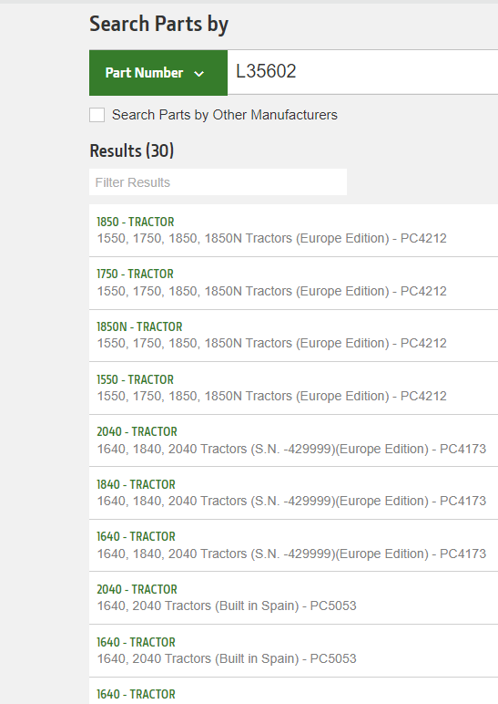

It appears from researching JD parts utilizing part # for main MFWD axle housing that 30 utility models utilized same housing. No MFWD were sold at dealership where I was employed so my knowledge of MFWD tractors is very limited
