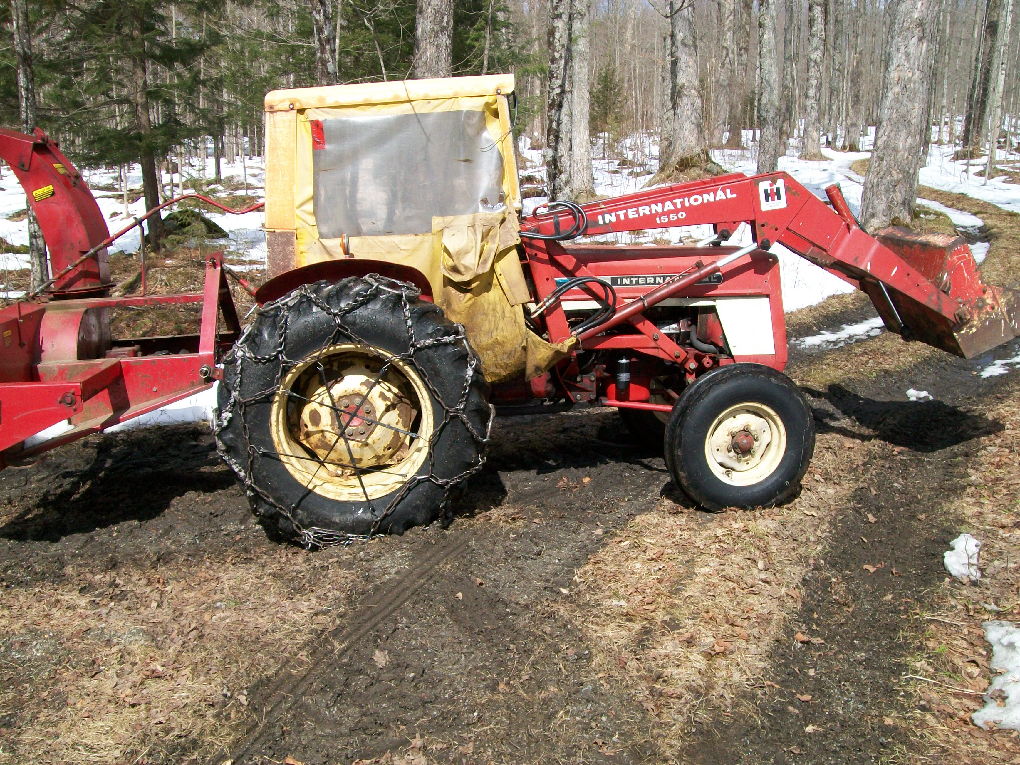

Received the valve wed from agkits.com and it's the right valve . They drop ship from a company called reliance power . You need to b a dealer to see parts they sell or to buy from them . With any luck it will be togeather next weekend

Thanks for all the help guys I put the head on and got it purring like a kitten . Hydrolics and 3 point hitch work fine and I drove it around the block . Clutch could be adjusted and the brakes need work . I'm ready to start on all the small stuff now I know t runs good

Hi Terry,
I'm glad to hear you got it running. I'm curious why you needed new valves anyway. In your photo that tractor looks very well kept and I think you got a good deal on it. Do you know you may have a two stage clutch - half way down for changing gears and all the way down for starting and to engage/disengage the PTO? Here's a photo of my Canadian 444/U.S. 354.

That's the same tractor . Fellow in the shop told me the valve stems where worn on a tapper . The 4 valves cost me $340 then $294 for all gaskets and $280 to surface grind head and rebuild it then a boy $120 for all new ignition parts . I'm up about $3500 total now
