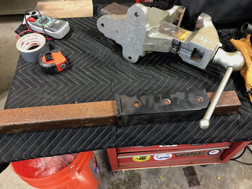

I was wondering about that too. That's why I was thinking that maybe you could mount the receiver on the edge for more solid support and just insert the up side down vise into the back of the receiver for storage underneath but I didn't word it very well ????
gg

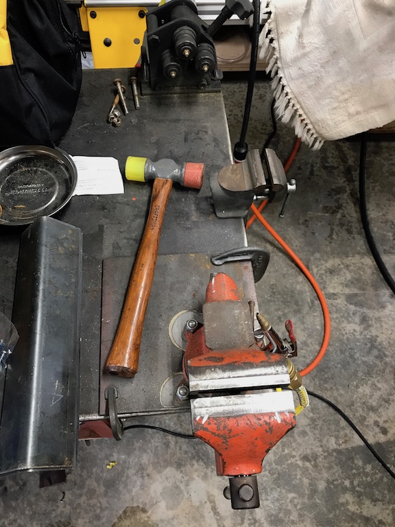

Aha... yeah flipping it over and inserting backside maybe? Definitely worth playing with... I think I have a loose receiver but it not worth buying another and give it a go this weekend. My smaller vices are currently clamped to my small work table 2ft x 4ft 1/2in plate mounted to an old salvaged Craftsman rollaway. The small vice and my ring roller are directly clamped. My medium sized vice is 'Click Bonded' to a small plate that I clamp down. This way I can move and clamp it other places and make my platform completely free of attached stuff on working surface if I want.

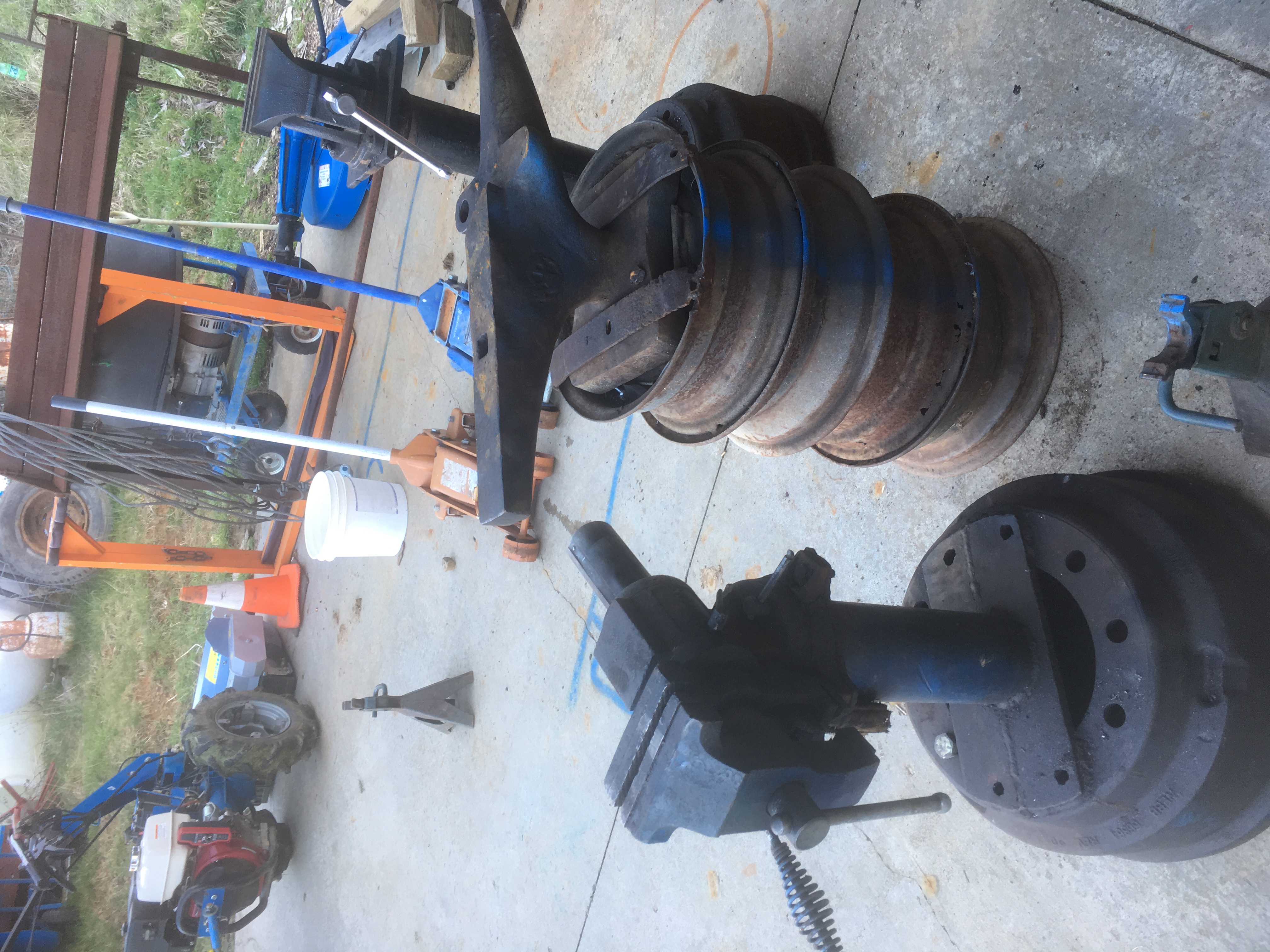

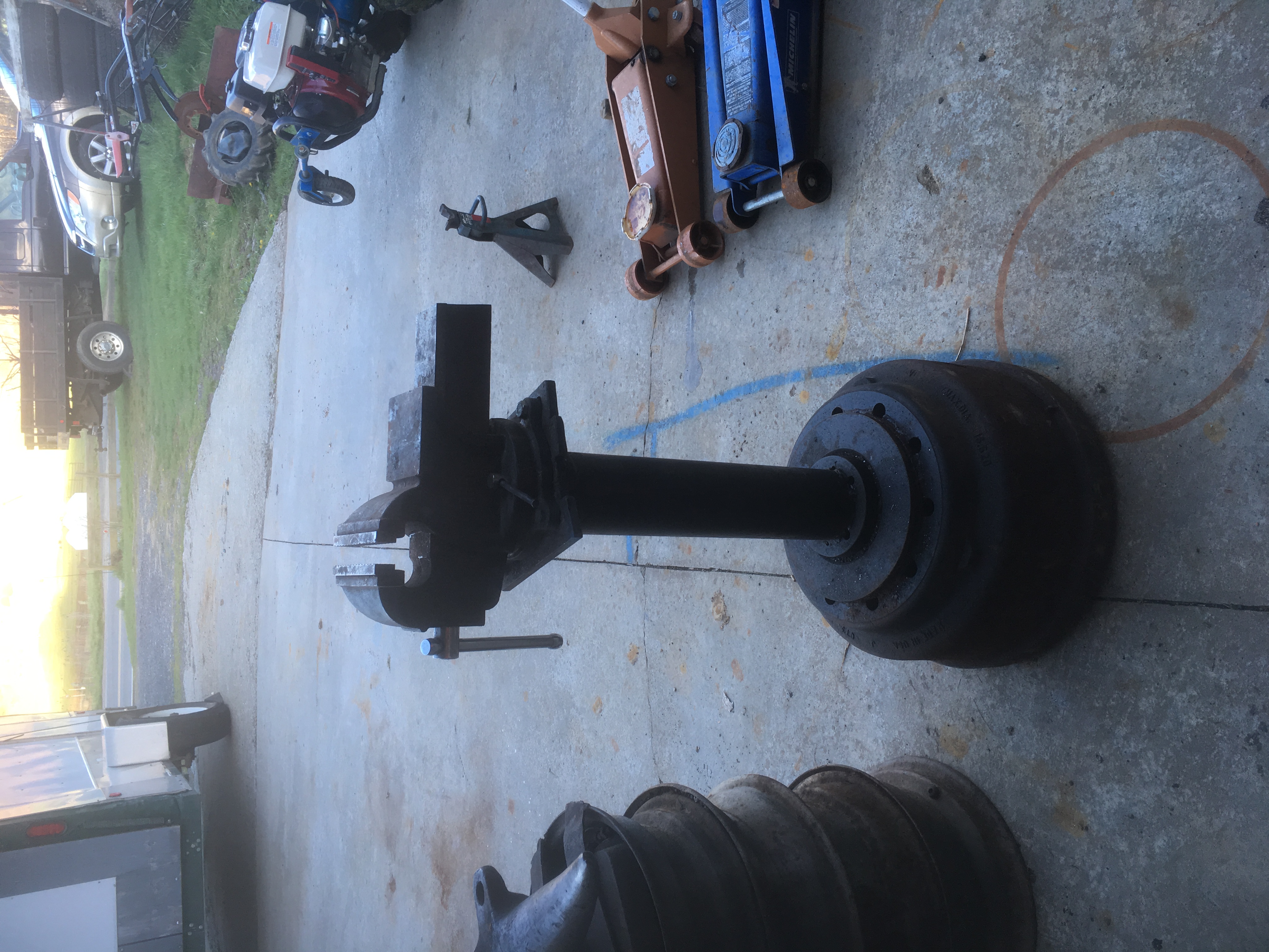

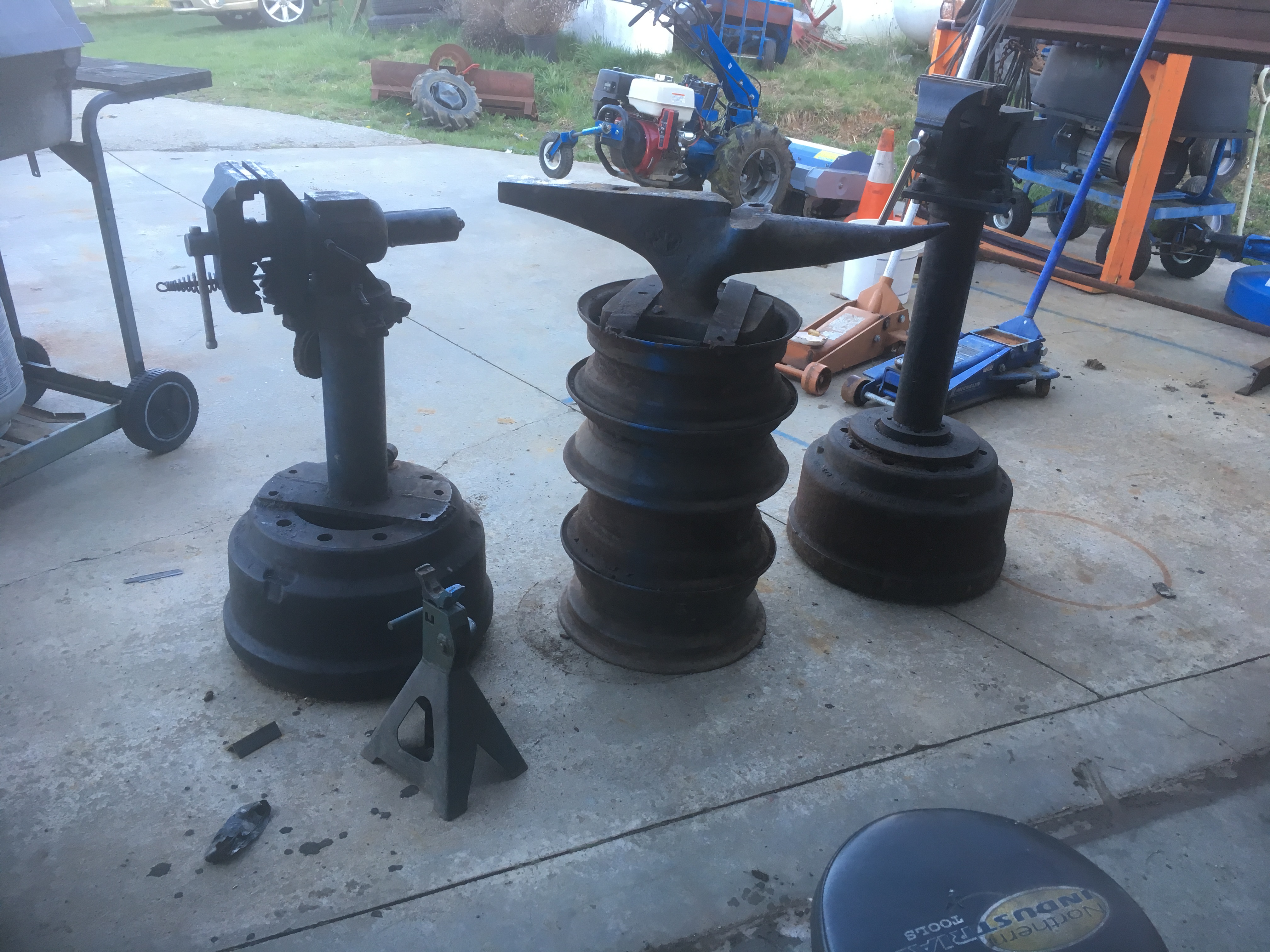

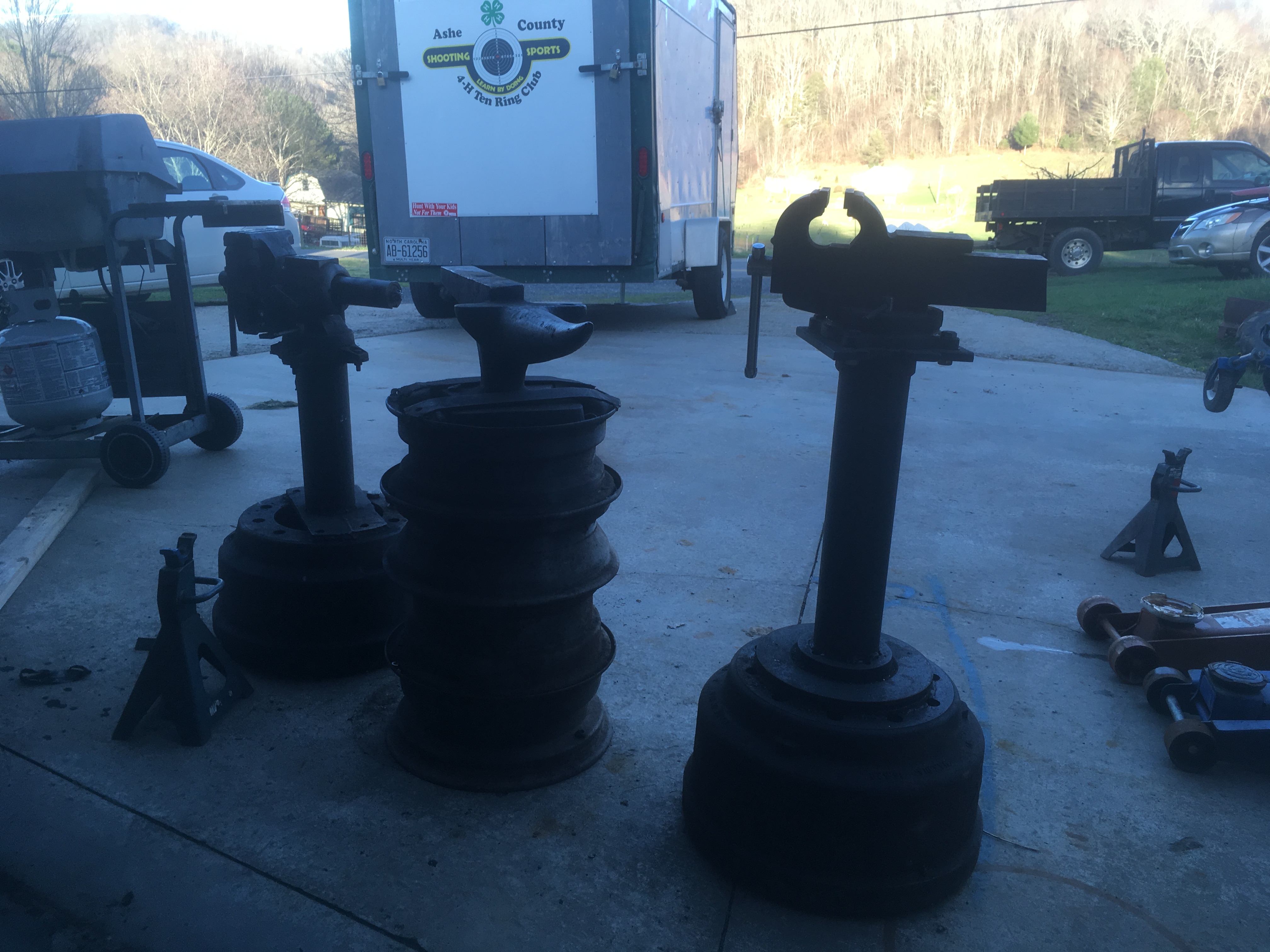

Here are pictures of vise and anvil. One vise base has scrap flat across the brake drum, the other has a rotor as the base covering the hole. Got the brake drums from a scrap yard, like most of my metal.

HF has a start, if you don't want to make your own.
To go under the bench:
3500 Lb. Step Bumper Receiver
5000 lb. Step Bumper Receiver
Vise mount:
Hitch Mount Vise Plate
Bruce
That's cheating... I just found a long piece of 2in by 1/8in and a hitch I was modifying for a different project. My problem is I don't think I have enough under table space. 11in by 24in is area to work in for concealed under mount. Dang vise is 60lbs. Not sure hanging off my table will make it too easy (top heavy) to flip my cart!

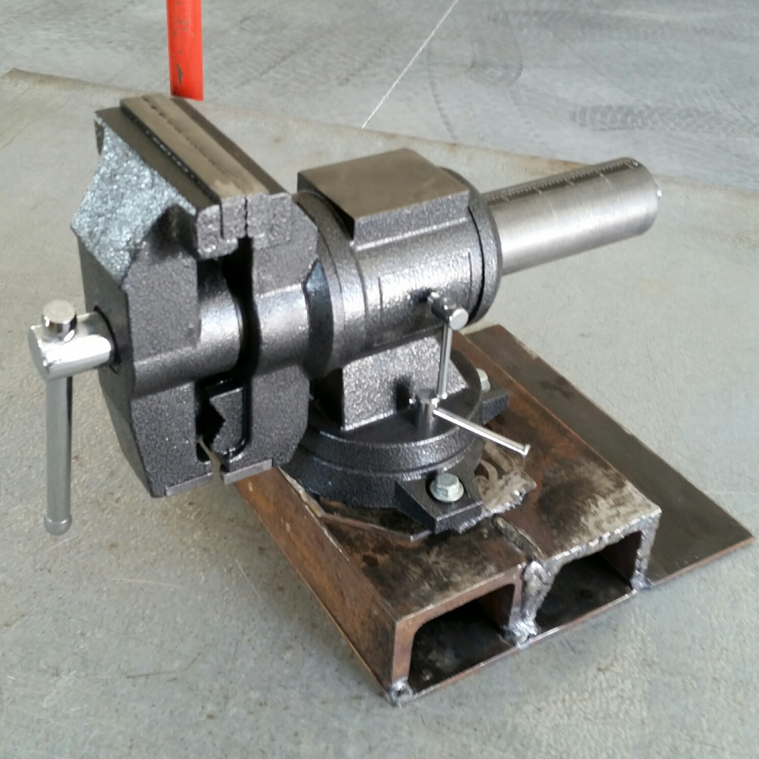

I sure like my mobil vice. Being able to put it in any position has come in handy.
   / Looking for vise attachment ideas. #26
Agree. I have something similar (a vice on a 18" long section of 10" wide channel iron). Heavy enough to stay put for most things. Like yours, the vice is mounted near the channel's edge so it can overhang for clamping long work, or clamp short work over the channel's footprint for hammering. Also handy when working at floor level.

I bought a couple of dozer sprockets at the local scrap yard (105lbs each) that I'm going to weld together, then weld an I-beam vertically and finish with a heavy flat plate to bolt a really big vise on. The vise is too tall to put on a normal bench, so it has to be on a dedicated bench, or stand built to the correct height. I plan to add a set of wheels on the back so I can tip it onto the wheels and roll it wherever I want. The vise is 200lbs, the stand will be at least 300lbs, so I think it's going to be pretty solid.
The local scrap yard had a bin of semi-truck brake drums that are a popular choice for a base...some folks fill them with concrete as I recall.
Here's the vise...a Wilton C3 which has 6" jaws, pipe jaws, and weighs right at 200lbs:
