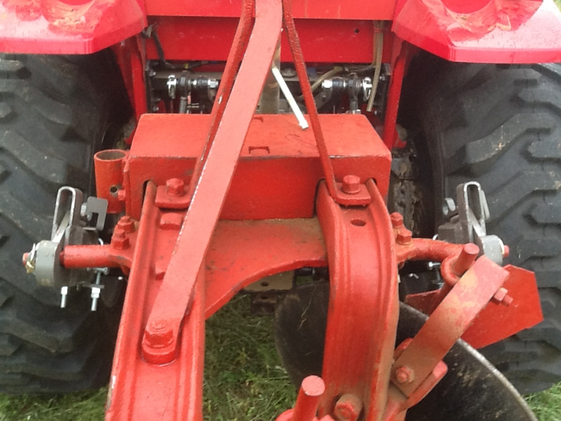

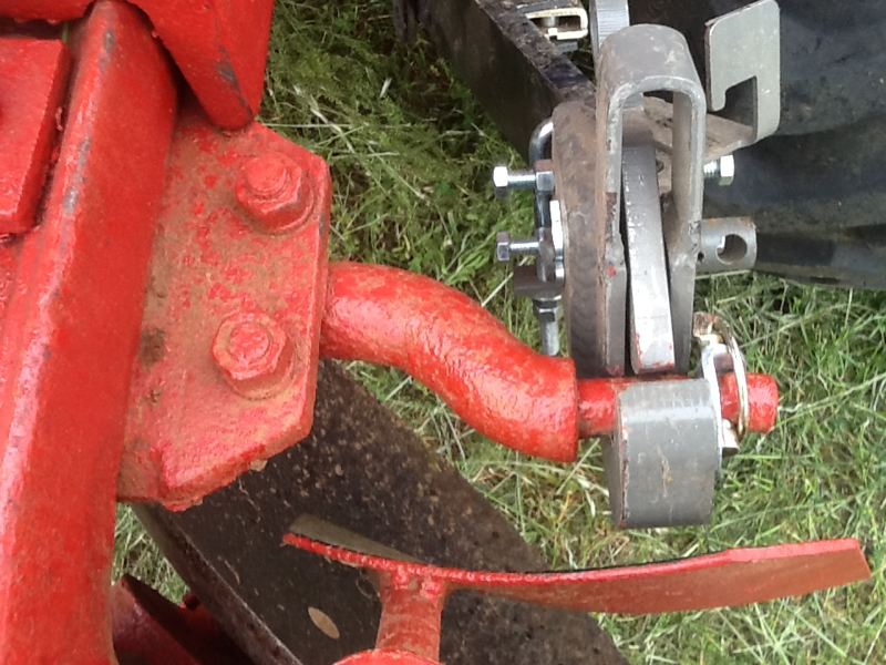

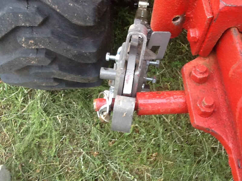

Okay, the Dearborn is pushing my tail end to the left. Are there any adjustments, or do I need to take a smaller bite?

Oh yea, here is a couple of pix.

Put a 6 inch block under your 2 left tractor tires, adjust the plow to run level with the ground front to back with your top link and level with the ground right to left with your tractor leveling arm crank on the right rear. After you make a furrow, fine tune adjust the plow in the same way (just wont need the blocks under the left side) The front disc should be taking about 12 inches. Spacing on the tractor tires should be pretty close to 24 inches from the center of the draw bar to the right rear tire inside rubber. If not close to that, adjust the track width of the tractor or slide the plow some on the cross draw bar to reconcile. Ken Sweet
