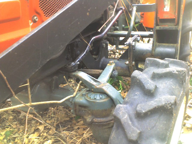

Wouldn't that be nice if the wheels were the steering problem -!!!! I won't get my hopes up because it's not my tractor yet, but I'll pass along the info and swap them back if I take delivery. The owner states no rhyme or reason to the problem - just yanks out of your hand every once in a while, then straightens back up. ??? He did state there is no muffler, but I had planned on running one parallel with the ground with a turndown at the end like a Kubota. Would that be enough to keep water out? I have a welder and a grinder so I can do all sorts of damage. Also considered making my own ROPS. Advisable? Anyone done it and have advise. I've prayed about this deal so much that I have to leave it in God's hands now. If he wills it, I'll have a new tractor. :D Thanks again guys! Let me know if you notice anything else!
I also doubt that is the problem, although it would be a major added leverage for any ruts or uneven ground to take revenge on the steering linkage. with them wide the tires are not just pivoting around a point, but rather rolling around an arc and the distance of the radius of the arc is the increased leverage that the tires have. I know that it does not take that much to make the tires try to turn on their own when the tires are normal.

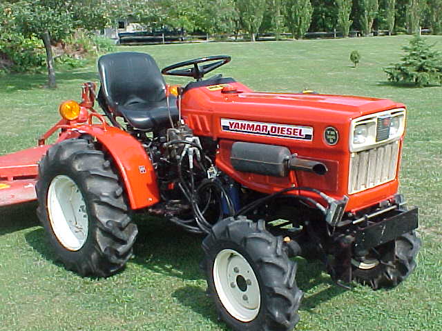

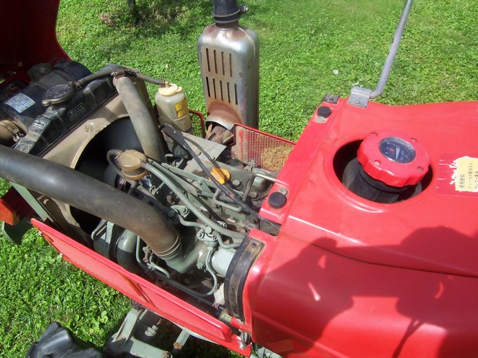

The actual Yanmar muffler can be horizontal. The exhaust flange is a square so the mount can be rotated 90 degrees and bolted back on, like in the first pic below. This is of a 186, but it is possible on the 1510 also. California has a muffler like this on his 186 also.

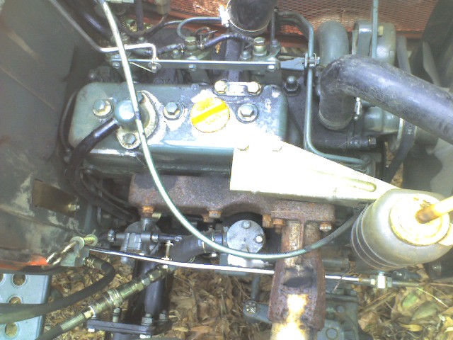

It looks like the loader install got the hyd directly off the pump and uses a QD. I would be afraid I would get in brush or something and the QD would come disconnected and result in one ruined pump. NEVER start or even run the starter with that QD disconnected as serious damage can result from the dead head situation.:eek:
I also do not see the Thermal Start cup? :confused: It is the translucent plastic bottle beside the radiator hose in the second pic below. There is a larger bottle which is the overflow for the cooling, but the one I am talking about for the TS is below the radiator hose in the pic.

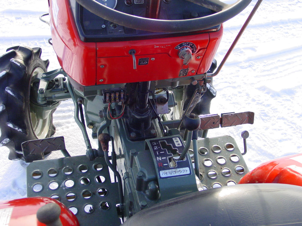

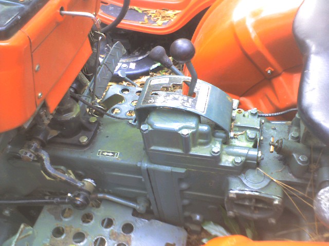

Third picture

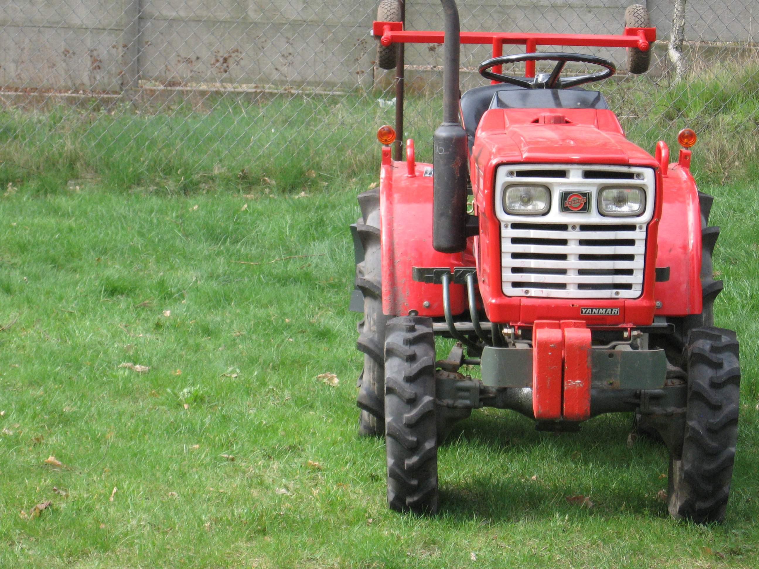

The 4 wheel drive lever is way too far forward and down compared to mine and others when the 4 wheel drive is engaged it is forward, but not to that extent. Compare the relative positions of the lever in this picture to the one you posted pictures of. The lever with the red knob on the left of the tunnel is the 4 wd lever.

If I were selling that tractor I would fix it first. You could be paying top dollar for someone elses mess. The reversed wheels are not the problem but they very easily could have caused it.

I also do not see the Thermal Start cup? It is the translucent plastic bottle beside the radiator hose in the second pic below. There is a larger bottle which is the overflow for the cooling, but the one I am talking about for the TS is below the radiator hose in the pic.
Good spot on that. It looks like the bracket that holds the TS cup is also missing. And since the spring that returns the decompression attaches to that bracket, it is also missing. I guess that is why the decompression seems to sticking out so far.

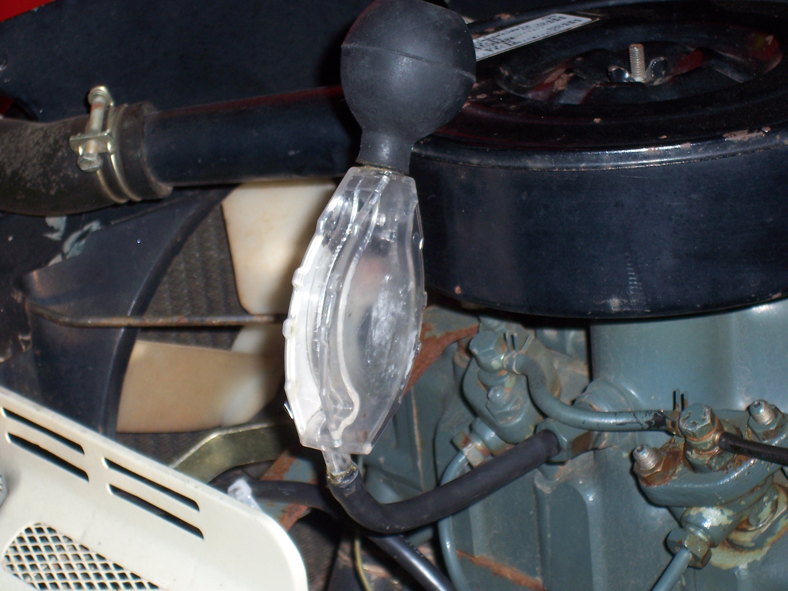

I'm not convinced this model needs a Thermostart. My YM186D starts instantly on the first cylinder to hit compression, in any weather I've tried, down to about 44 degrees. Thermostart used, or not, makes no difference at all. If your tractor is coming from a local source the previous owner may say he never needed it in that climate. I wouldn't bother adding unneeded complexity. (Or it might be like my YM240, more cold blooded, where after I filled it with biodiesel it needs the Thermostart in any weather to ignite the stuff on the first start of the day).
   / looking into buying a 151d - help! #27
Never used my TS and still don't need to. I posted this earlier how to make a TS> bowl self primeing on the Real cheap, works great HF. 5.00$.
