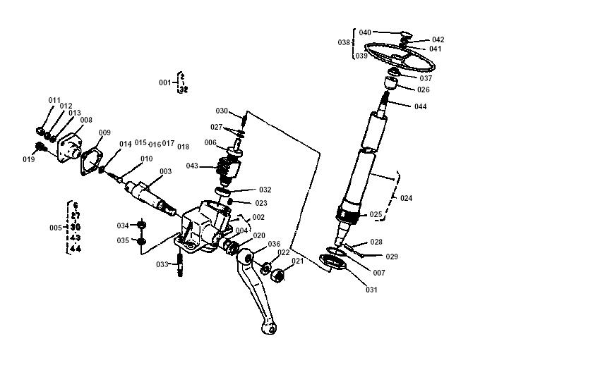

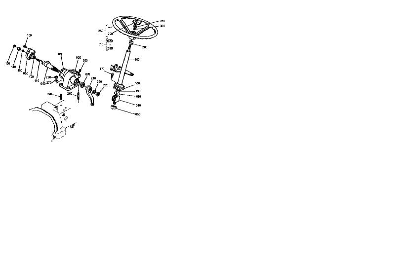

I've looked into lots of ways of doing this on my (previous) 7200 and my (current) 8200. There used to be kits available from kubota, they were apparently made of gold. There are manufacturers that make the same kinds of kits for other tractors, for ~$500+ but usually include a power steering pump. My 8200 has ports on the hydraulic block specifically for steering, so I'm not willing to pay that much. I thought of simply replacing the steering box with a power box from a car, but the manual box is backwards relative to where the inputs and outputs are on 99% of car boxes. Ford used to make a power steering 'assist' kit to go on the old trucks, which may be modified to work. Unobtanium though, as the old ford guys are always looking for them. The first generation of mustangs and corvettes also had the same kind of assist kit available, and I've been looking into those. Honestly what I'm most likely to do is cut the steering column above the box and put in a torque generator (Surplus Center Item Detail) If I can find one on ebay for cheap, it's the simplest.

True, but then the pitman arm will be ~10" further back and on the wrong side. It's not so much the direction of spin as it is the placement of the pitman arm 'above' or 'below' the worm gear. If you look at the 8200's manual gearbox, the pitman arm gear is 'above' or 'in front' of the input gear. : o|
Most cars are opposite of this: |o
This presents some mounting problems. ;)
First pic: B8200 steering
second pic: B7200 steering

   / looking to add power steering to my B7200 #18
That drawing is the same as for my tractor.
With the Pittman Arm I meant for it to be either pointing straight down or straight up at the center point. One or the other will give you the proper direction of motion.
