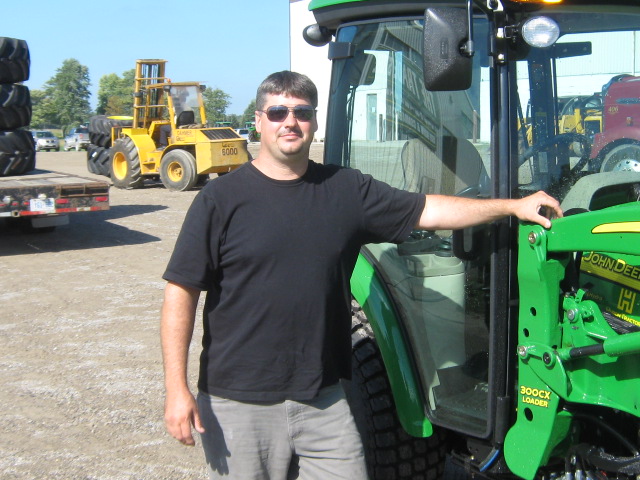

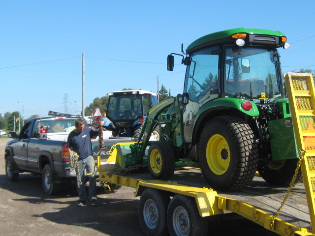

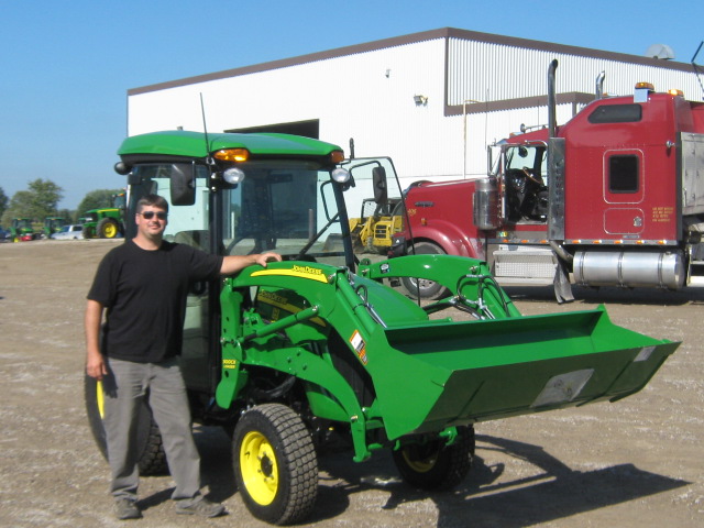

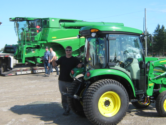

I picked up the 3720 today left at 6 am for the dealer about 2 hours east just outside of London. The tractor is really nice and I am really happy with it. I do notice that the turf tires are inside the fenders this is my only complaint. I will be ordering weel extenders and wheel weights. If it cost a few more dollars thats the breaks I want to feel confident in the tractor. Love the horse power - great. Here is some pictures of my morning :D

looks good. i owned a cab 3720 it's a great powerful tractor, always did what i asked it to - i have a jd with a jd engine in it now and in a lot of ways i liked the Yanmar engine the 3720 had. it started quicker and had self priming fuel - nice when you change the fuel filter. never had one problem with the 3720

Nice, congrats! :thumbsup:
