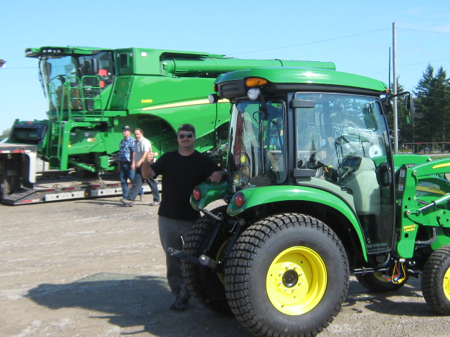

Oh my lord that is a great picture :D, my tires are not going to be quite that scary. When I picked up my jd3720 a brandnew s series JD combine came in for a farm show and a flatbed 18 wheeler came in behind it with just the tires. Those things were huge the guys said they had 12 hours labour to set up the machine for the farmshow this weekend.
You can see the new style s-series in the background notice how low the bed of the truck is to the ground.

That's actually a lowboy trailer. The front (fifth wheel) end of those types of trailers disconnect so the load can drive or be towed off the trailer. I see them around here on occasion, mostly hauling large equipment such as bulldozers.
In DP Property's pic, the front has been disconnected and the trailer is resting on the pavement.

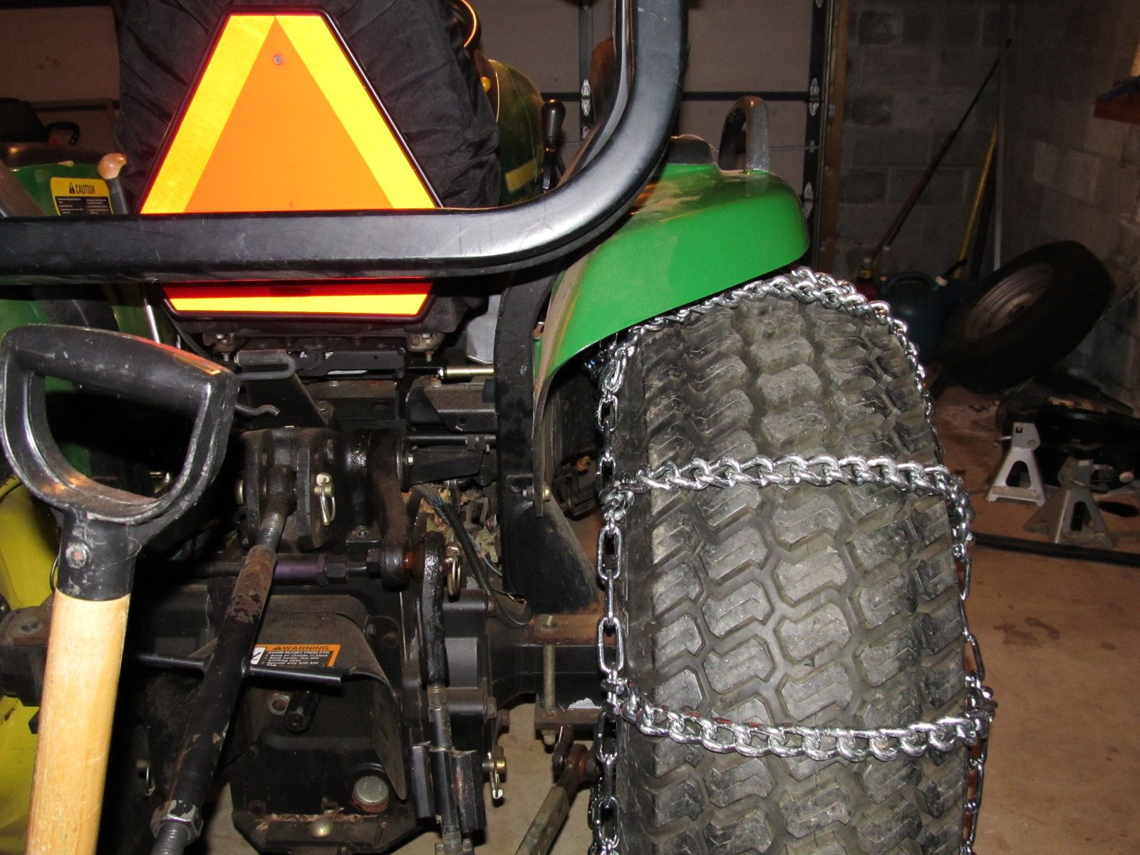

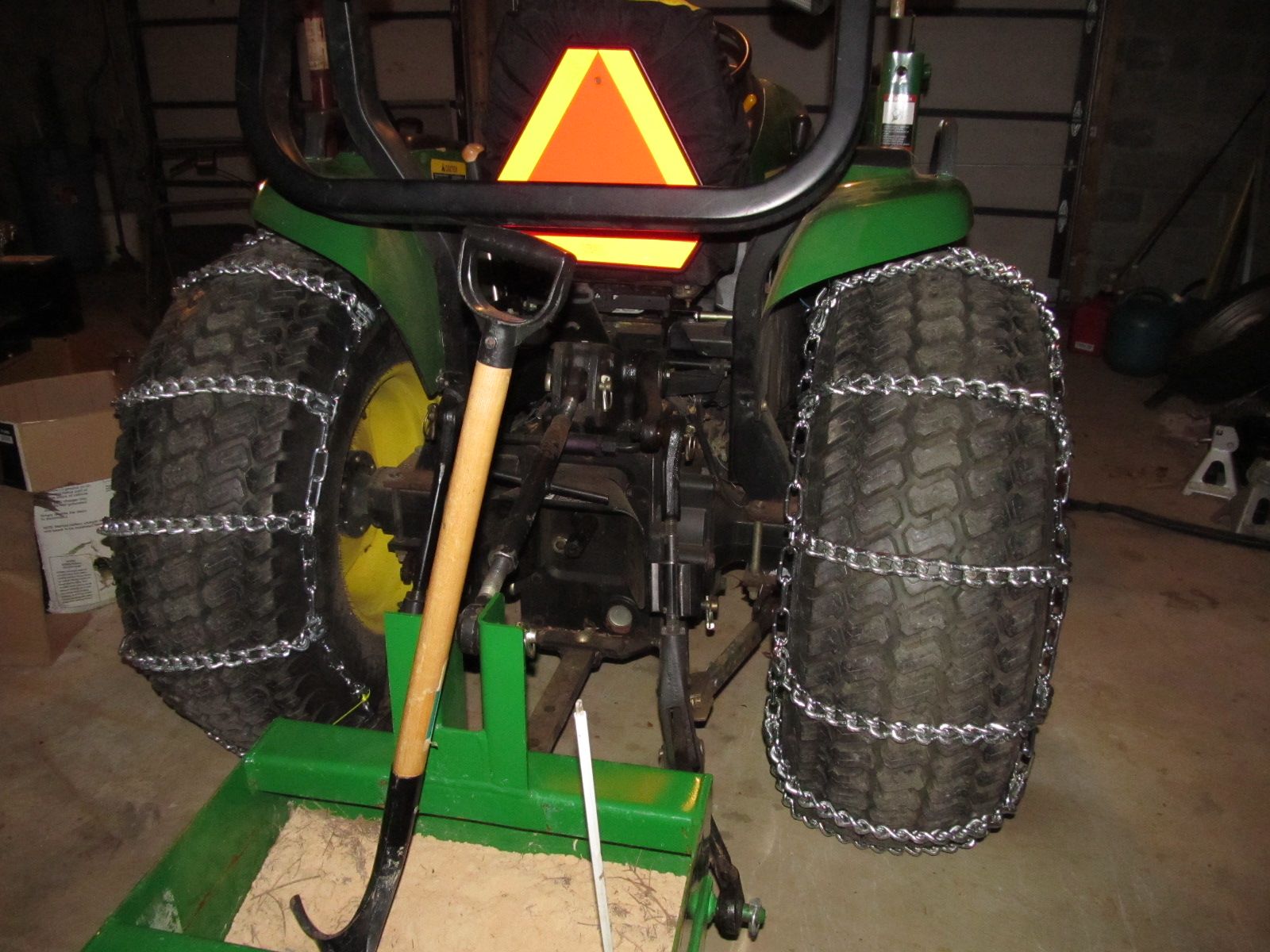

Since Rockgod asked about before and after pics, here's a couple of my 4400. Those are 41-14-20 turf tires. Note how close the sidewall is to the fender in the first pic.
BTW, as I'd written earlier, I got an increase of about 2.5" per side with my wheels. Before you go through the hassle of reversing or side to side swapping of wheels, measure the hub to rim offset to make sure it's worthwhile.

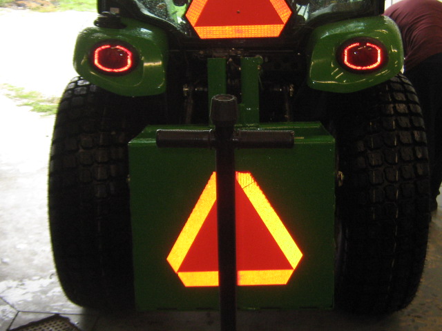

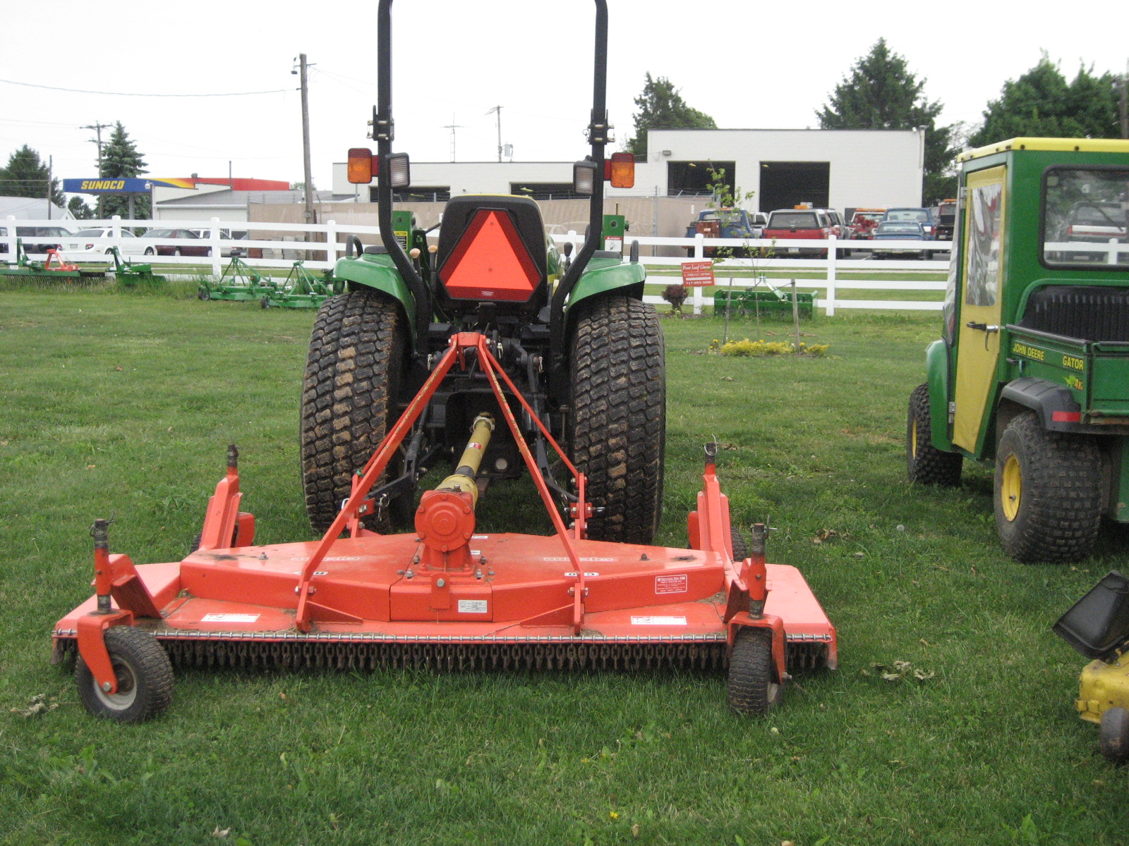

OK the job is done first thing this morning. When the machine was picked up from the dealer there was marker lines on the tire bolts. When we flipped the first tire we noticed they had little dabs of marker on the rim. This indicated that they at one time had that tire on and flipped before. This makes no sense why would John Deere put them on the safer way then remove them and put them back on the narrow way? The tec made a carefull inspection of the wheel hub and the rim he wanted to make sure this could be done without causing any damage to anything. He did notice on the rim when they come narrow the lip faces the outside of the rim and away from the the hub, once the tire is flipped the lip faces outside and around the hub nicely. (does this not make more sense this way)
I was helping him so there was not a chance to take a lot of pictures but I got a couple- first picture before and after. It was well worth it a big difference in feeling when I drove the tractor back home.

Hey Roy the truck had just pulled in it was still attached, but I think he may have still lowered it somehow? (if was not attached the truck was still looking like it was attached)

Yep, there's pneumatic or hydraulic cylinders that lower and raise the detachable part of the trailer.
If you'd have stuck around, you'd have seen the tractor (as in tractor trailer) pull away with the front section of the trailer.
