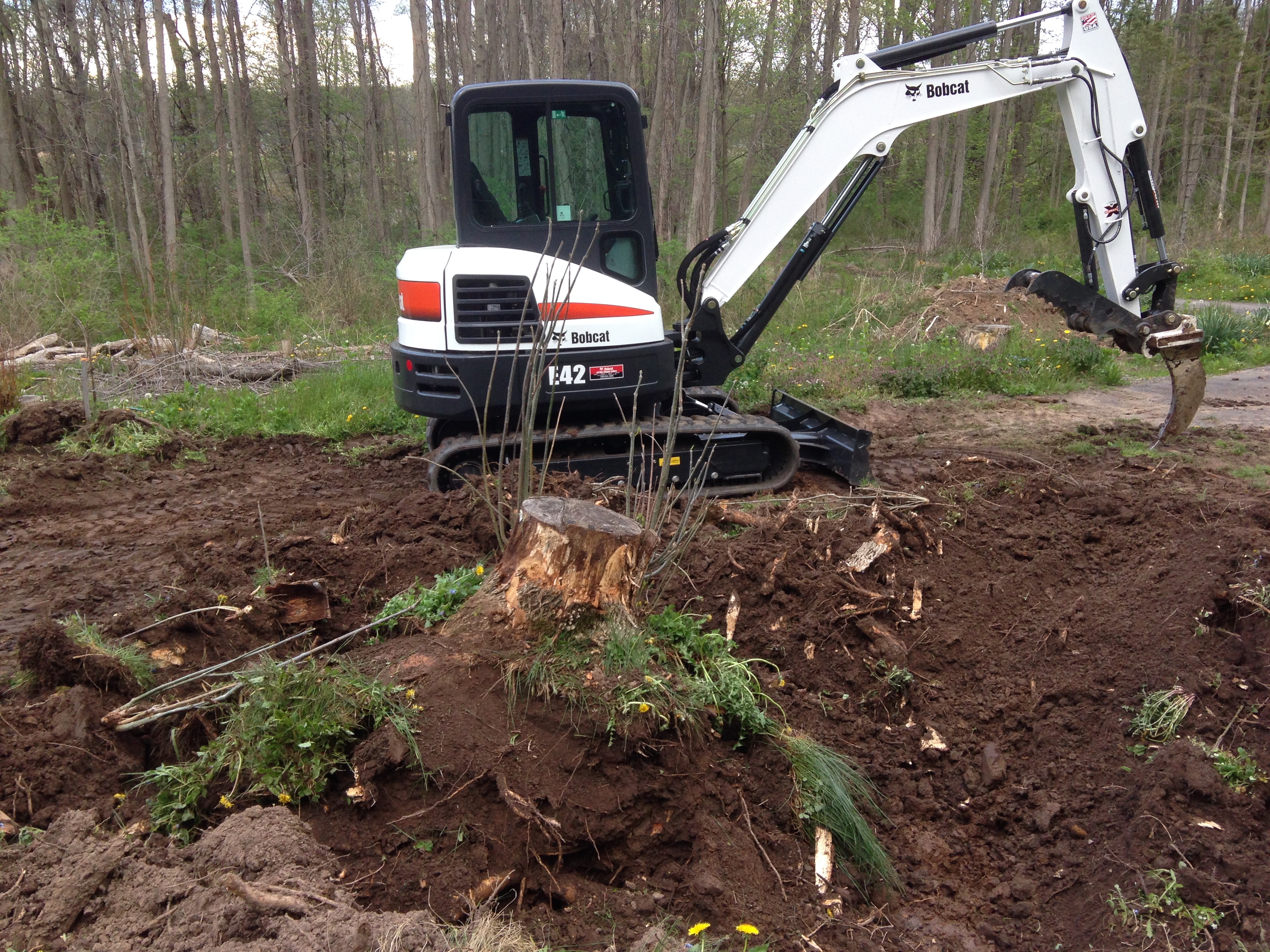

never got the thumb on the E32, there are times I would love it the issue is its 16 inch wide, if using a 12 inch bucket it will not go in the trench, I also use a breaker and ripper, the ripper would also have issues with the thumb
I have the ripper with the thumb and I love it. It’s the best for removing stumps by a long shot, you can apply all the pressure to a single point. You can also pick up small and large objects, and great for pulling roots.
Not too many stumps in my plans. Friend of mine has a Kobelco 140. He has a "stump fork" for his. It's basically like your ripper with two shanks. He bought it when he was clearing stumps on 16 acres of cut-over timberland.
