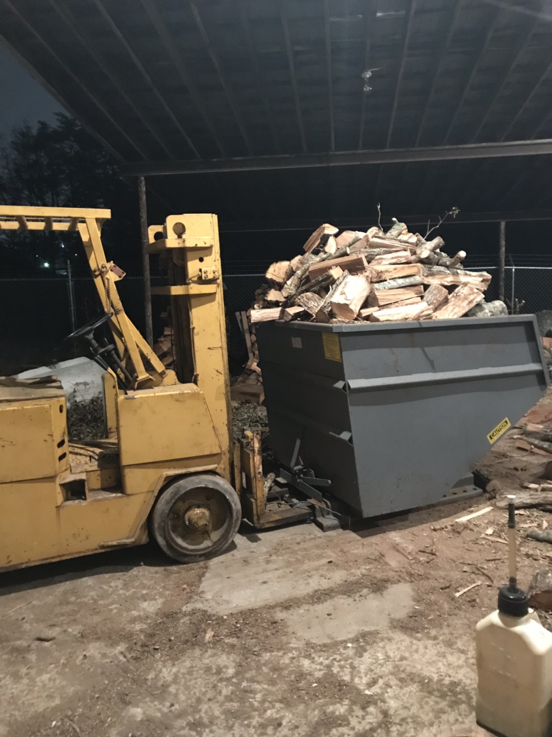

A cheap forklift is definitely the better way the move pallets. The catch is cheap forklifts are hunks of junk and are very limited off concrete. It takes no slouch of a tractor to move 2,000 pound pallets. I think you’ll need a minimum of a 824 series loader on a Kubota to do it. Here’s my cheap muscle. It’ll lift 10,000 but it can’t drive off concrete. A pneumatic tire one is better but they’re still nearly useless on dirt. They do pretty decent in gravel parking lots. IMG_7634.JPG

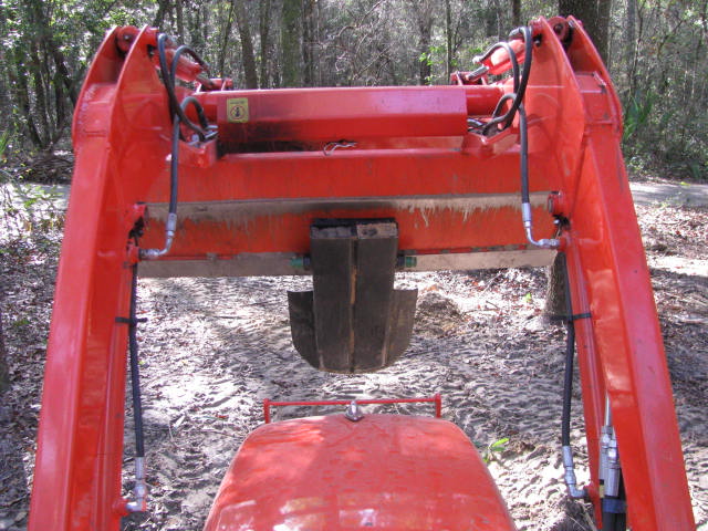

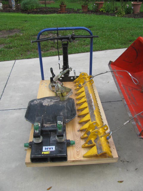

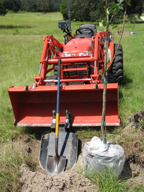

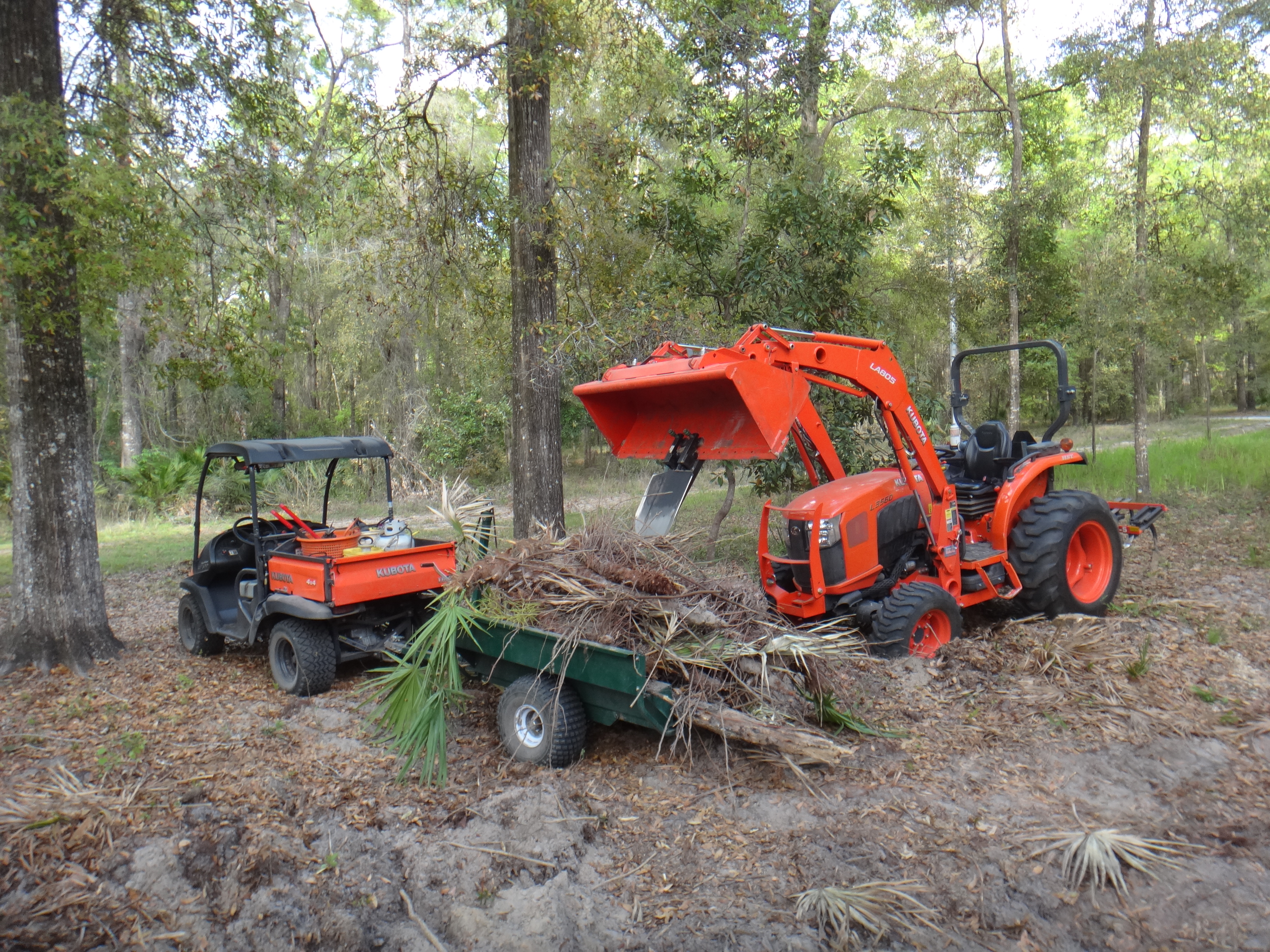

I totally unfamiliar with Buckthorn but I speculate either a $400 Ratchet Rake bucket attachment or
$450 Bucket Spade would serve you well. I use both regularly.
VIDEO: Ratchet Rake brush - YouTube
