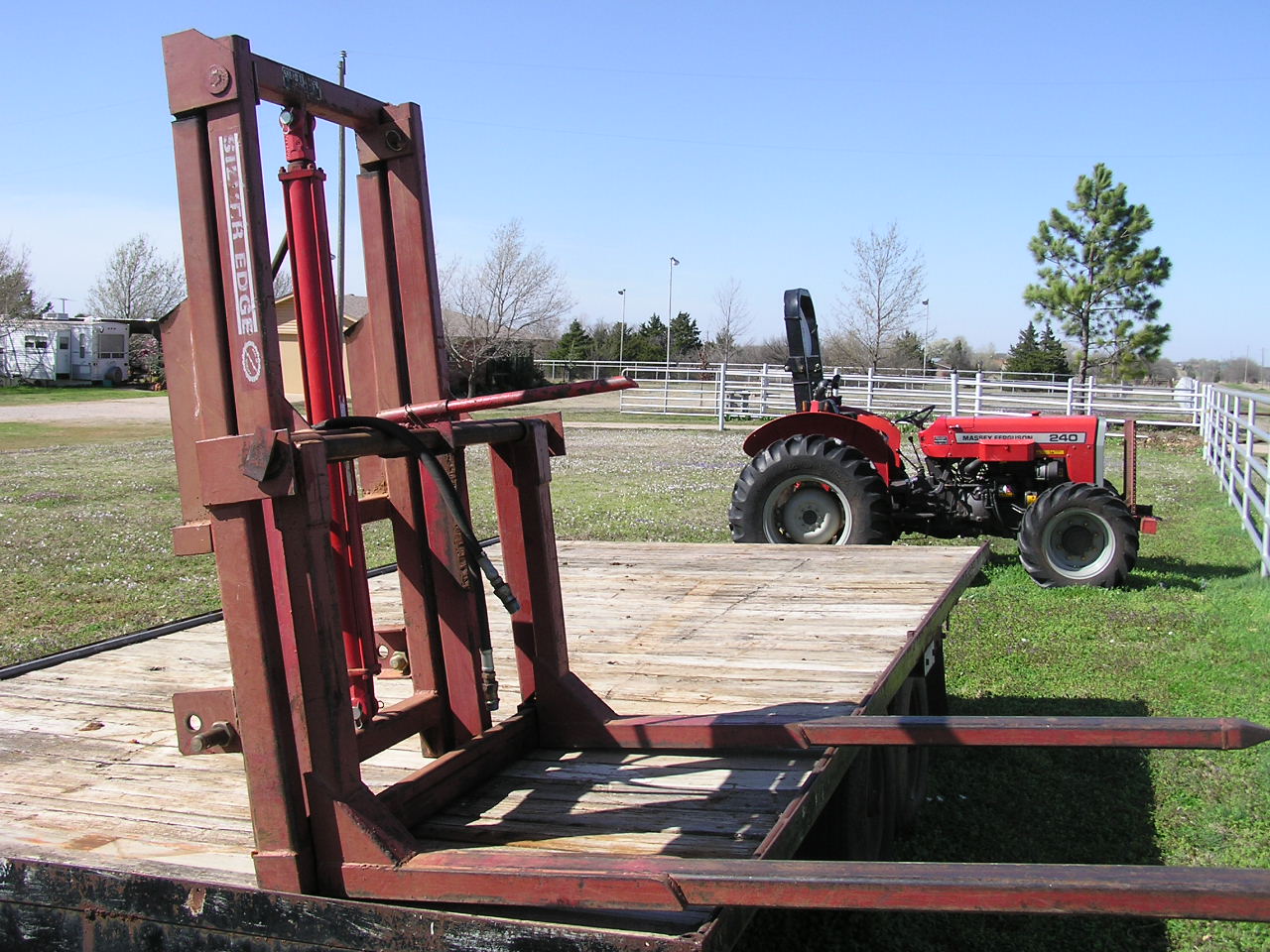

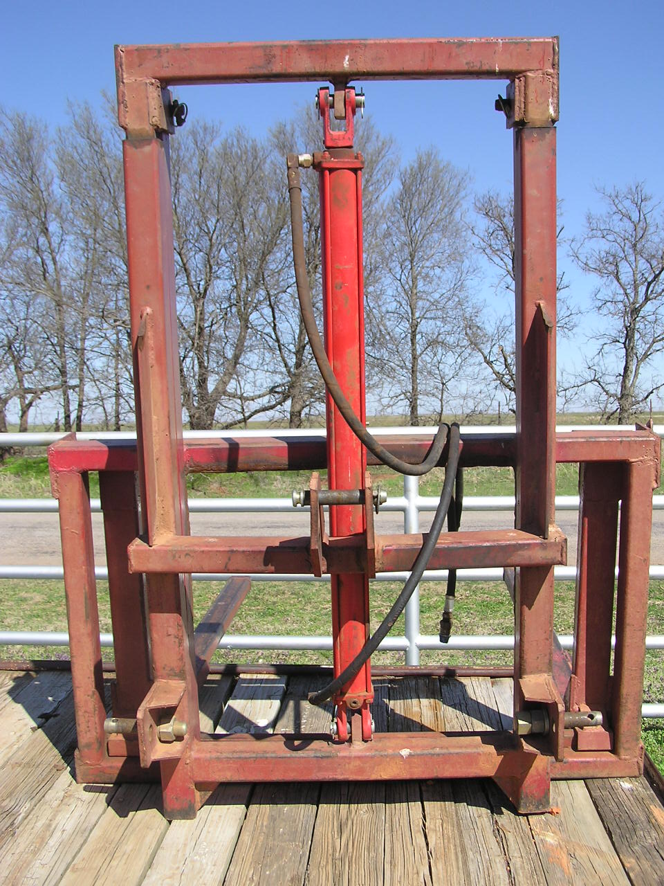

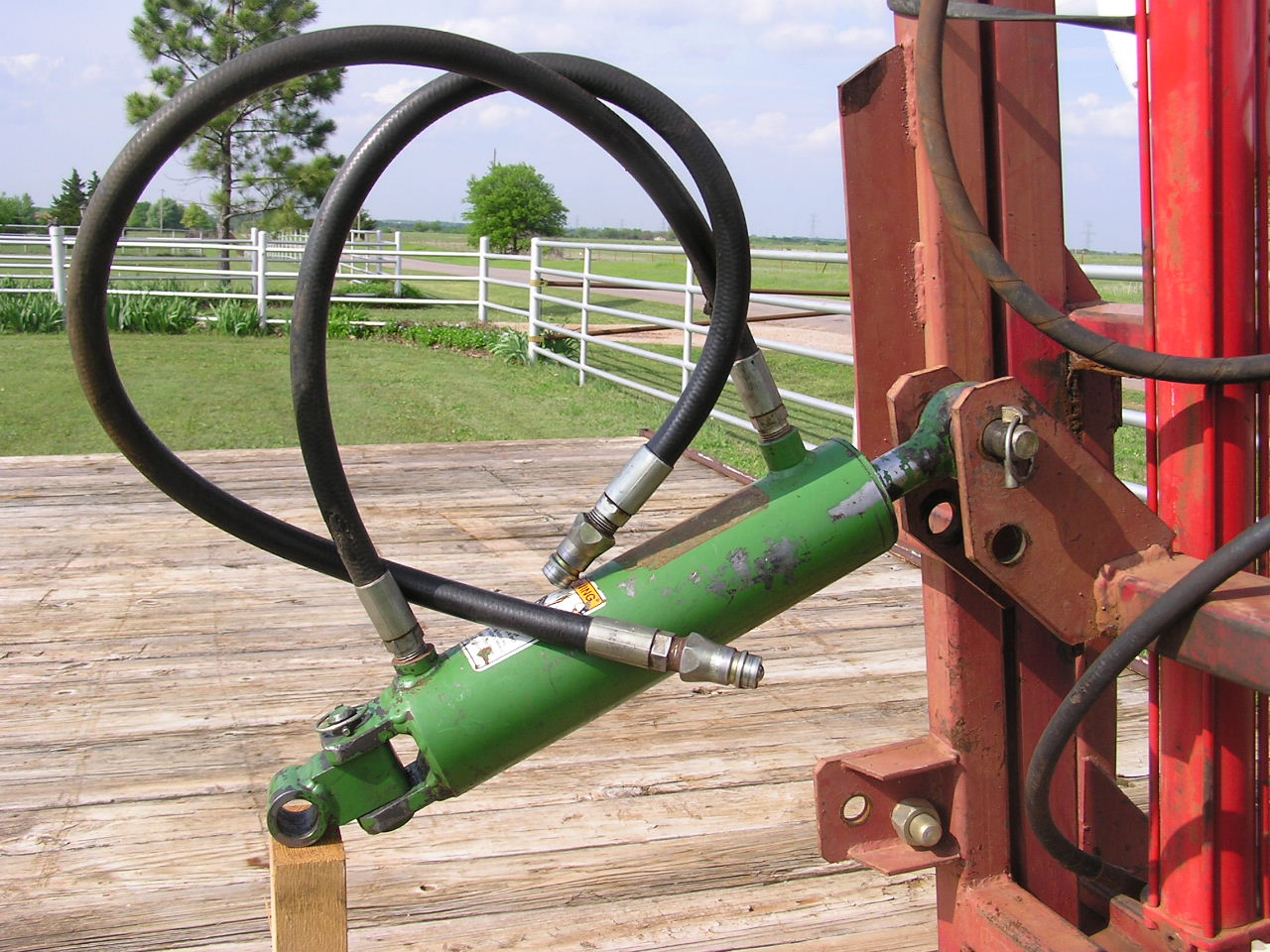

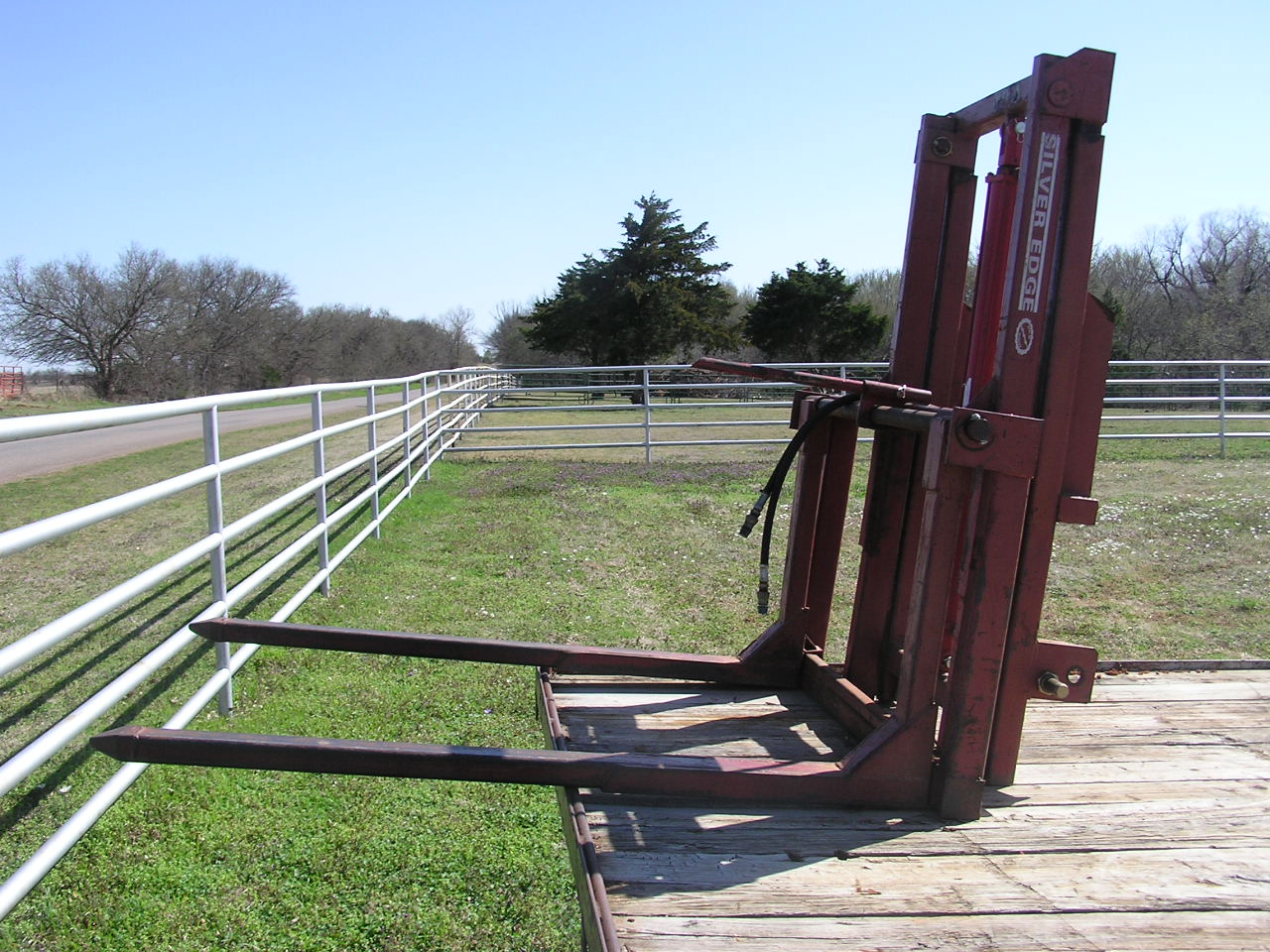

I had a 3 point forklift on a MF 240.
You have to have a hydraulic top link to change the angle of the forks.

It will take more than just rear forks to lift a ton.
From:
TractorData.com New Holland T1520 tractor information
3-Point Hitch:
Rear Type: I
Rear lift (at 24"/610mm): 1,635 lbs [741 kg]
Bruce
Yep. I read that TractorData.com data on the T1520 also. That's why I recommended that the OP keep that NH tractor and get a used tractor without a FEL that fits his budget and use the 3-pt hitch forks on it, not on the T1520.

Even with a rear mounted forklift, it looks like the T1520 is too small for the job. The load is 2100 lbs plus you have to add the weight of the attachment, plus there's no hydraulic top link. So we are into either replacing the T1520 and firklift with something bigger than can do both jobs or replacing the forklift with something that can traverse the steep gravel driveway.

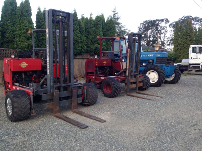

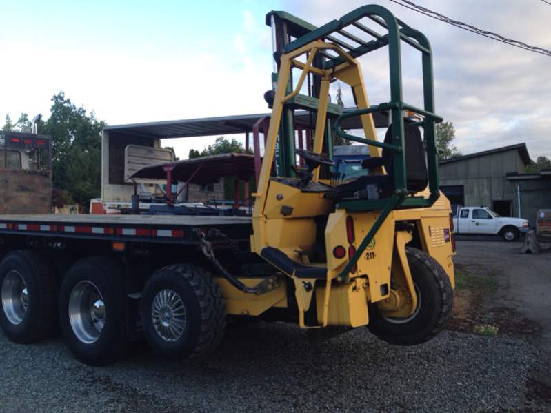

Memento, you might want to consider a used truck mount forklift. We have three here on the farm. The first two were purchased new when the economy was good as good used was almost non existent. When the economy dropped I picked up a third one used for $4500. I use it around the maintenance yard. It also goes out on rent two or three times a year for a couple of rock concerts and a beer festival. It's already paid for itself a couple of times over. Wish I could say the same for the other two machines. :( These are 5000# machines which would work fine for you. View attachment 436495
View attachment 436499 Terry
