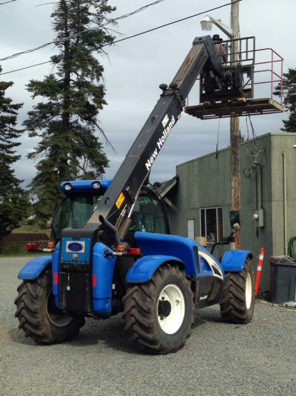

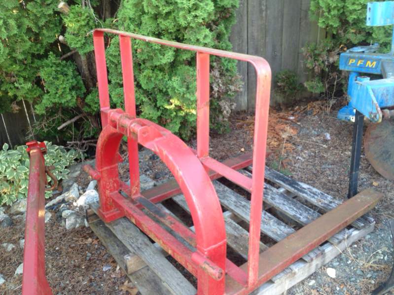

How about use the forklift you have to unload. Purchase an inexpensive 3 PT set of forks. Build a suitable backrest for it to stabilize your palletized of bottles and back up or drive down your steep drive with existing tractor. Terry image-550798464.jpg
Here' a pic of one of mine.

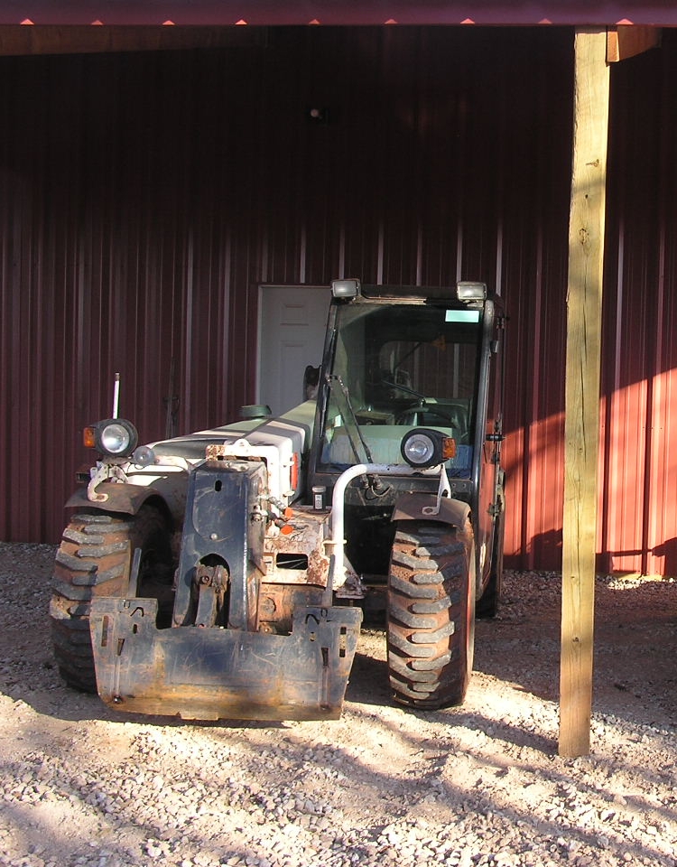

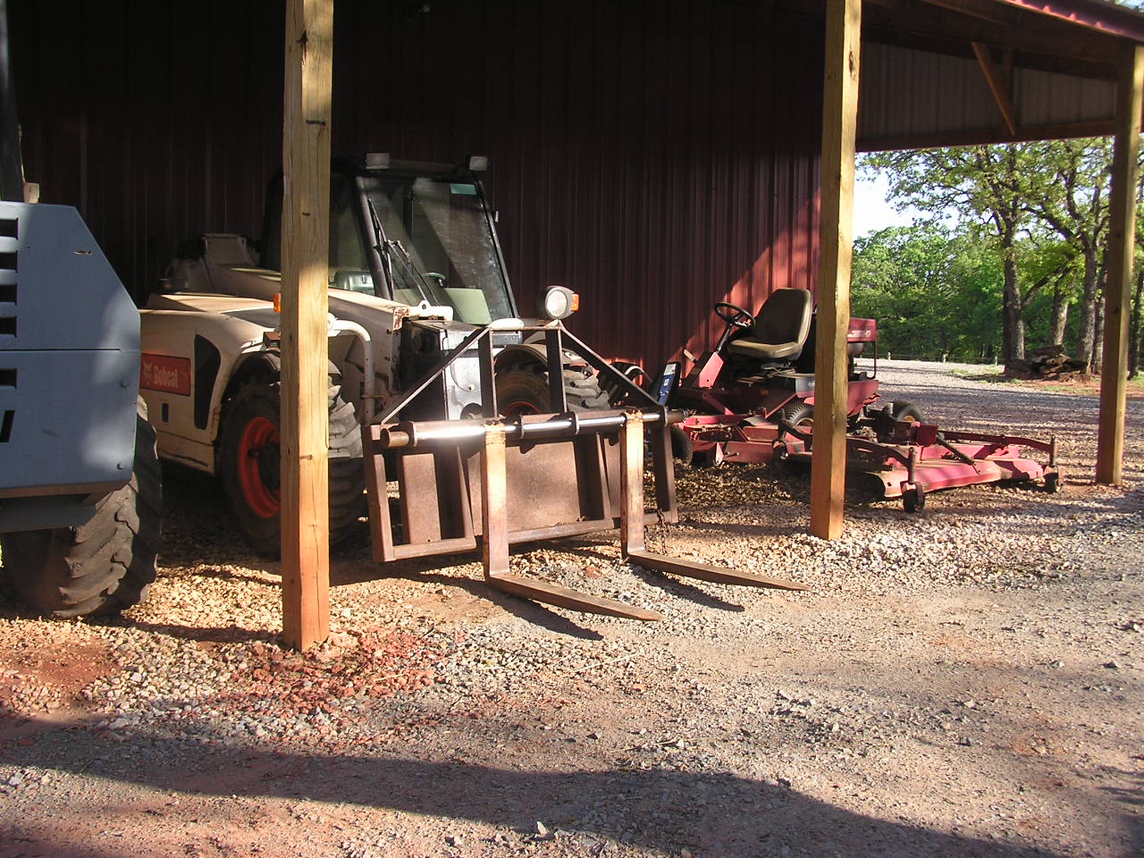

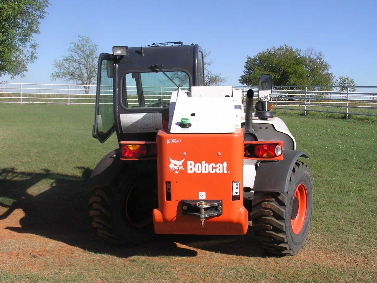

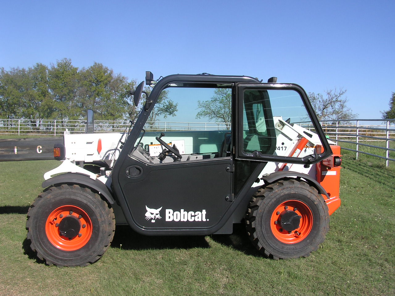

I don't know how big your forklift is, but my compact telehandler is 6' wide, 6.5' high and 13' long. It will lift over 5000 lbs. and run a snowblower on the SS Quick Attach. It would probably do everything that you are doing with the NH T1520.
attachment.php
attachment.php
attachment.php
attachment.php
And there are compact telehandlers smaller than this one. :thumbsup:
You call it a telehandler . . . But it looks like a lull with the multiple steer/drive capability (worm/all wheel steer/4wd etc.)
