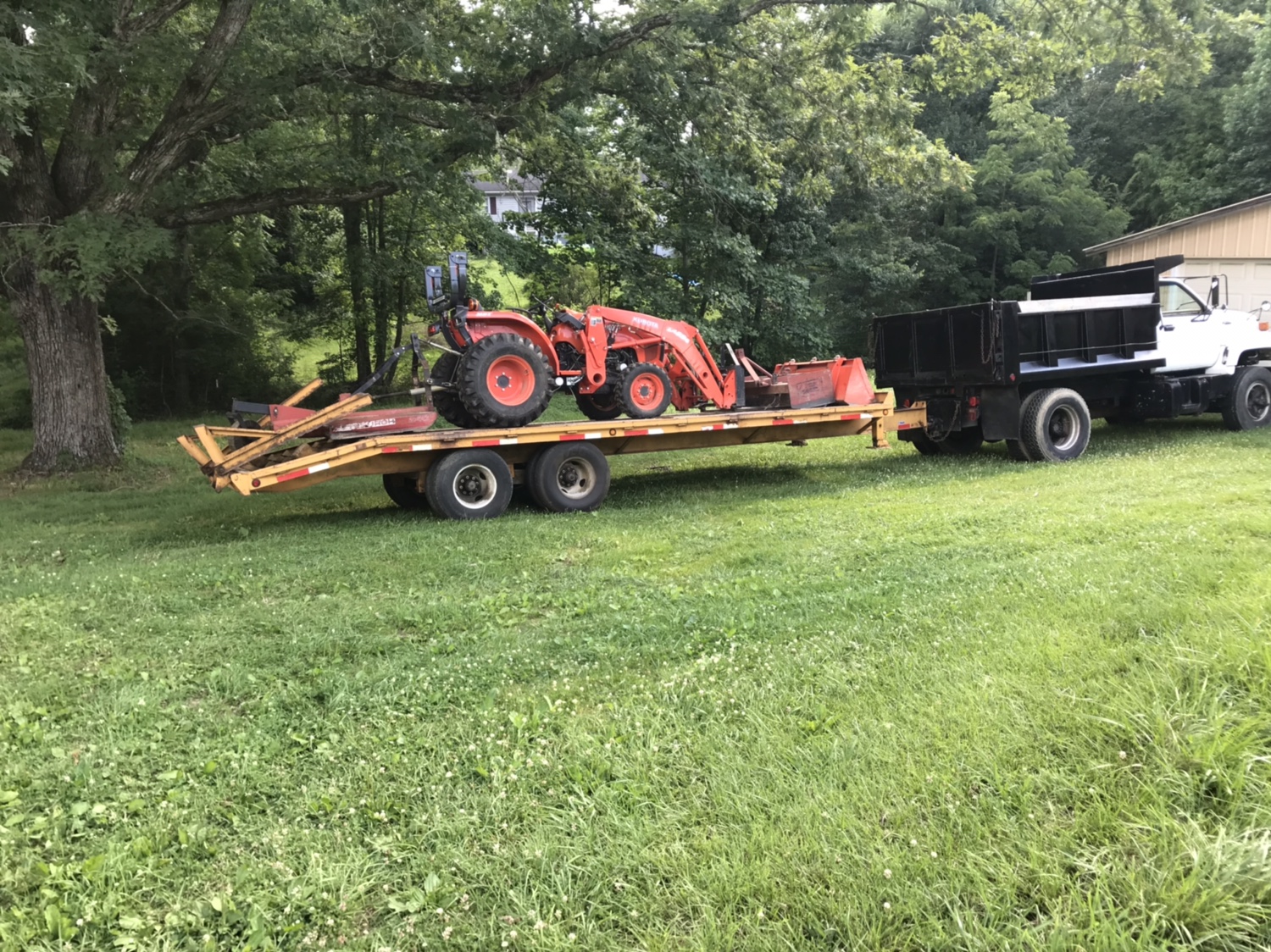

i expect people to come in here and say you need a 15k gvw goose neck and a 1 ton, but you don't.
