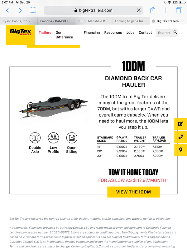

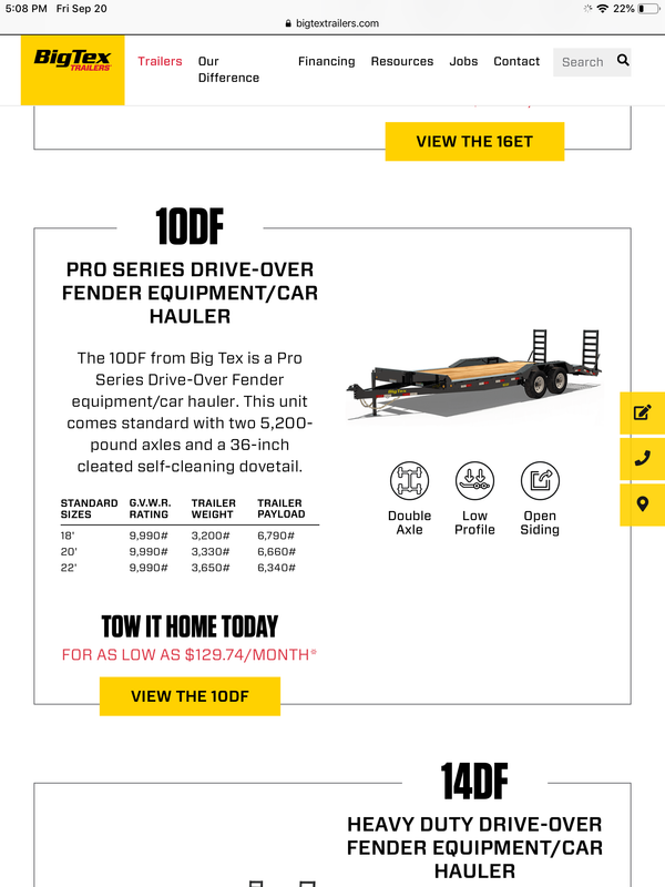

Here’s two trailer, for reference. I would go 22’, if I was doing my car hauler, again. I’m not pushing Big Tex, just using their examples because their site lists weights. For the record, I’ve heard they are good trailers, but I’ve never even used one, so I can’t recommend or dissuade, from them.
One is a car hauler and built a lot light than the equipment trailer. Both are “10k” trailers. A car hauler is probably the way I’d recommend the OP go, as they tend to be more versatile and he’s not going to be putting working miles in it.
Steel deck versus wood is a preference thing. They both have their advantages. I use a steel deck and love it.

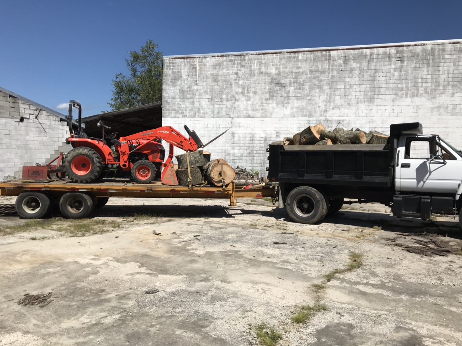

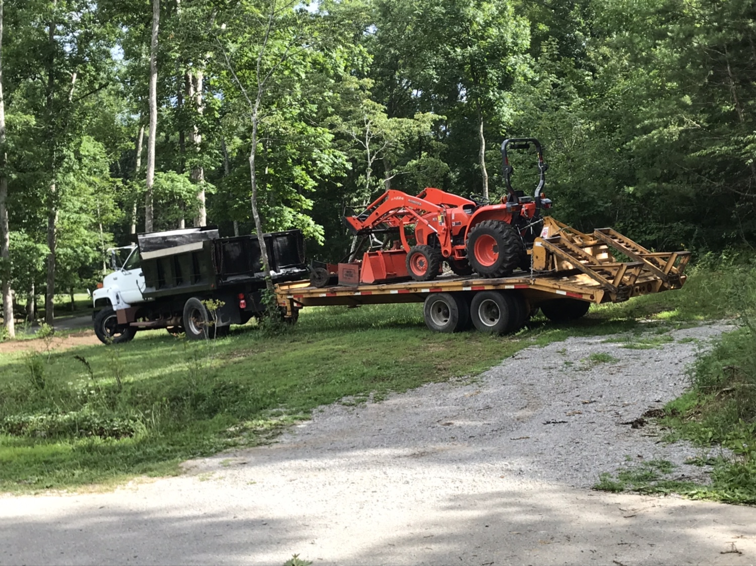

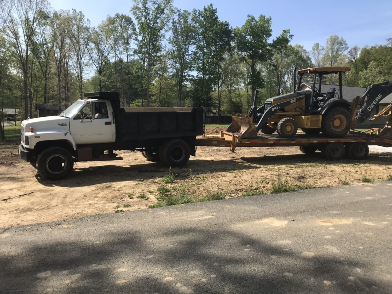

I’ve hauled that tractor on a 16’ trailer but you can only fit the one implement on the back. And if it’s a bush hog it sticks off the back. When you start adding other stuff on the trailer it fills all of my bigger 24’ trailer. And I didn’t really buy that truck and trailer to haul that tractor with. IMG_7369.JPGIMG_7027.JPGIMG_6825.JPG
