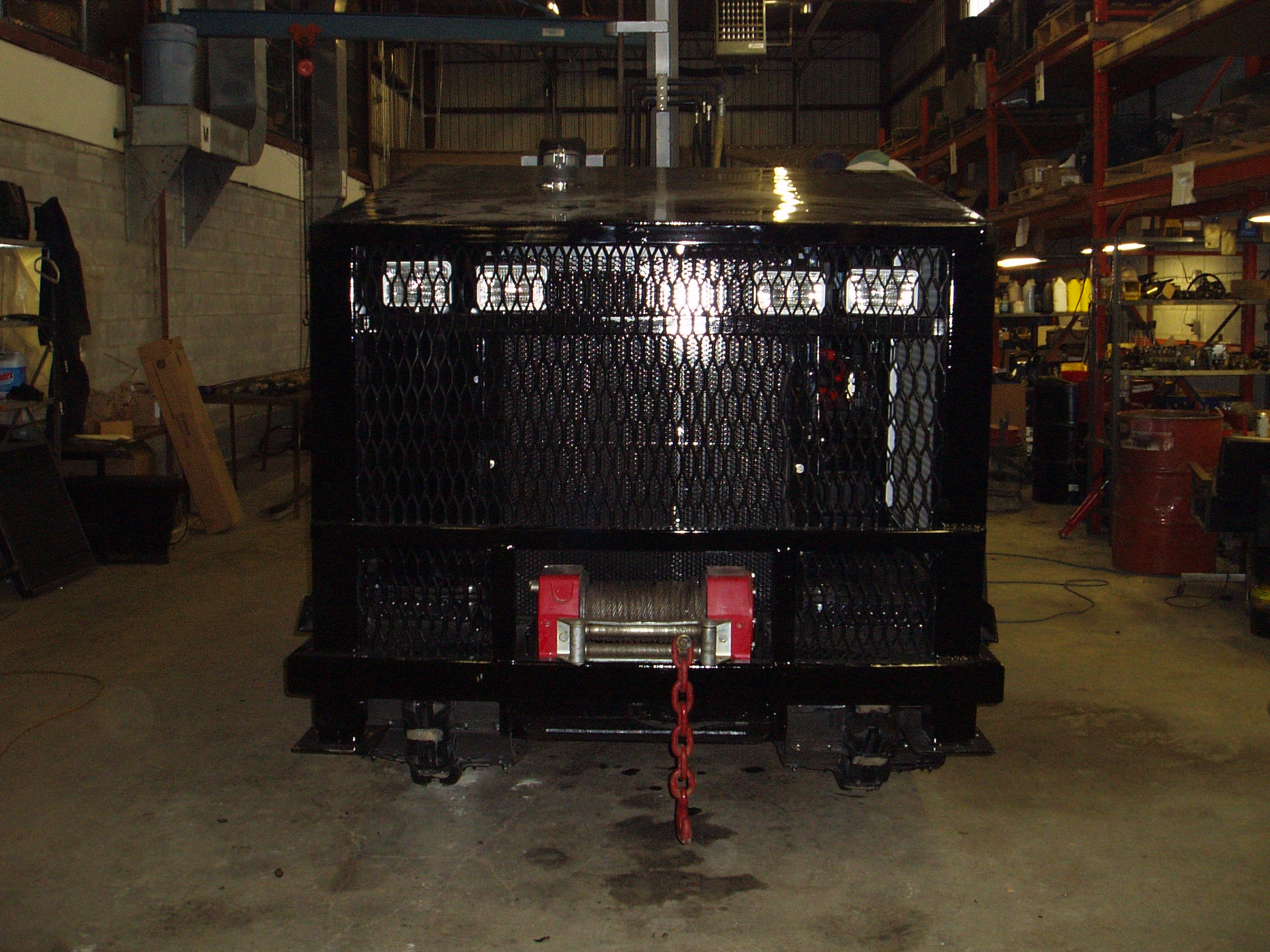

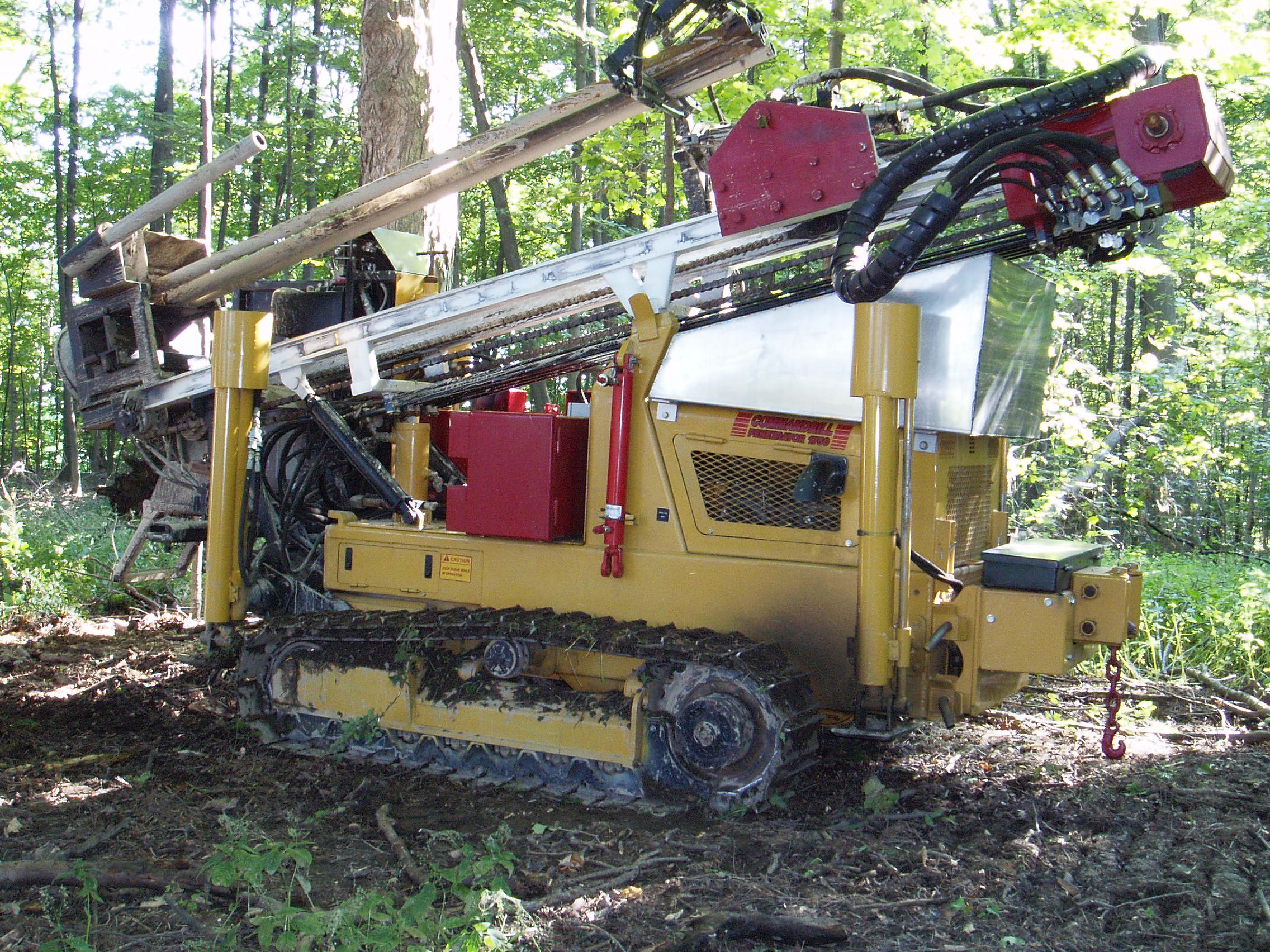

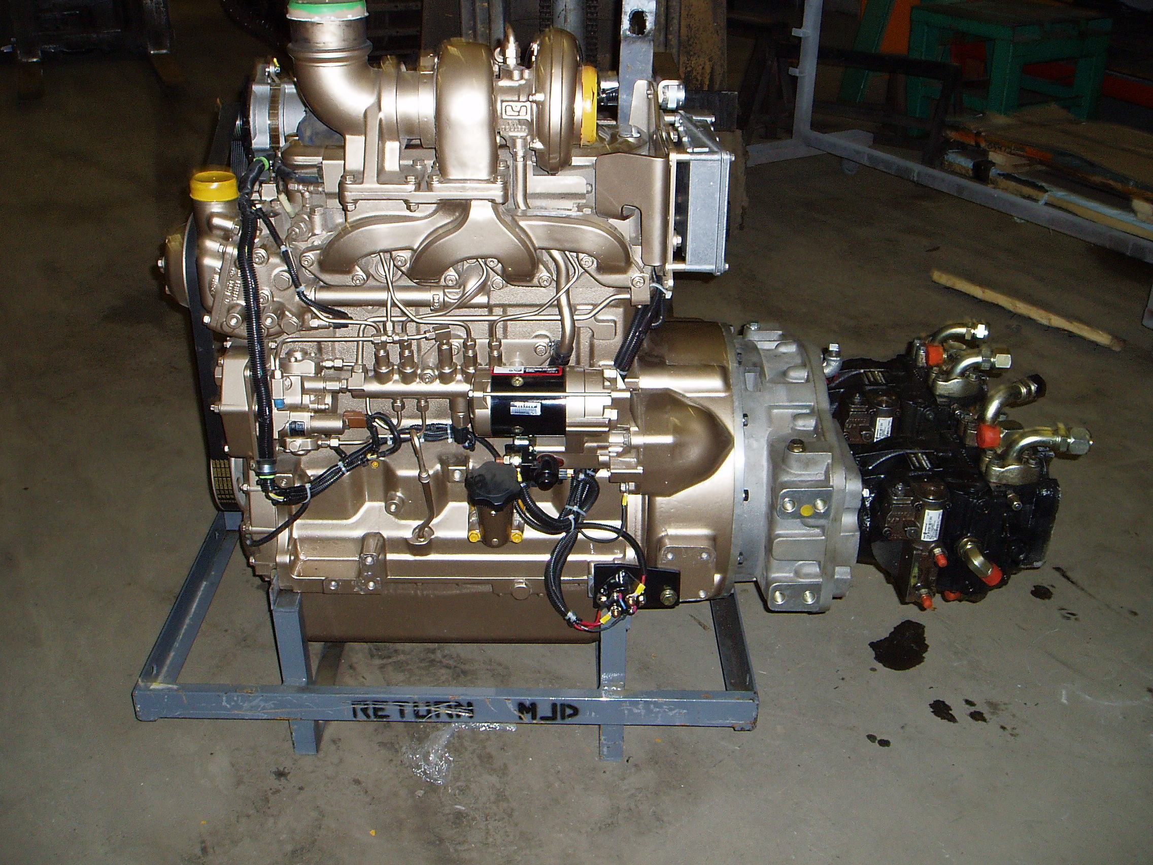

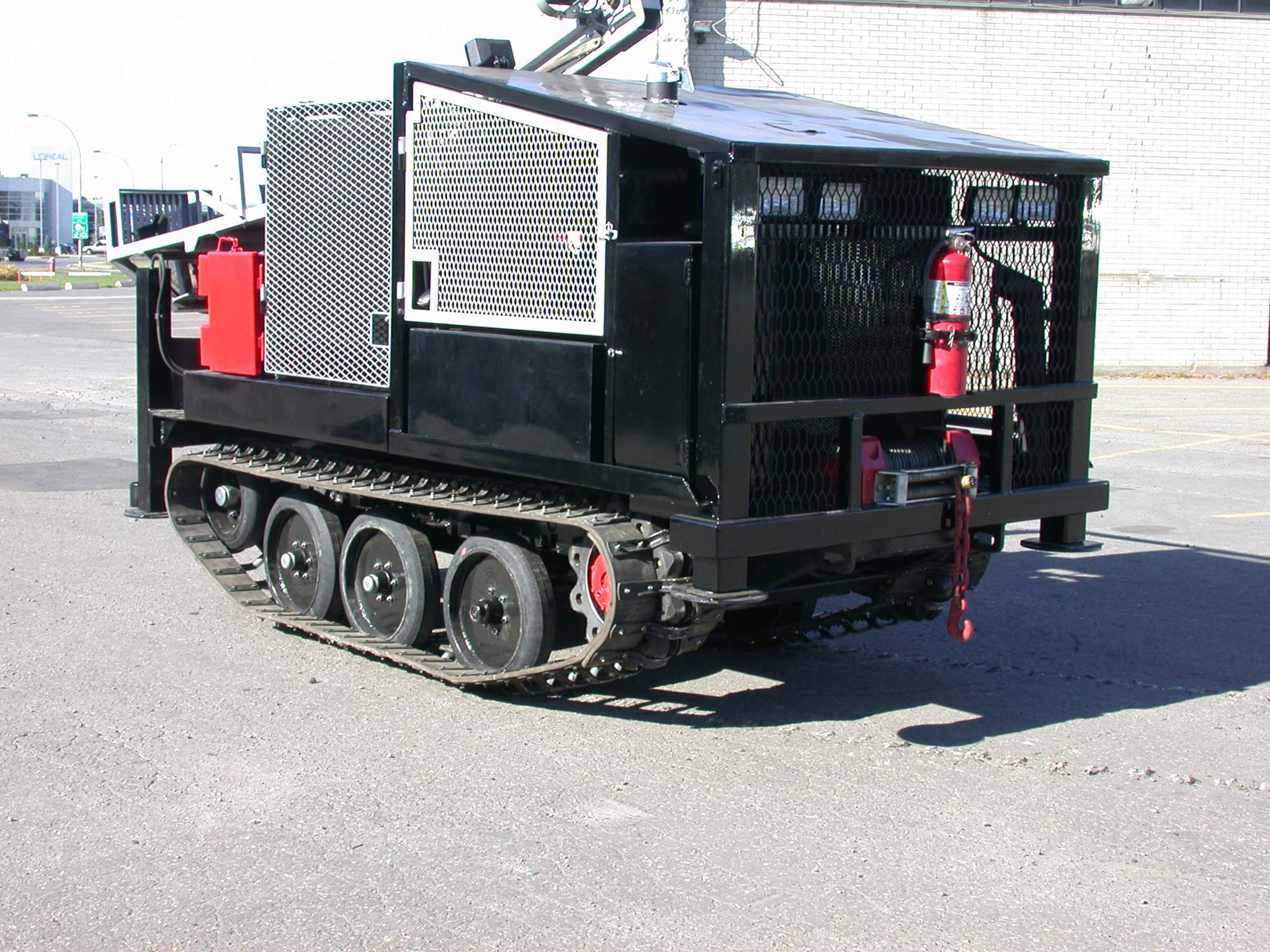

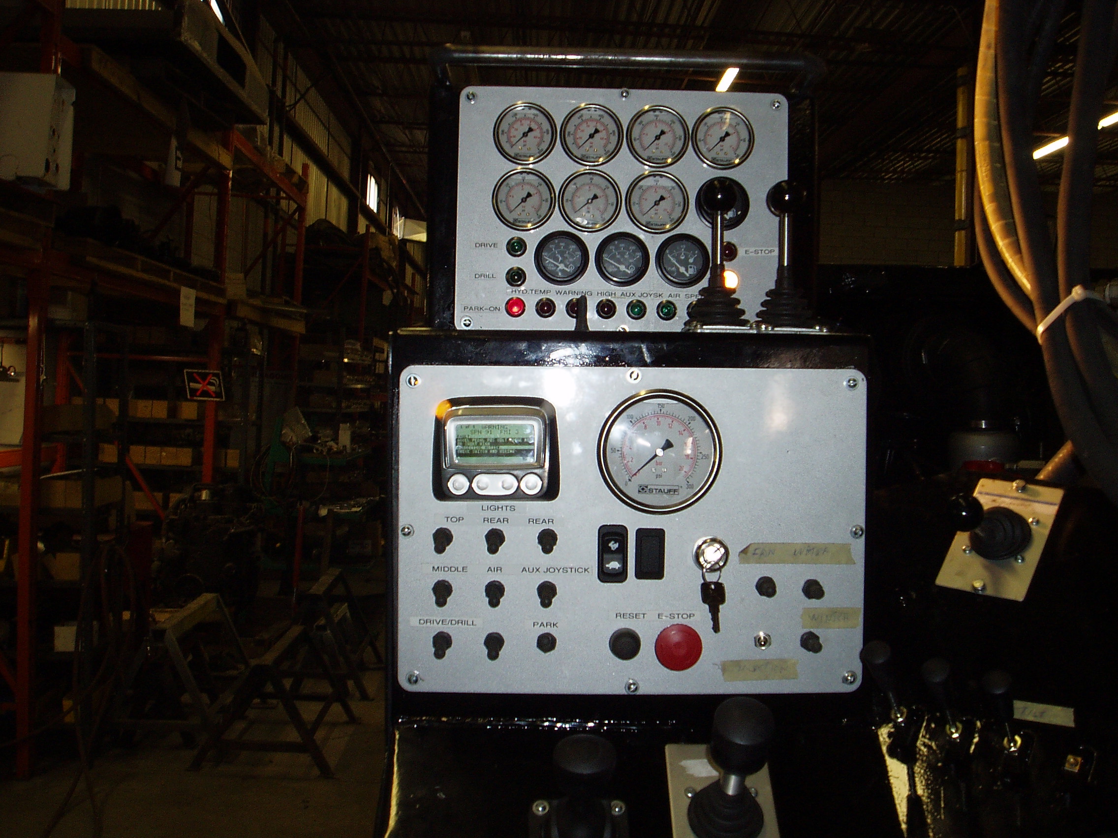

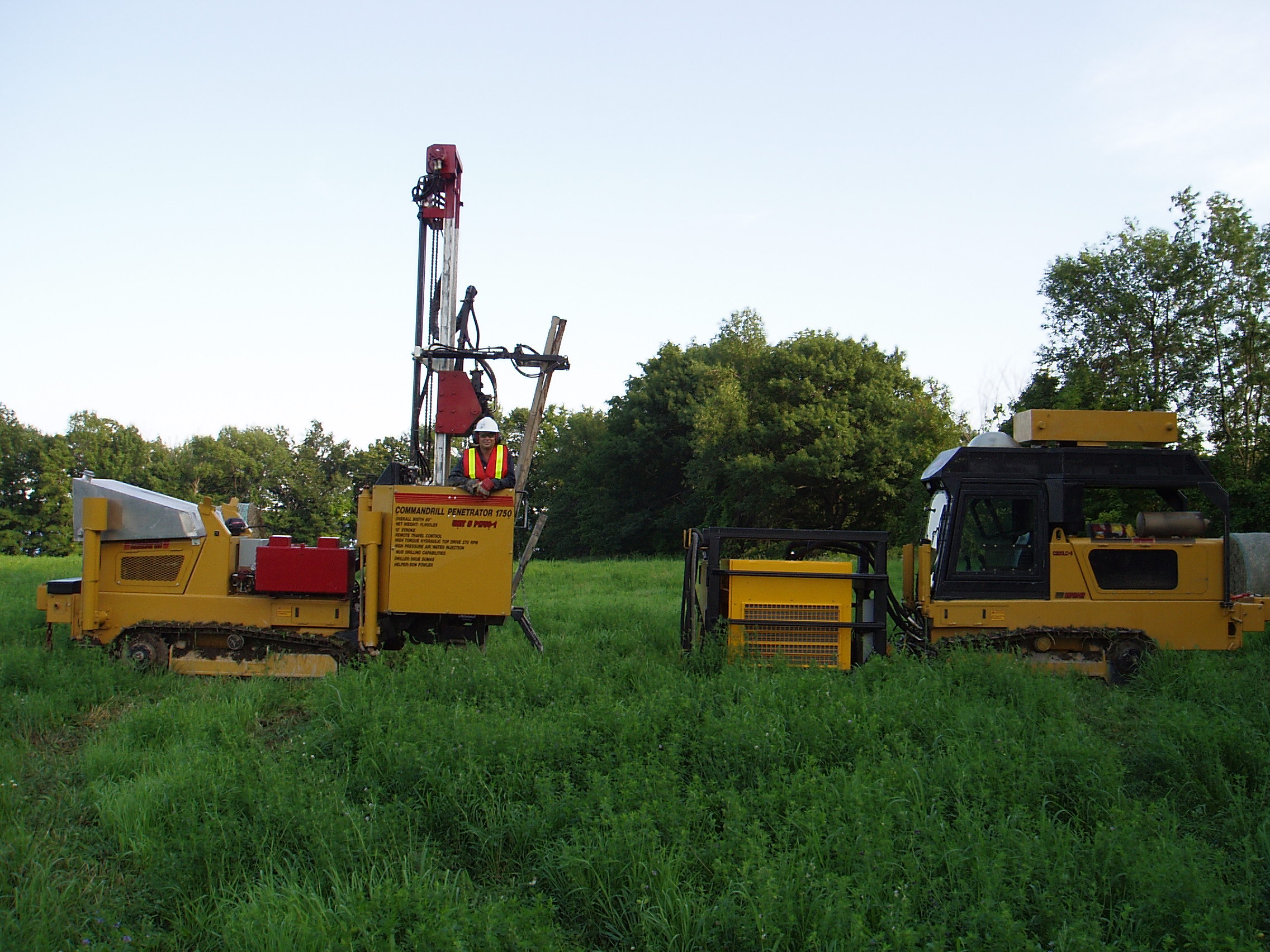

After proving we could cut 69 inch seismic lines I was asked to build a drill that could fit down them ! Rayco chassis to the rescue once again! I had to shoehorn in a 170hp JD 4045 and it fit nicely without extending the chassis. I first tried the 4045 for mulching but found it wasn't enough torque to mulch the density and size we work in. It turned out perfect for powering the little mini drill.

   / Looking to repower my rayco 140 #32
I like your creation. Do you have any problems with your departure angle on the mulcher when crossing ditches, etc?
   / Looking to repower my rayco 140 #33

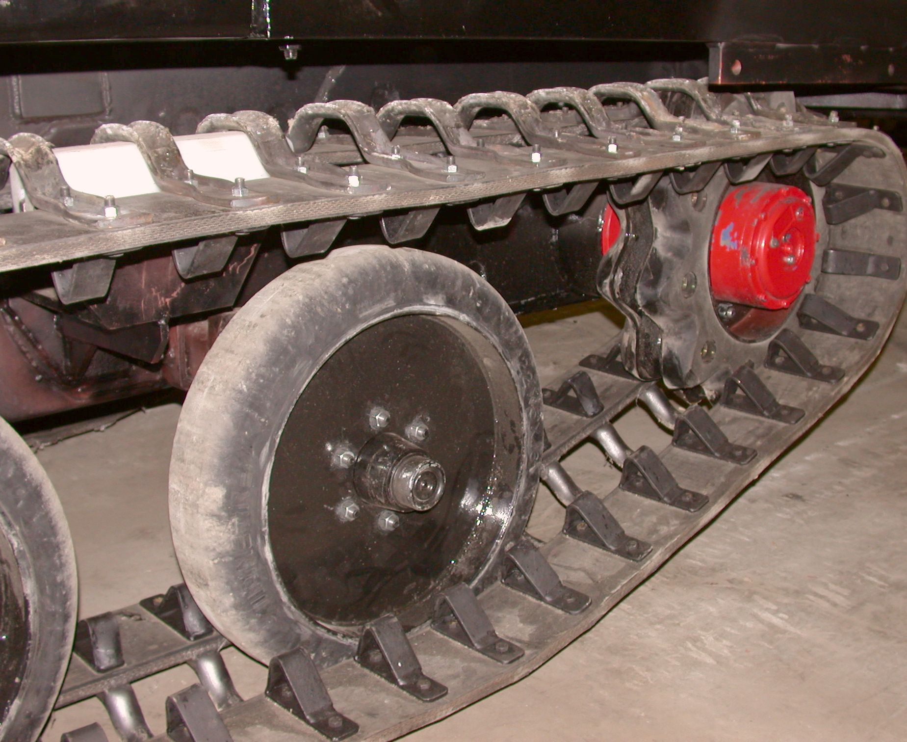

Actually it is not much of a problem. It looks like it would be a huge issue but we never have encountered a situation that affected our productivity. There is a formula that engineers use when designing an undercarriage. There is a lot of input required, however the distance between the center line of the tracks (track gauge) vs the track length, gross weight and grouser depth is critical to maneuverability.
The most critical dimension I needed to adhere to was the overall width. It could not exceed 69" or metric 1.75M. The whole purpose of this machine was to create a narrow mulcher that could punch through whatever we encountered without veering off course. The lines had to be cut where they were planned regardless of what was encountered.
Adding 18 inches to the track length would significantly reduce the turning ability of the machine without increasing the track gauge by 3".
I was concerned that the departure angle would be a huge compromise and was sure that the winch would have to go. Field testing proved otherwise and we were pleasantly surprised that the 18 " extension caused virtually no problems other then making a gouge in the ground on steep ditches. Even in these situations the operators would take it at a bit of an angle. The machine balance did not change at all either since we removed the counterweight steel blocks from inside the rear chassis.
I did build one 1.75 drill that ignored the length/width formula and it was a pain to turn because the tracks were too long in relation to the track gauge. We ended up relocating the drive and idler sprocket to reduce the length of ground contact. See Attached photos.

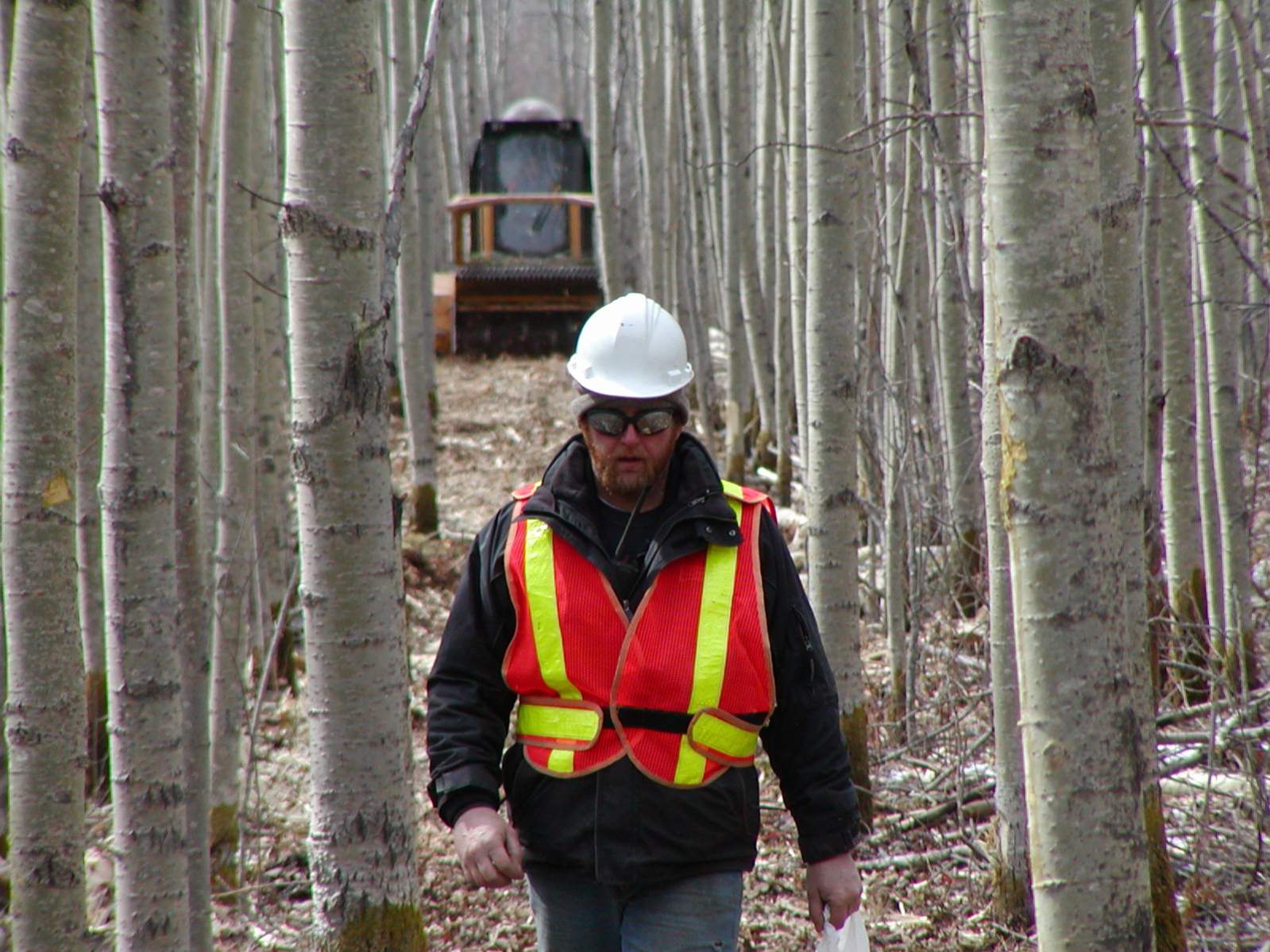

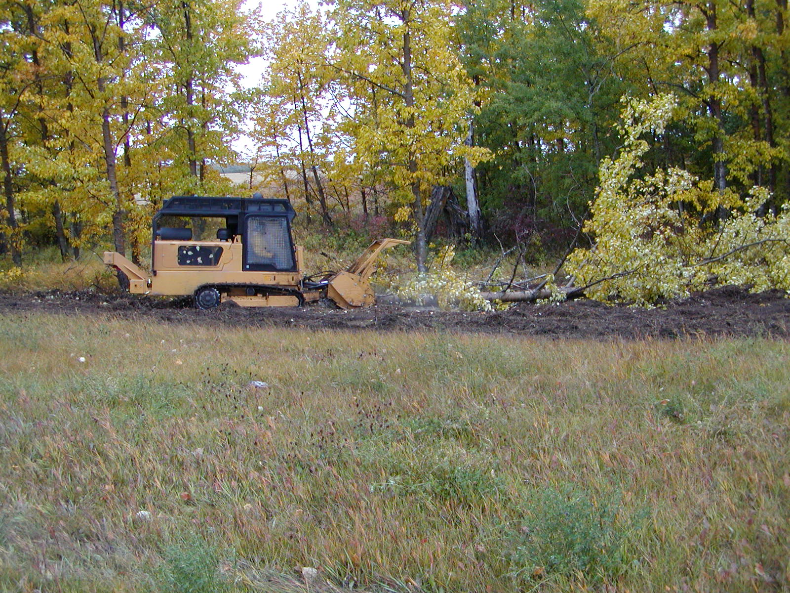

Are you talking about the mini mulcher or the drills? I don't have much of either unfortunately. I don't work at the company that owns the drills anymore however my exwife is the president there now. I have asked her to have someone shoot some video of the mini mulchers bringing down big timber. I will also ask her to get some video of the drills working.

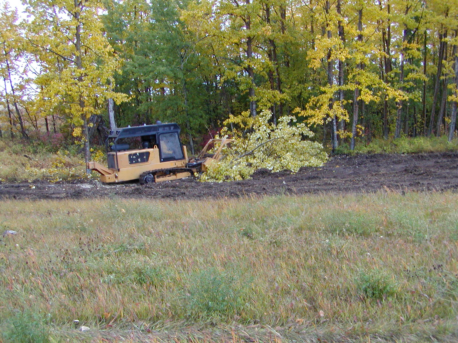

Here's some stills that may give you an idea of the capabilities of a 200hp compact mulcher.
The first picture shows the density we can quickly punch through with the mini mulcher. The trees are not that big (3" to 6") but the density is very relevant on line cutting jobs. We don't have the luxury of opening up a hole and dropping one tree at a time into the clearing. We have to fall and mulch them straight ahead without exceeding the width of the machine. This requires big power since you end up with 6 or 7 trees being mulched at the same time as you create the line.
The other pictures show a 20" tree being mulched and the metadata on the photos show these shots were all taken in the same minute.
I am now considering building a new prototype for use as a demo and take it on a tour around Canada and the USA. I will also shoot some video to show what these little guys can really do and then judge the feasibility of a doing a production run.
Cheers,
Rob

   / Looking to repower my rayco 140 #37
Adding more power is best accomplished by considering the bigger engine as part of an overall system upgrade. It is likely that your existing hydraulic pump does not have enough flow to remain below it's maximum working pressure rating. Likewise the hydraulic cooler(s) will have to be capable of shedding more heat. I did a john deere 4.5L 4cyl prototype and used a 100cc pump for the cutter wheel. If you have the 55cc pump in your existing FTX90 it will not be enough to transfer the extra torque from your 4bt. The 140 hp Rayco and Fecon machines would provide a good point of reference for component selection. Perhaps the guys that own them could offer their views on cooling performance, pressure settings etc. Basically what you want is for the hydraulic system to be capable of drawing down the engine below the rpm at which maximum torque is reached. If that occurs @ 1400 engine rpm then you set your multifunction valve to destroke the pump @ the pressure reached at this point. (and the relief valve 200psi beyong that).
If you leave in the little pump it will reach it's destroke pressure long before you are getting the torque benefit of your higher displacement engine. Also if you can keep the working pressures well below max it will help reduce the cooling requirements. The bigger the pump, the lower the pressure required to transfer torque.
